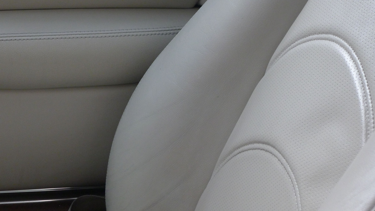

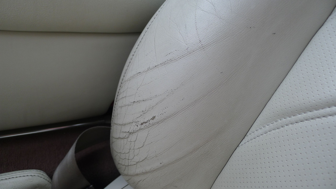

I have always done my own leather seats. I doubt that anyone has ever treated seats as bad as this Click Me to Read
But the good thing was that I could not make them any worse! So I gave them a go.
Since upgrading to my Jaguar XKR I have done my seats quite a few times now. As stated above Gliptone and Furniture Clinic do good products.
This is an early attempt at doing my seats. Not perfect but getting there!
I like to think my work has got better since then.
