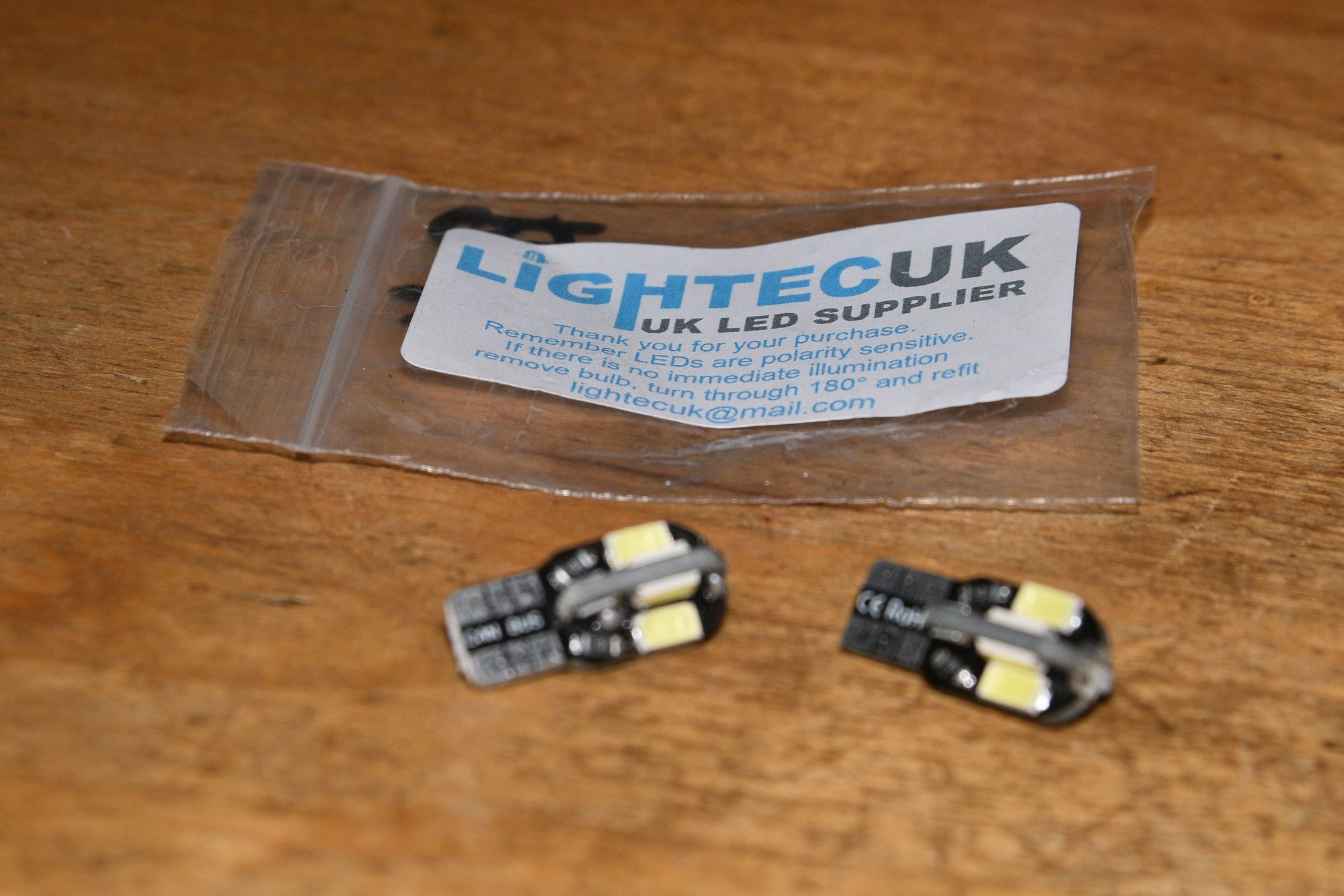

When I got my 97 XK8 I drove into an underground car park and could not read anything. I changed the bulbs but did not realize how rubbish it was until I put the LEDs in . WOW its like a 2022 car with an electronic dash even in the day. My message centre could not be read even though the bulb was good. The supply was bad so I soldered wires to it and piggy backed it with the others ..perfection.
TIP the smaller bulbs are a bit loose in the holders so I ran solder down the contact areas to beef them up. Buy LEDs with at least 3 leds to get it nice and bright ..the dimmer still works with the headlamps on.
Best to read this as you need the bulbs in the right way round..All the positives are at the bottom.

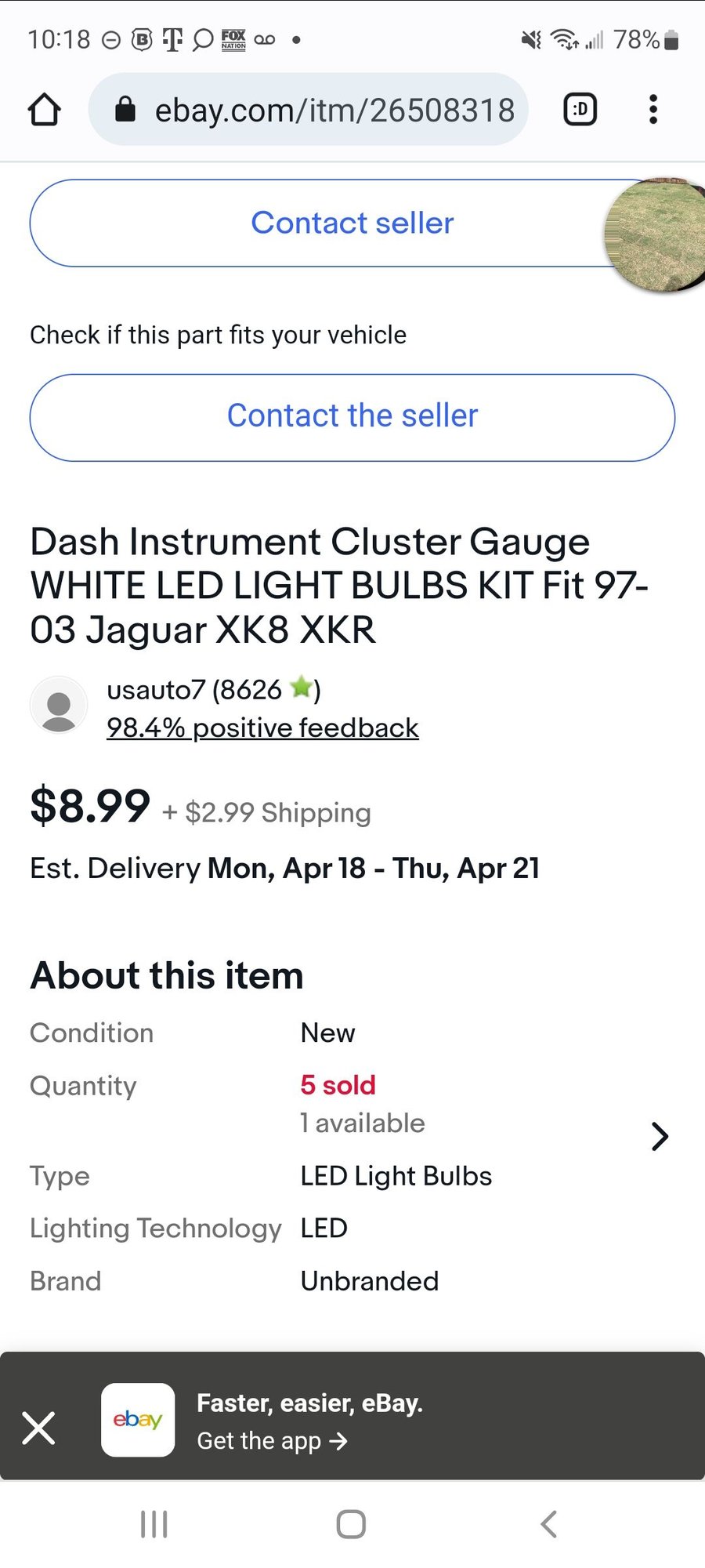

Try this link to the above
https://www.ebay.com/itm/265083184880

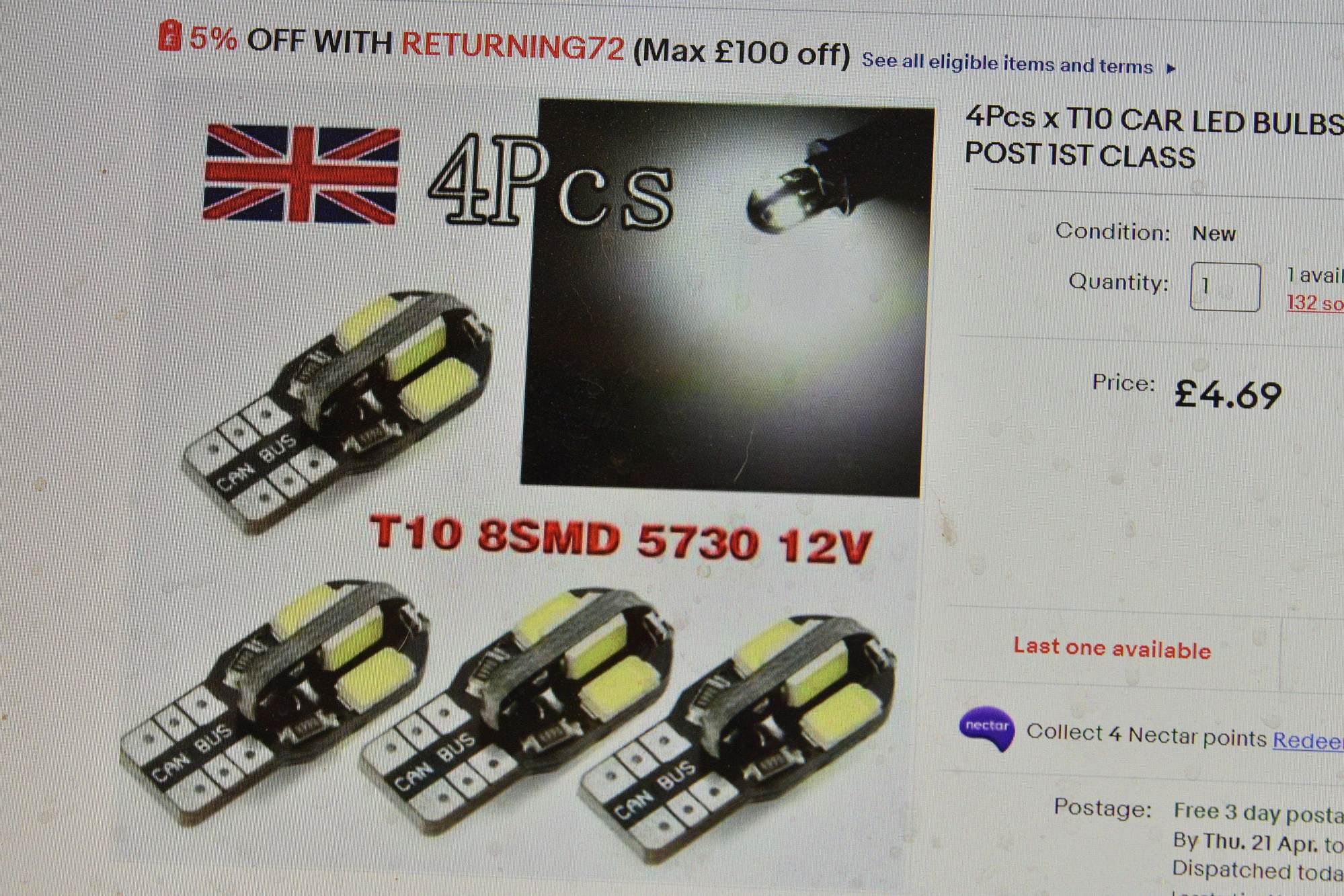

I used these 8 SMD T 10 units but as you are in US you will have to search the web .. In the end I did not fit the T5 ones as the were too loose in the holders and only work the warning lights which were bright enough. You would need to coat the bulb contacts with solder to thicken them up for a tight fit . I soldered wires to one T5 3 SMD and fitted it to the information display piggybacked to another T10 as the info display had no live feed.

These
