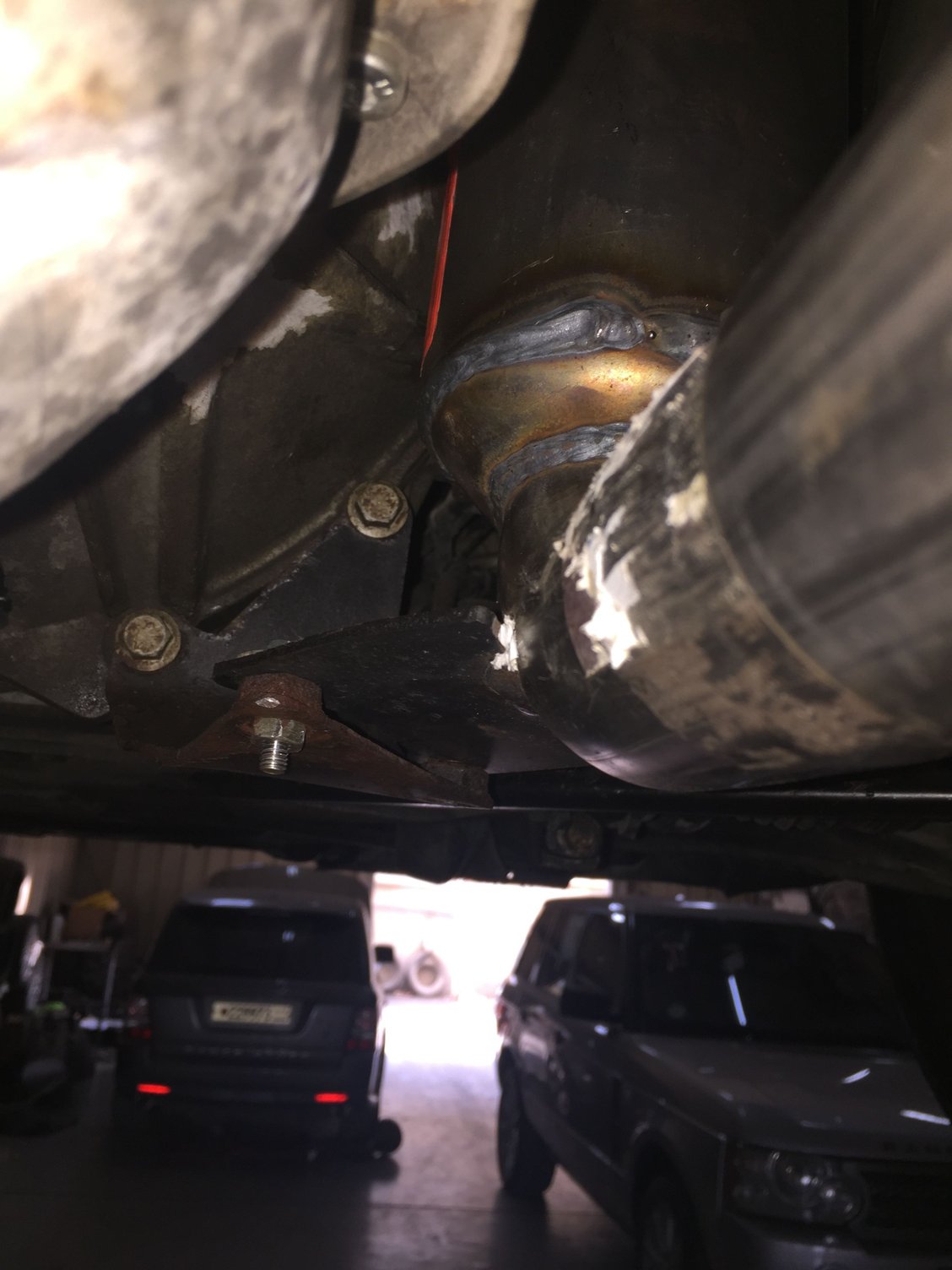

Here are some pics that might help you
it’s the vertical “can” with the shiney fresh welds in the pic. Held on by a bracket

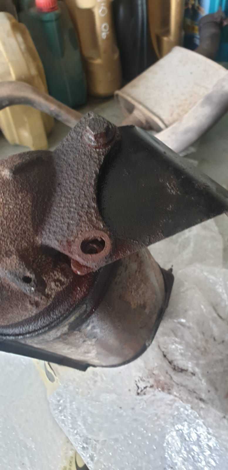

view of the old CAT and bracket out of the car

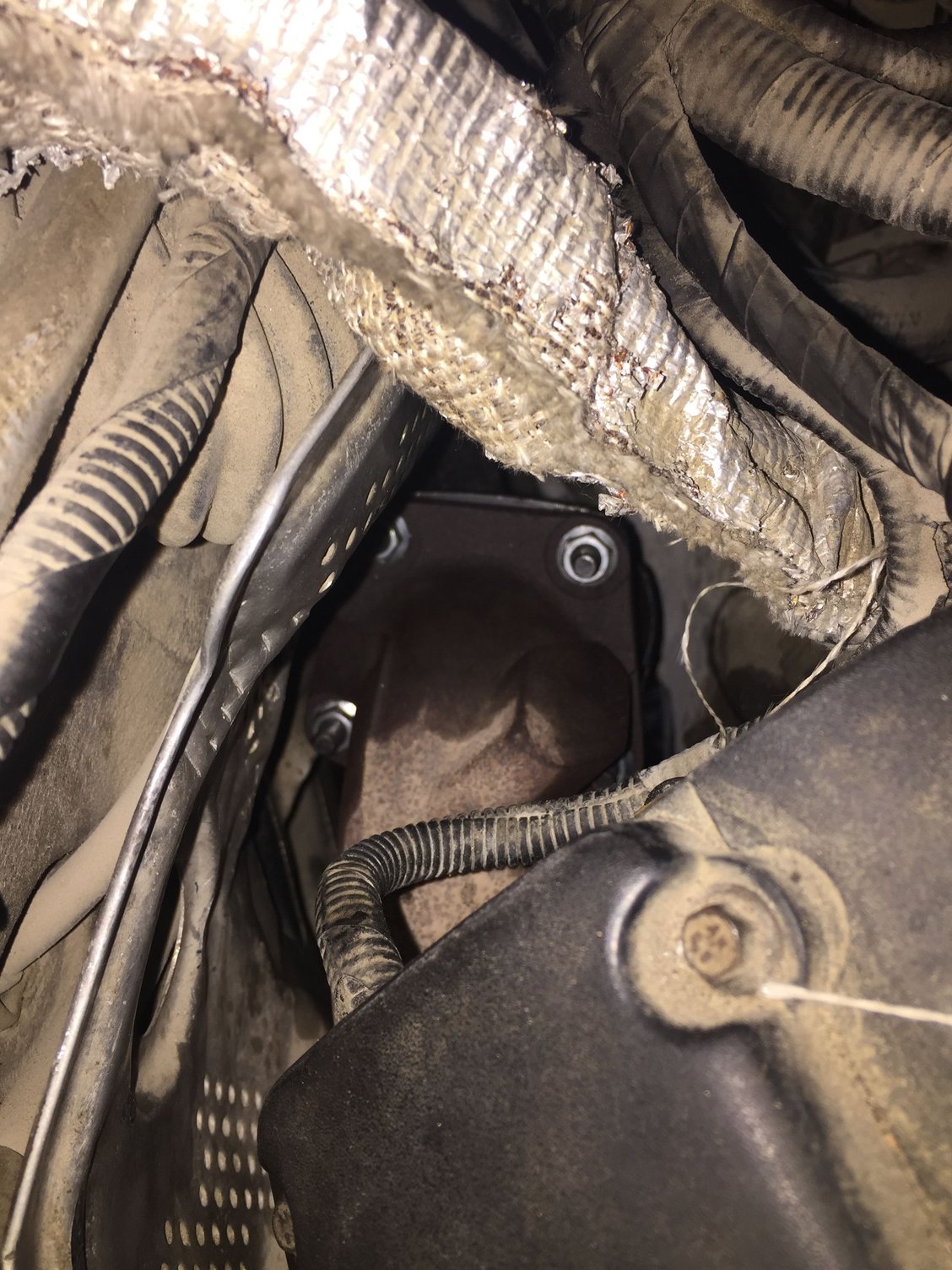

Top view from the engine bay. You’ll need to move the air tunnel and the coolant expansion tank out of the way to access nuts and bolts on top of the CAT.
Good luck. Hope it’s not the CATs as these are expensive parts.
