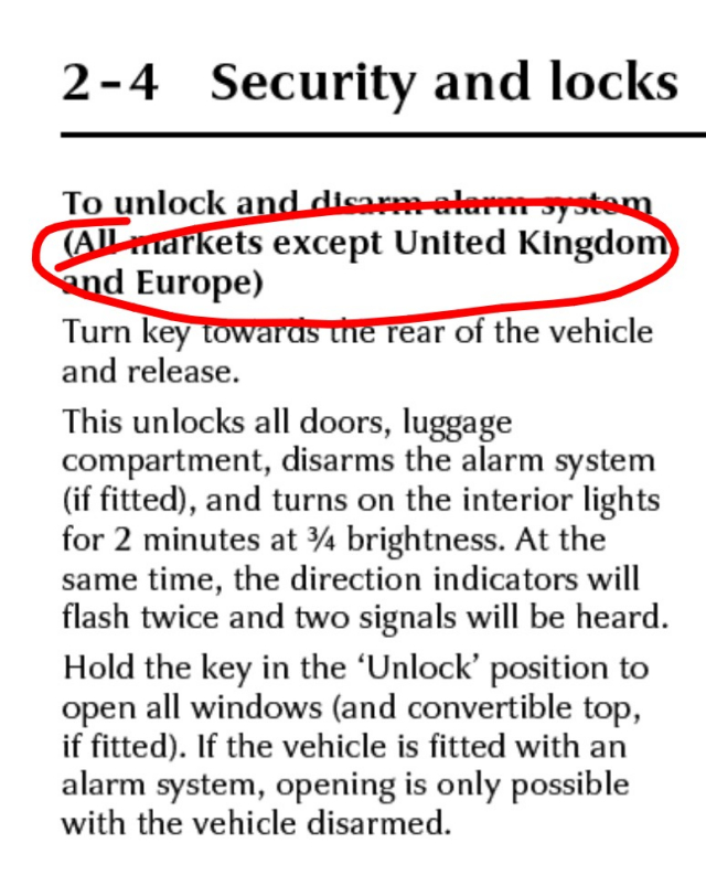

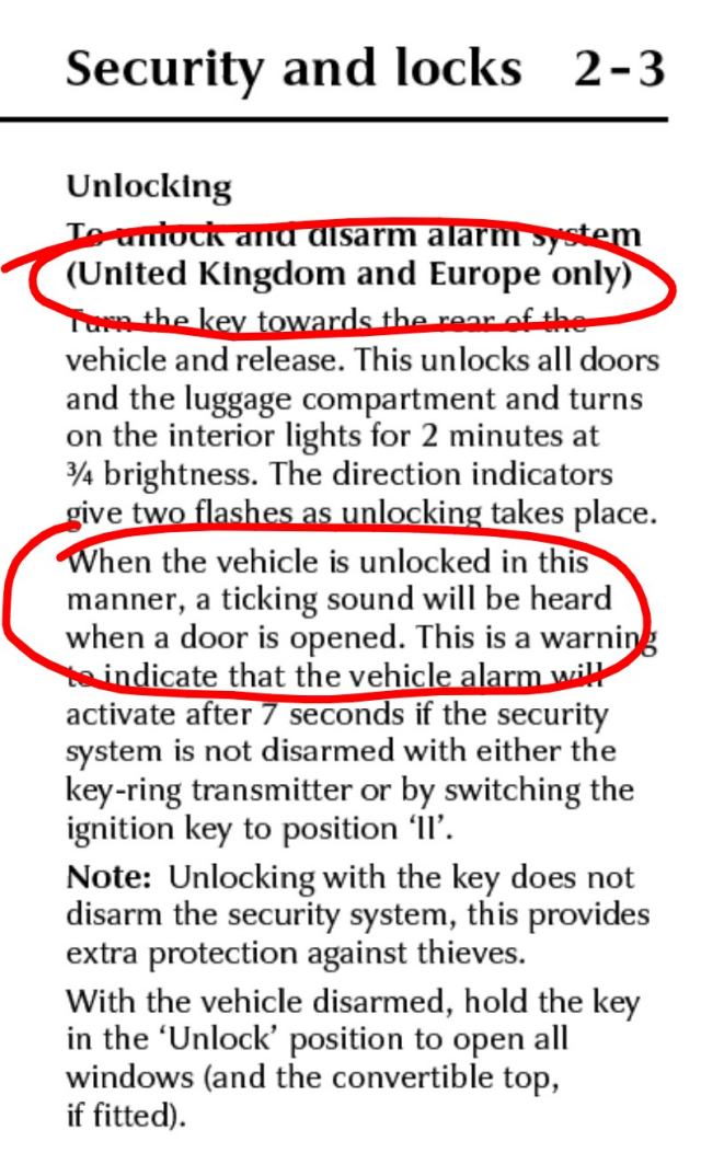

The only thing you can do is use IDS/SDD to turn off the need to disarm the alarm with the key in the ignition after you unlock the door. If you look in your driver's manual you will see the UK and US cars behave differently. In short you want the US version, which has the alarm turn off with the drivers door unlock.
ETA grabs from the drivers manual. It would be handy for one of our US members to confirm if this is the case:-
Old Feb 1, 2026 | 06:40 AM
zray's Avatar
Joined: Jan 2018
Posts: 3,751
Likes: 2,342
Originally Posted by dibbit
”……In short you want the US version, which has the alarm turn off with the drivers door unlock…..”
Yes, That’s exactly the way it works on my (USA) 2002 XKR.
