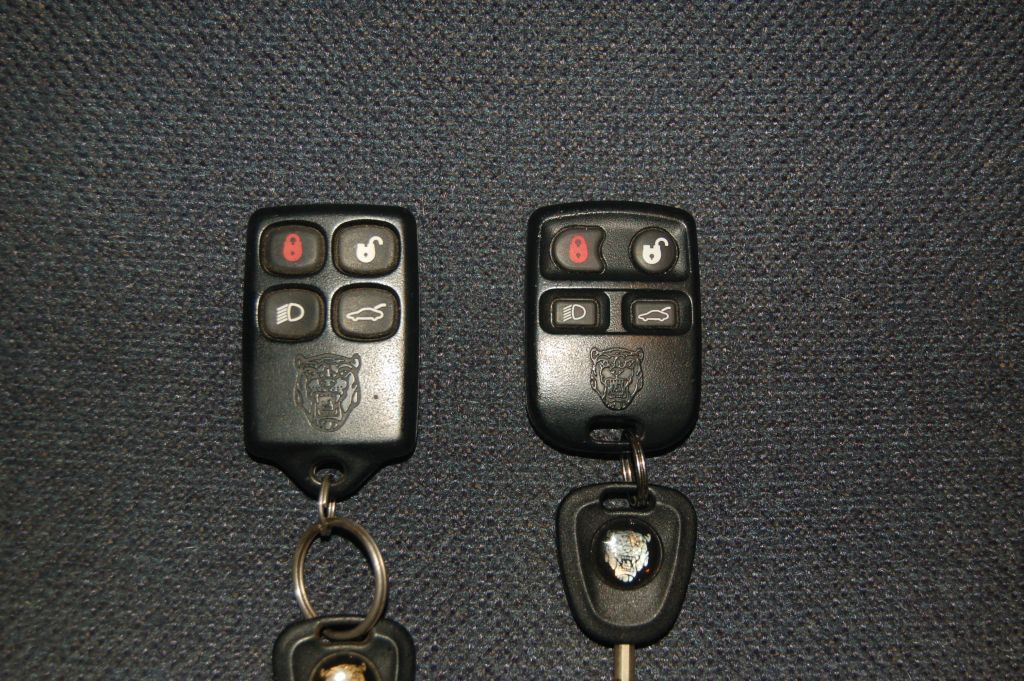

XJ/XK keyfob transmitters 'to 2000MY' on the left.
XJ/XK keyfob transmitters 'from 2001MY onward' on the right.
If you have the wrong one, it will NOT configure to the car.

My VIN is SAJJA42C5YNA03396. I have the rounded end fobs so the wrong ones? Mine are PN XR83-15K601-AA. The square shouldered are PN LJA2610AA. So are these the RIGHT ones?

TO VIN A11050 = LJA2610AA
FROM VIN A11051 = LJE2610AB superseded to LJE2610AC (rolling code)
You need the 'expensive hard-to-find' transmitters.
Interesting! I have put in an offer on a LJA2610AA. While I was at it, I looked at the Ford ones I bought. They are probably wrong too for the same reason. Hence, I searched again for an earlier Ford and found these (93-98 Mustang) - looks the same and Ford were using the parts bin. I wonder if anyone has tried them? 2 For 1993 1994 1995 1996 1997 1998 Ford Mustang Remote Keyless Entry Key Fob | eBay
