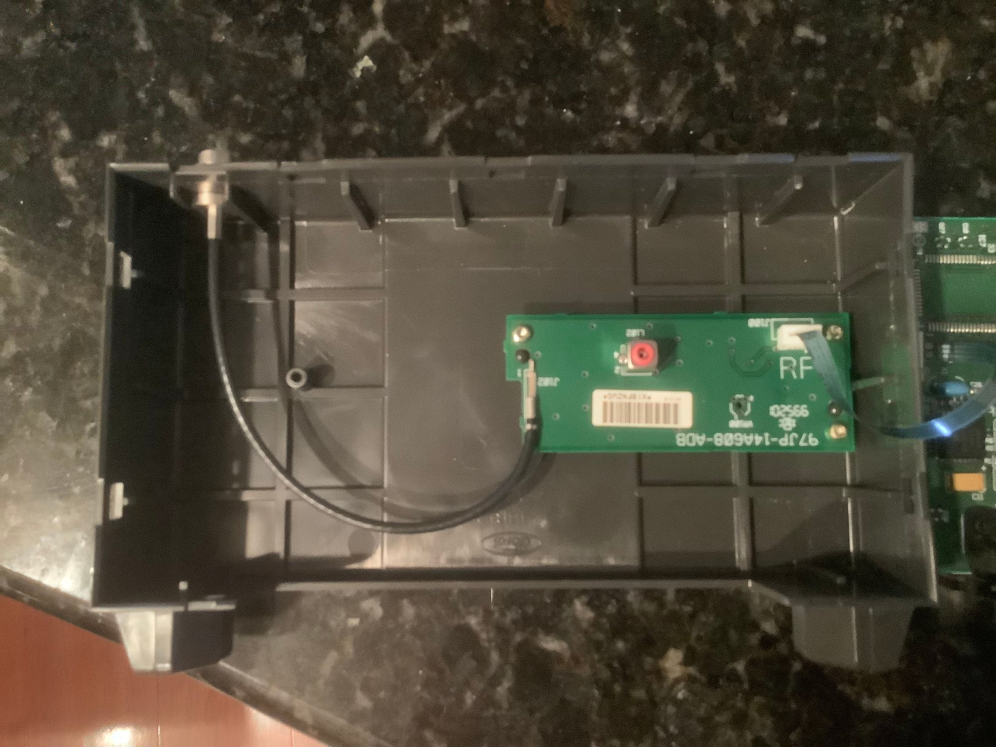

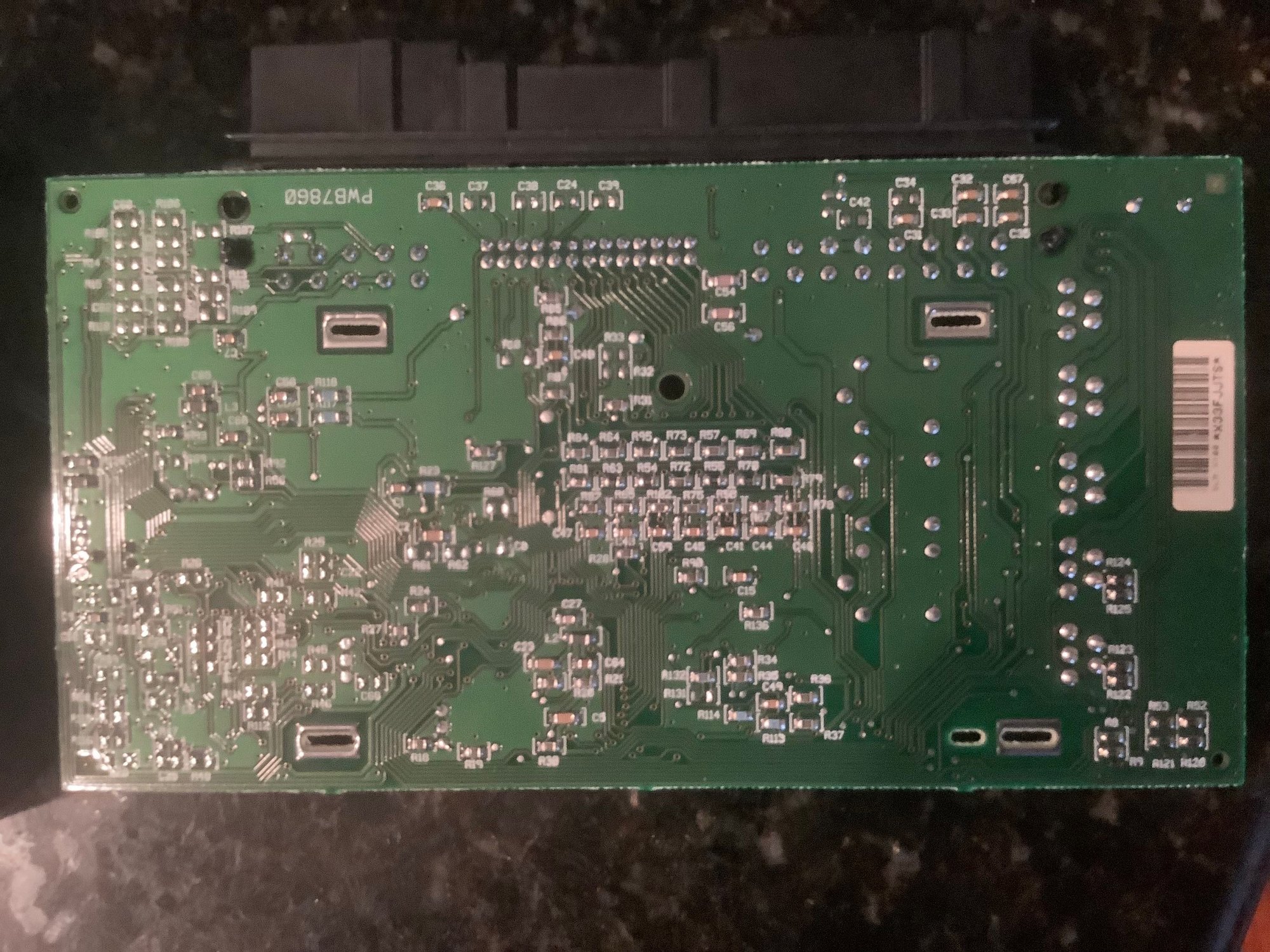

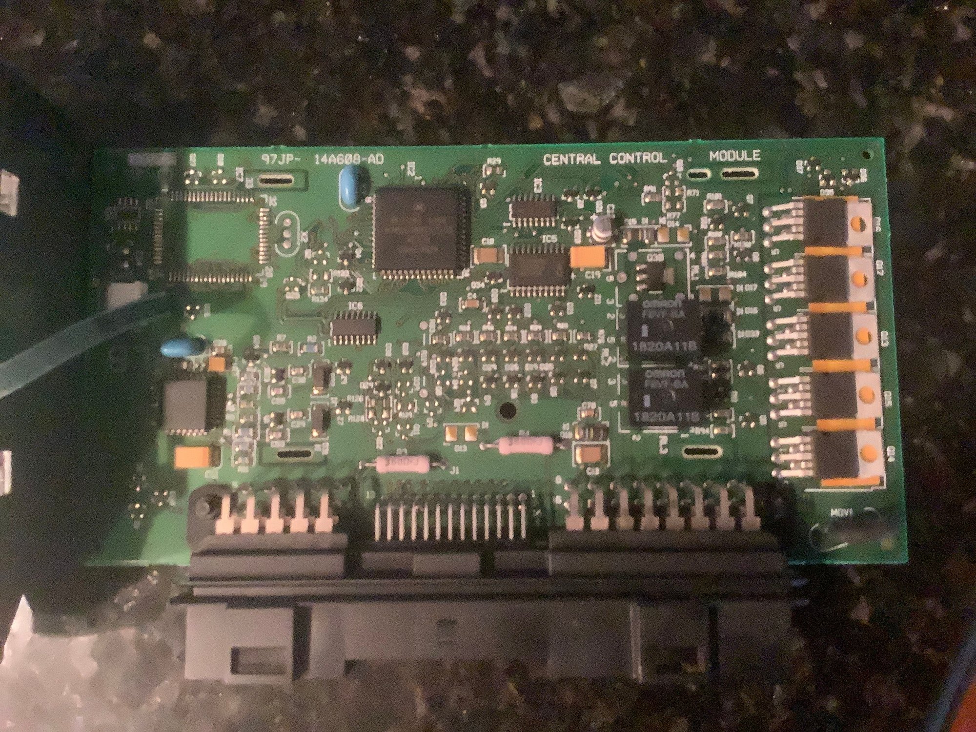

Repair or replace may depend on how damaged it is. If you can post a pic or two of the damage that may help. If you have to go the replacement route, you need to match the full part # (including the /nnn suffix) from your VCATS label, and it needs to be one from a convertible. Unfortunately, the s/h prices seem to be on a northward hike nowadays

I don’t see/recognize any damage BUT there is a distinct burn odor from the circuit board.

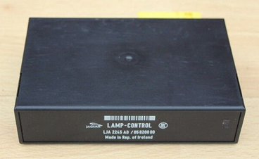

Nothing jumping out at me either. Strange. Could the burnt smell be coming from the lamp control module that cohabits the fusebox:?
I will check it out! If the lamp control module has a short, would that also cause the fuse at position 10 to burn out?
Highly unlikely. F10 is one of the two B+ feeds direct to the SLM, and nothing else. I was trying to confirm where the burning smell originated as there's nothing that I can see on the SLM pics you've posted where the magic smoke could have come from.
