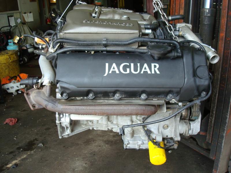

I went ahead and bought this motor:
I bought it off of eBay for $4900 which is more than I wanted to pay, but it only has 42,000 miles and is a 4.2 liter from a 2003 XKR. Good compression, running nicely (they say). The auto business that sold it has an excellent long term eBay rating with a return policy. It will be here in about a week or so.
I decided to not rebuild my 4.0 so that I could take advantage of the newer motor features and extra power. Wish me luck!
