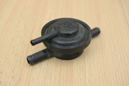

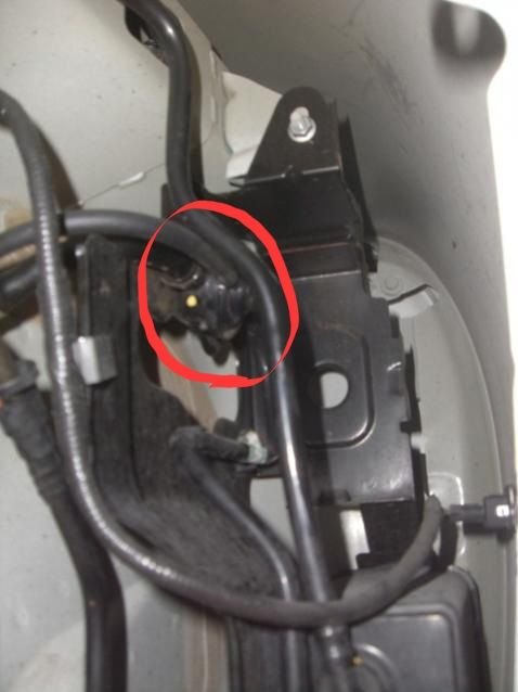

Originally Posted by Timeisrelative
So to hopefully put an update and end to this thread, i had done research and saw about the Rochester valve in the left fender, and had sprayed carb cleaner in it before to no avail. Well just recently I decided to look into it again and I saw about opening up the valve! I thought it was a factory sealed type thing, but lo and behold its not! I opened it up and the inside was full of silt basically. I cleaned it out and pulled the little valve out and there are 4 little holes under it. Yep, you guessed it, they were clogged too! Cleaned them out and put everything back together, and so far no more pressure building up in the tank! Wooohoooo!
Photos? Even if the are stock from the net,,, show us what you were looking at and where. I'm all kinds of curious!
Old Aug 18, 2022 | 05:03 PM
Timeisrelative's Avatar
Joined: Sep 2018
Posts: 792
Likes: 287
From: Pennsylvania
these are stock pics, they have it listed as "fuel tank pressure control valve" on the diagram earlier in the thread. To open it up you just use a small screwdriver or 2 and basically the top with the single nipple will come out. Inside there is a spring, a large diaphragm and under those is what seems to be the main problem. A small diaphragm that presses into a hole, and under it is 4 small holes. They get clogged and voila no pressure relief! Clean those out, pop it back together and done! Its really very easy once you do it.
Shweeet... Thanks for the photos and explanation... This will help folks!
I hate to ask but was it oil, dirt, both - just the regular grime that comes with a cars 'breathing' over a couple decades?
Hmm, there's nothing like car dirt!
Old Aug 20, 2022 | 03:22 AM
Joined: Sep 2018
Posts: 792
Likes: 287
From: Pennsylvania
It was basically silt type dirt, possibly micro rust,dust, dirt. Hard to say. Possibly even just a build up of evaporated gas particals that built up over the years. Either way, the hardest parts of it are the removal of the wheel liner, and getting the bracket out. Lol. Overall a pretty easy thing comparatively
