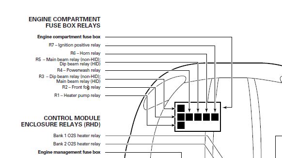

Hi guys, I know I don't venture into the XK8/R section too much,
but here goes...
The low beams on my 2003 XK8 are totally non-functional.
They don't work on "auto", "on", or from the button on the remote.
I have tested the headlamp fuses, and the 2 10amp fuses for the head-
lamps are not getting power. Both fuses are in good shape.
Should the connector that is below the fuse box be a culprit?
Thanks,
Ian

Remove the cover from the fusebox in the engine compartment (USA driver's side). Check that the relays are seated and have not worked loose. If all is OK, swap relay R3 and R5 and see if your low beams start to work and your high beams now do not.

thanks guys!
2 Bulbs and a fuse have fixed it. I guess one burned out, and
the energy surge blew the other one.
Solved!
