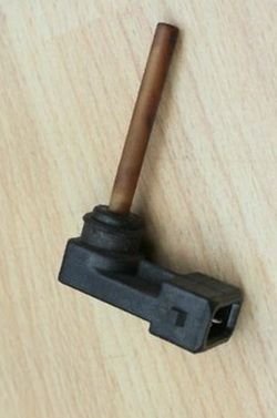

I suspect that the sensor in the small plastic fill/expansion tank is sticking. The sensor is built into the tank, so if it has gone wrong the whole tank is replaced. These are readily available and surprisingly inexpensive, at about 35 to 45 pounds sterling. Presumably there is a sensible way to test it? However, one not so subtle way could be to bang the tank when the light is on, and see if the light goes out.

Sam,
As I'm a fan of zero dollar fixes, first try putting a pencil magnet down the tank around the back and "hook" the float. Sometimes the float get gummed up and stuck. Then try cleaning the wiring connectors too. If that isn't the solution, then you're in the realm of getting a new tank & sensor. FWIW your comment on the warning coming/going (quote "stray electrons") could be due to a low battery charge at first start up in the morning as that normally gives me all sorts of weird messages.

Originally Posted by Diddion
..... The sensor is built into the tank, so if it has gone wrong the whole tank is replaced. .....
NO - the Fluid Level Sensor clips into a tube in the bottom of the Expansion Tank and is available separately as P/N LNA5740AB (see item 4):
A new Expansion Tank comes complete with Sensor and Pressure Cap.
Thanks for the correction, Graham. - I wasn’t aware of the sensor being available separately. But that does assume you still have a tank to fit it to!
..... that does assume you still have a tank to fit it to!
Absolutely!
I had 1 sensor fail but 2 tanks fail on my XK8's. One of the tanks had a split seam and the other developed "pinholing" in the base leading to mysterious coolant smell from a hot engine with little apparent loss. Pleased to find the later XK's rarely have tank issues.
