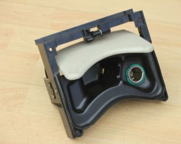

If cleaning the centre nub, from the top, doesn't work, you may need to check connections underneath. The cigarette/ashtray compartment is a complete unit bolted onto the centre console.
It's been a while since I removed the centre console of my ex-XK8, but as Rev Sam showed it's a simple job to remove it. then you got access to the cigarette lighter. I actually had to replace it, using the cigarette lighter from my scrap donor car and I remember it was a b@#tard! to get out due to the push green lit ring. I had to enlarge the hole in the end to get the replacement in/out. From my bucket of stuff, I found these 12V cigarette lights come in different lengths, and of course Jag uses a hard to find short one. As it heats up (obbviously), make sure none of the carpet is tucked underneath it (fire hazard).
I neeeeever knew!

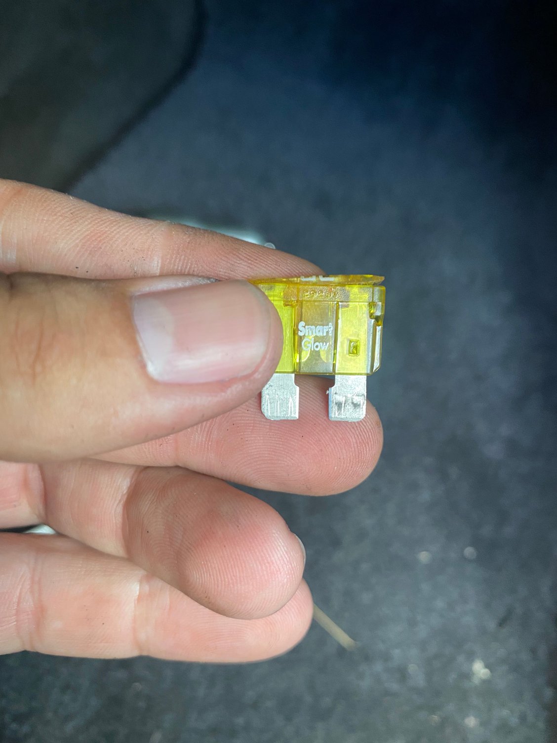

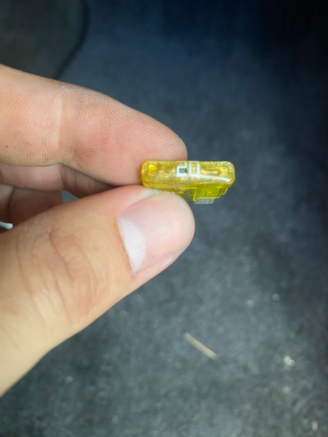

After scraping the ever living hell out of that socket, I decided to check the fuse. To my surprise, what was in there was just the weirdest looking 20 amp fuse which happened to be blown.
I replaced it with a proper 20 amp spare fuse and tried my air compressor and it worked. My iPhone charger is also working properly.

Now, where did that Weird looking 20 AMP fuse come from?

My guess it was the P.O. It was labeled “Smart Glow”.

Smart Glow "makes it a little easier to diagnose electrical problems".
hehe - some of them, perhaps. Explains the odd continuity:

I suspected this, but the LED definitely wasn’t working anymore.

I know this was the previous owner's fuse, but a word of advice: Only use standard brand name (Bussmann or Littelfuse) automotive fuses. Fuses that are gimmicky or imported from China like Harbor Freight fuses are asking for trouble.
