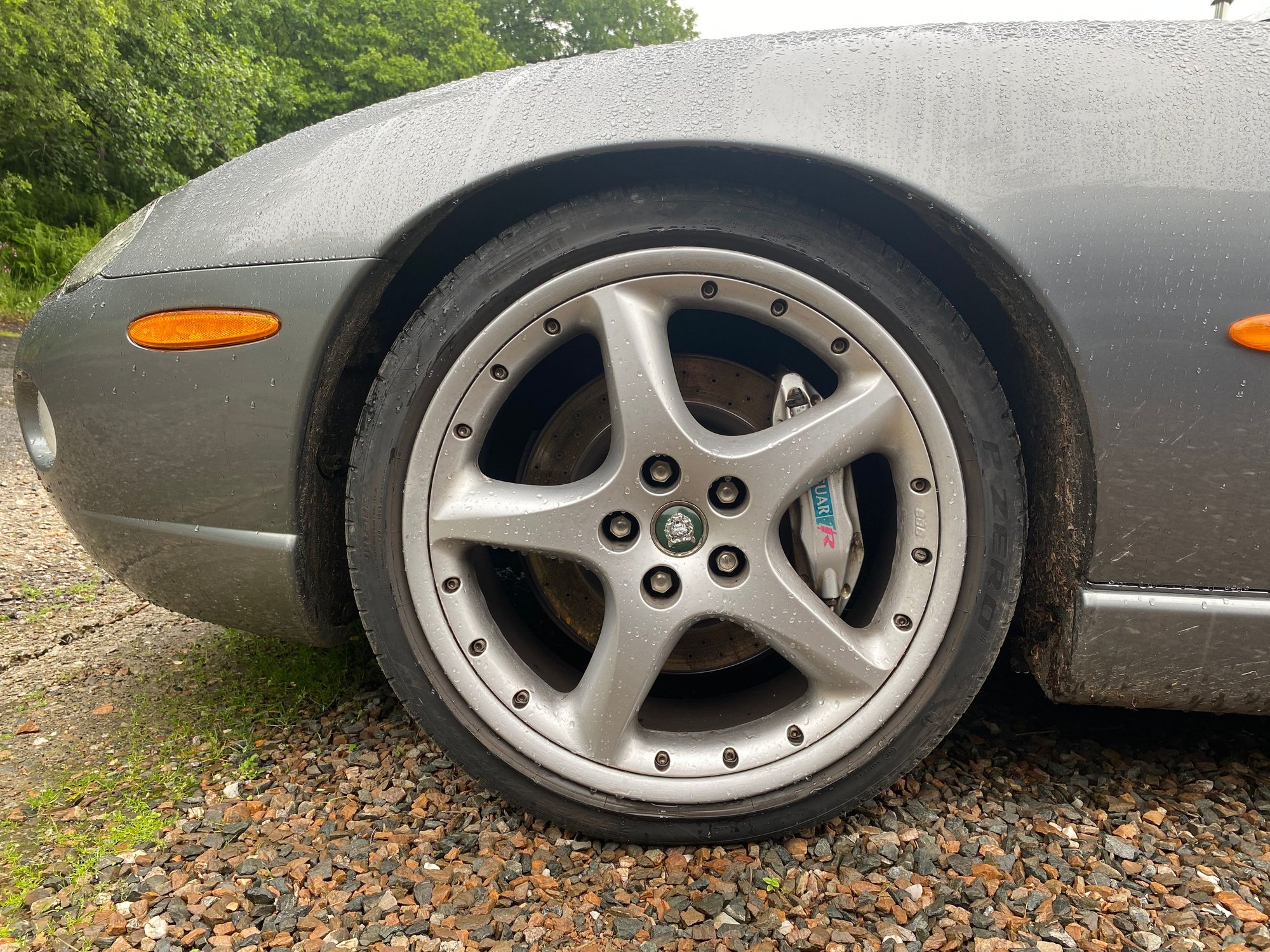

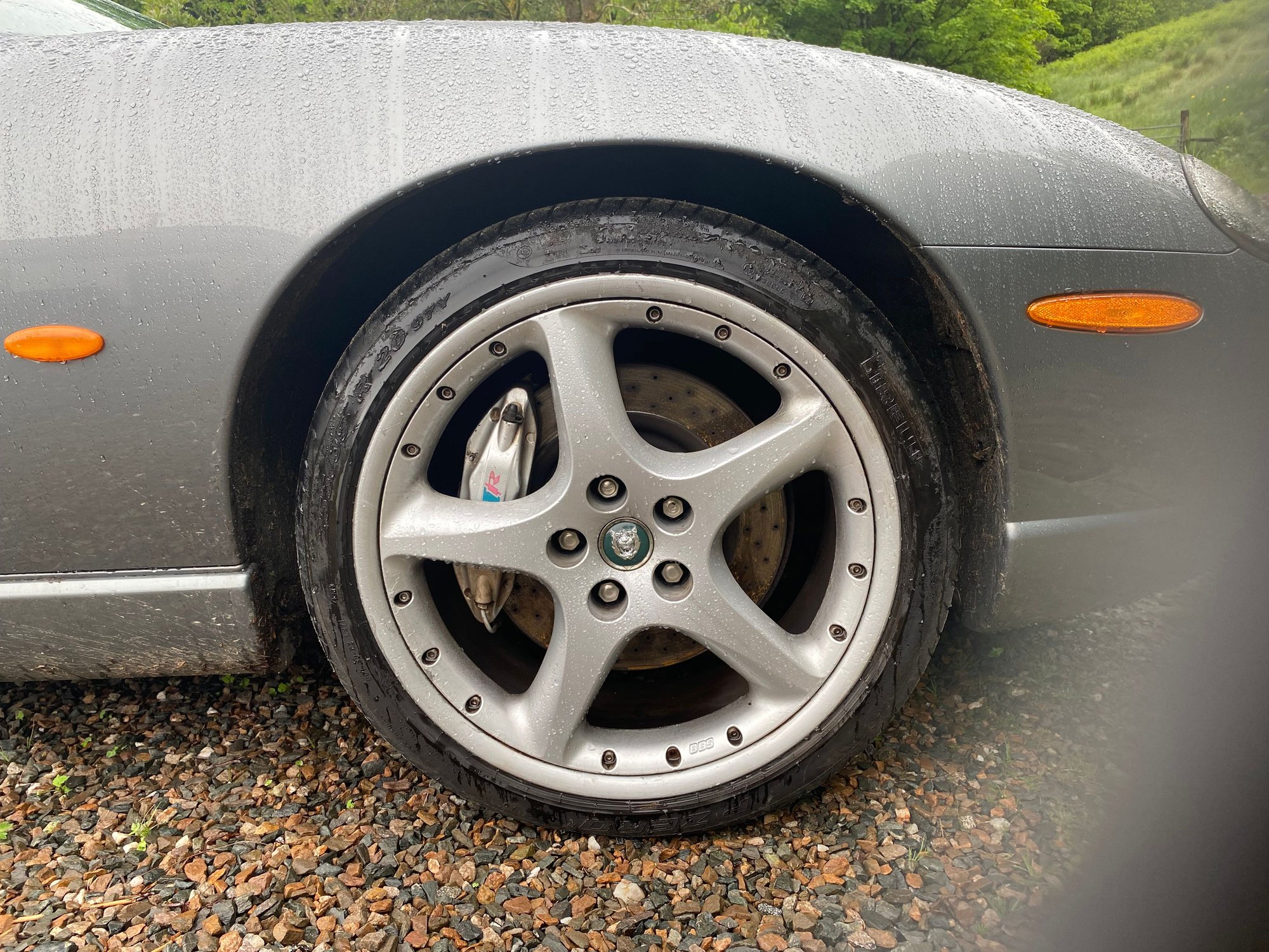

Just noticed my XKR x100 n/s front end is low. There is zero height difference between the top of the 20” wheel tyre and the top of the wheel arch, while the other corners all have a ~1.5inch clearance, see pics.
There are no reported faults on the DSC and Icarsoft adaptive damping shows ‘pass’. Recently passed mot at local Jag specialist!
Thoughts please?

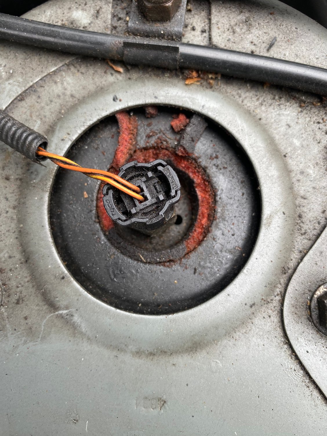

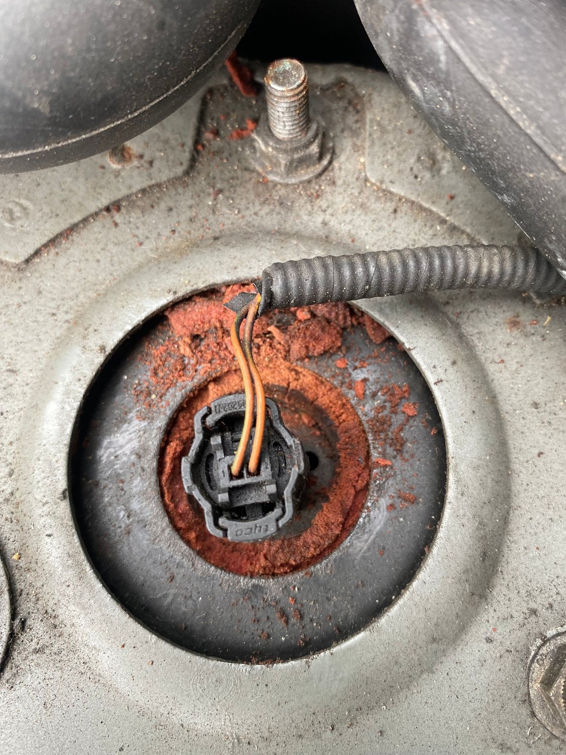

Check top mounts, spring isolator at top of spring in wheel well and top damper mount bushes inside mount visible from engine bay.
Look for collapse and crumbs.
Plenty of forum threads regarding improved mount rebuild kits and substandard aftermarket mounts.

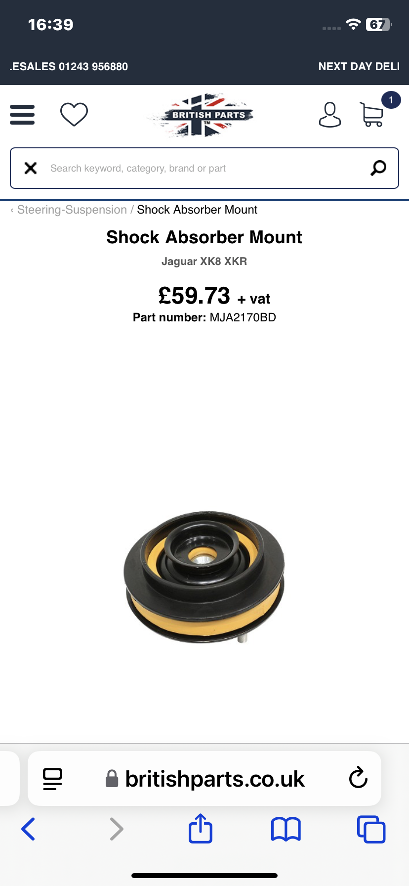

Almost too much info on threads. Upper mounts appear to be my starting point, with pic 3 being suggested replacement?

Short term fix, yes
Long term, search Wayne's mounts or Baxtor's.

don't buy those or you will be replacing within a year. Reach out to @cjd777 (Wayne) or @baxtor (Steve) as they have worked to develop a much more robust solution

Contact baxtor in Australia he sends to England all the time.

Baxter mounts ordered. Thanks all.
