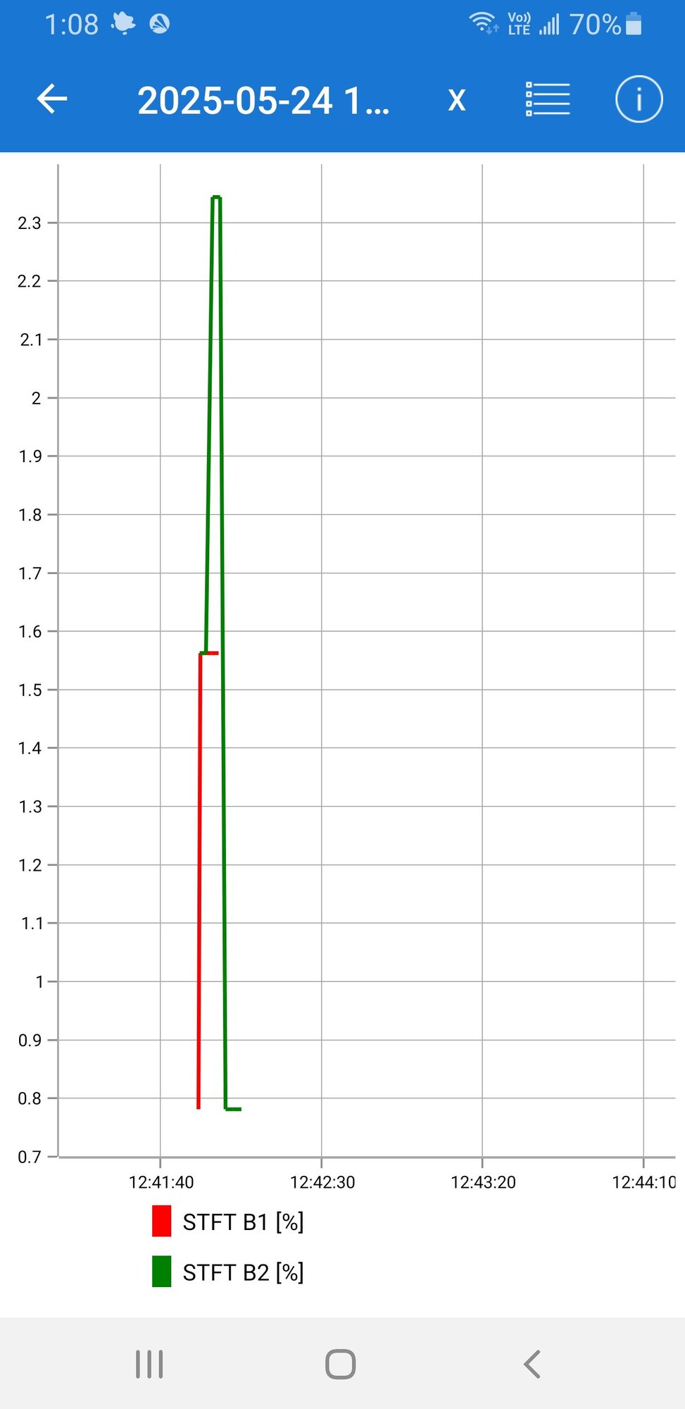

Thanks folks. I appreciate the feedback. Still no codes from car scanner with my elm327mini. Now thinking you might be right re the air leak. I've tried to attach a graph showing the STFT's showing what happened when I fed it the gas from about 3500rpm in 2nd. A few years ago I replaced the gaskets on the end of the supercharger elbow (hat) the bit with V8 stamped in it. One of the 3x bolts that holds the double barrel gasket in place was fairly stripped (not by me). Wondering now if that gasket is deforming/leaking under pressure of high revs and boost...? Anyone have any thoughts? Also can anyone read anything into the graph attached? I had the scanner on record so can supply other data if it helps. Thanks Jeff.

These fuel trims look super small. You might want to try and graph the long term trims as well, if possible. Trims are a function of load and rpm. See if you can capture the trims for different loads and rpms, and try to graph the trims as the elevation on a map of load and rpm.
