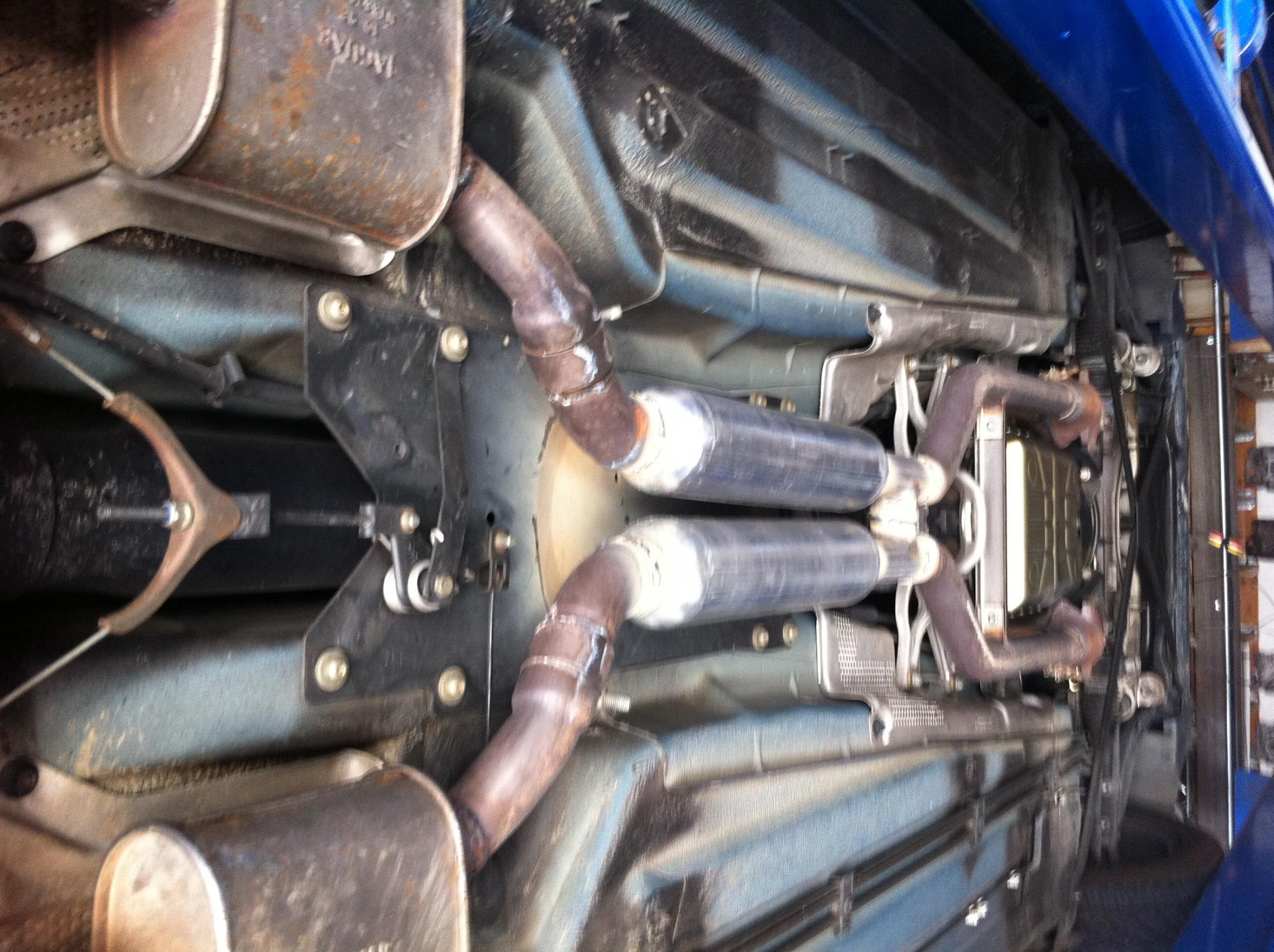

Before and after pictures.
Before with the center muffler deleted and a crossover
After with 2 glasspacks and a very short (X) crossover

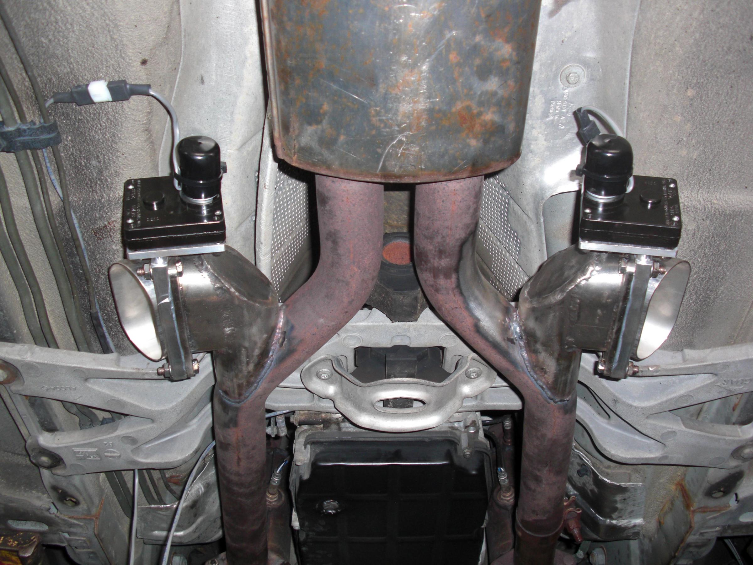

Electric cut outs are the way to go!
Quiet when you want them to be and race car loud fully open and any setting in between.
This is the best mod I have ever done to any car I have ever owned!
On my XJR below.
Vector
On my XJR below.
Vector
Very Nice!
Any chance you can elaborate on your setup? In the picture I can see the (what seems) OEM mid-muffler. Did you remove any mufflers? Any chance you can post some audio of various settings - perhaps, start with the most extreme, followed by mid-level and the quietest level in the end? Also, how to you control the settings?

I have a hidden switch where the ash tray used to be.
I ordered low profile, oval electric exhaust cut outs from Dave at DMH. $399 shipped. They have a 4 year warranty.
It has been a year and a half and they still work and seal great.
I decided that a video of this mod would be useless, you can make them sound however you want.
Here are a few of my threads on the mod:
https://www.jaguarforums.com/forum/x...ut-outs-68743/
https://www.jaguarforums.com/forum/x...ll-pics-72079/
Direct link to pics of the entire job. The pics are not in chronological order here so you will have to use your imagination as to which stage of the job we are on.
Jaguar Photos by itsjustmerick | Photobucket
Vector
