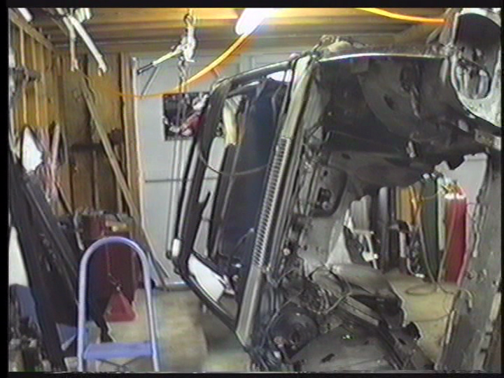

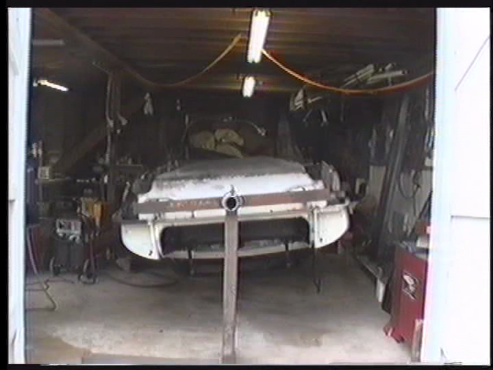

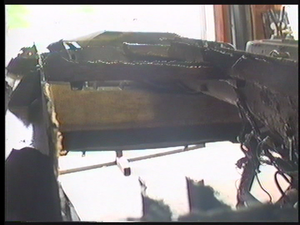

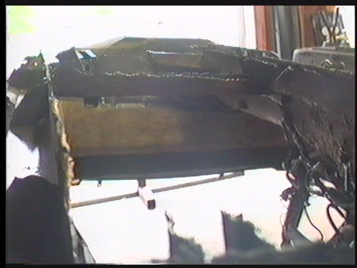

Old Nov 30, 2017 | 07:45 PM
  #68
ronbros's Avatar
Joined: Jul 2010
Posts: 7,362
Likes: 1,241
1978 XJS no floor all rust, replaced the complete under body of car.
pic of body upside down,, makes fitting and welding much easier!
