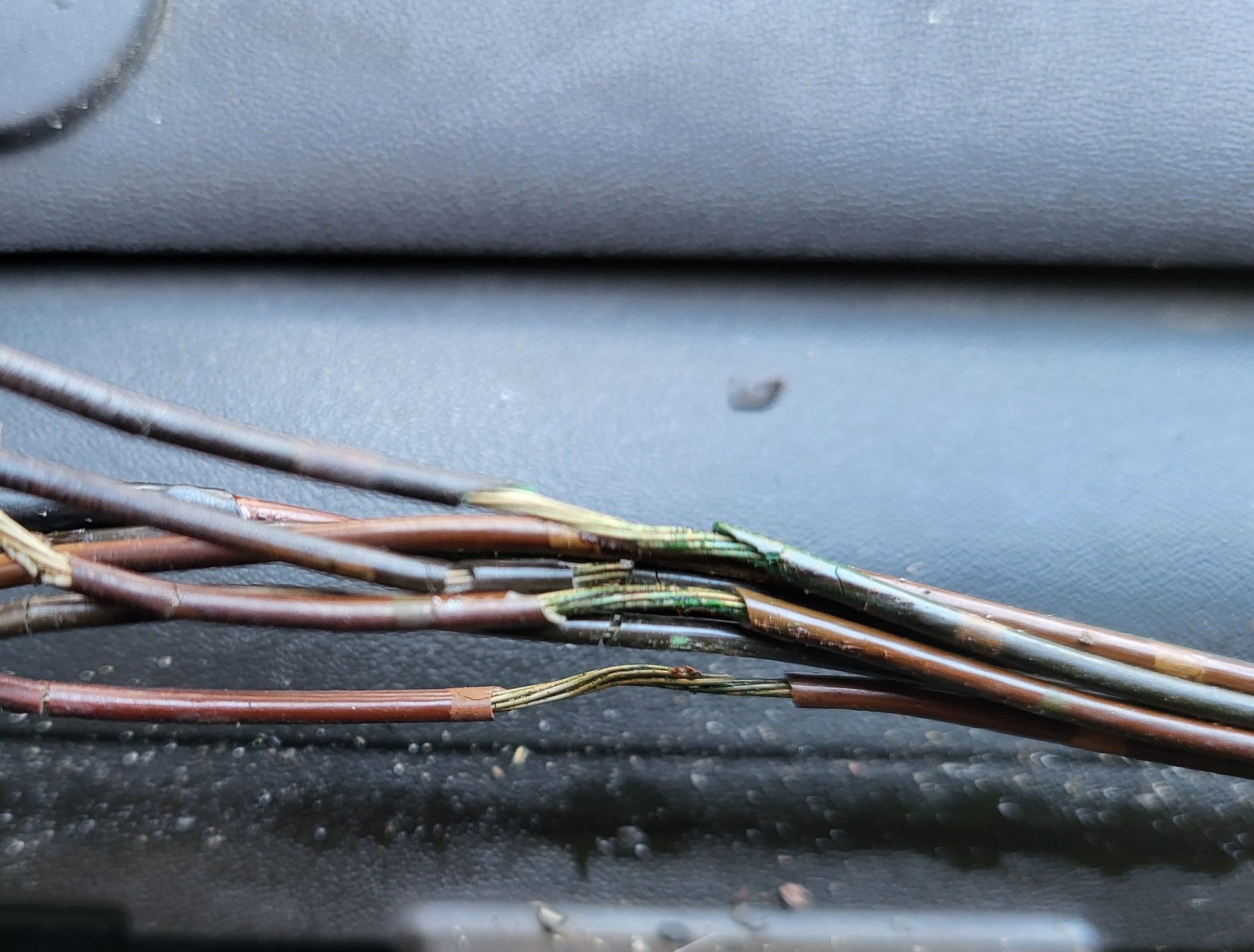

It could be a wiring problem.. Check the cable harnesses, especially the one that goes to the coils on the passenger side (for LHD cars). Sometimes it wears against the cylinder head and causes a short circuit to ground.
true and have had to wrap some of the wiring on the drivers side harness due to insulation becoming brittle and flaking off. always good to double check.

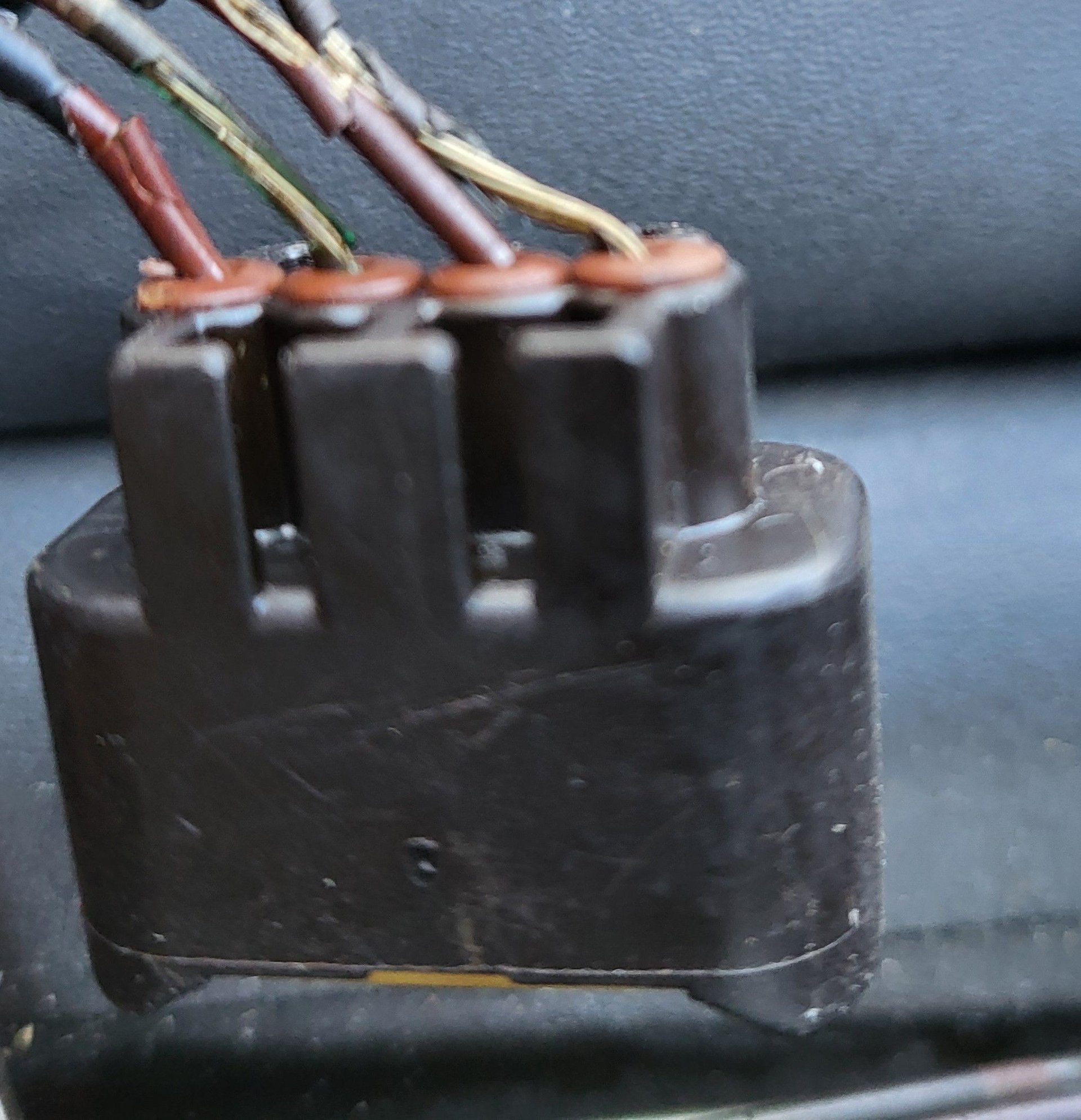

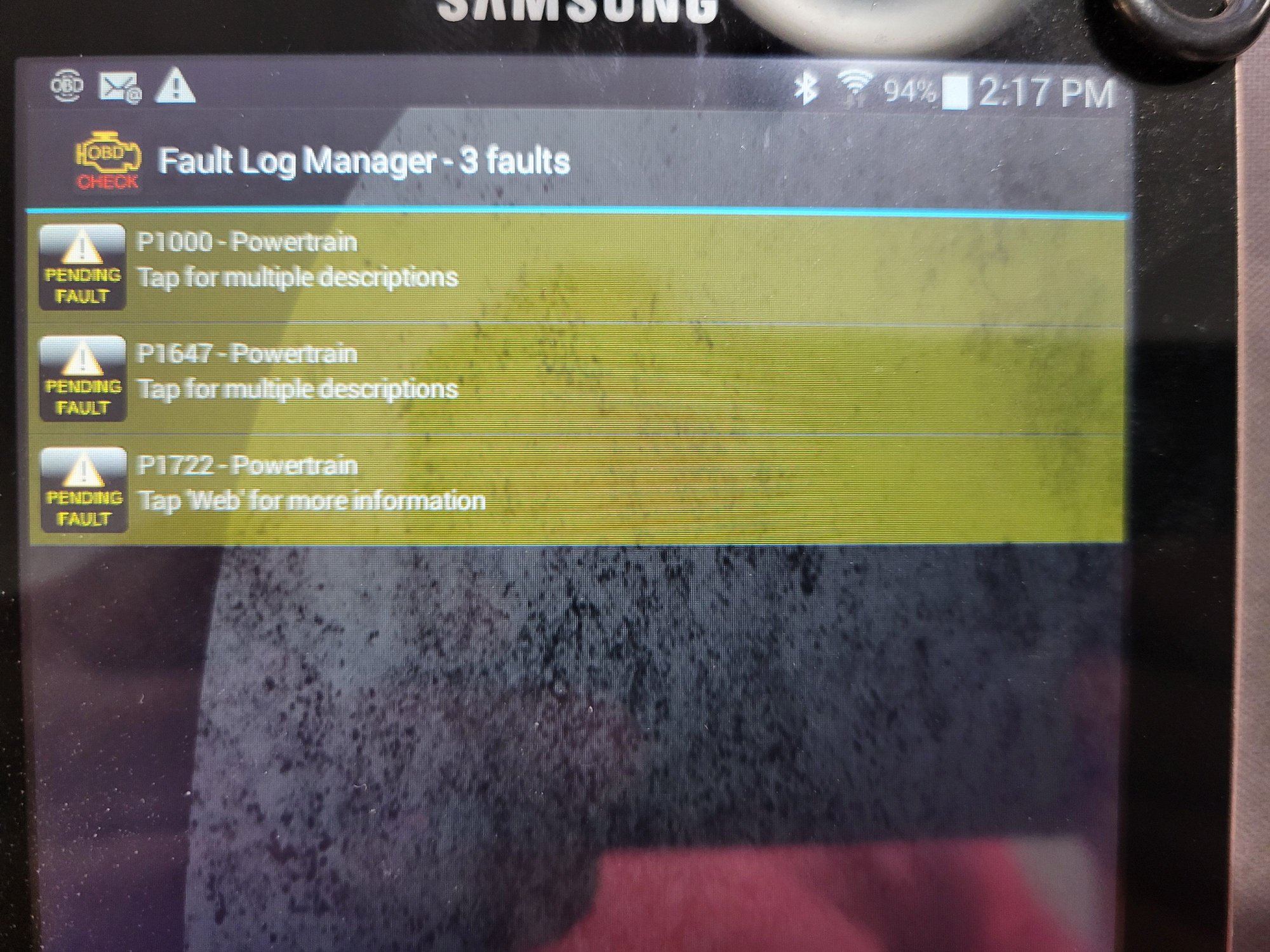

and so the saga continues. Have been driving my son's tank since this occurred and took today off to try and investigate the issues. With the misfires - no dang wonder looking at the harness. Taped up harness as best I could and started her up, checked codes and only showing 1647 for the upstream O2 sensor.
Took it around the block just to see if any misfires occur and just as I'm turning into the drive, transmission slipped and refreshed codes with a new one - which already had an appointment to get checked out.

does anyone have the coil harness part number? I did find a set 8 of pigtails for $40 or a complete harness for coils and injectors for $200. Thinking complete harness would be the way to go but can you just replace the harness to the coils or is it easier to replace with the injector connections?
My concern with the pigtails is that how much of the harness that isn't visible is already degraded, so cutting/splicing a pigtail in will only fix what is visible
