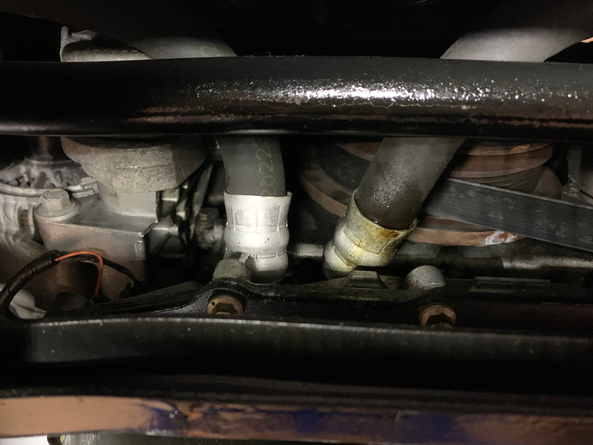

I need a oil cooler hose. I’m not sure if it is the inlet hose to the motor or outlet. It’s the one on the drivers side. If someone could let me know and if you have a part number that would be helpful. Thanks again

Please replace BOTH.(see TSB)

Get all FOUR of them. The others are sure to blow if you replace just one or two.
they have a10 year lifespan . Beyond that, you are rolling the dice, the hard way.
https://www.sngbarratt.com/us/#!/Eng...Parts/Families
they have them and also give a discount t to forum member if you call in your order
