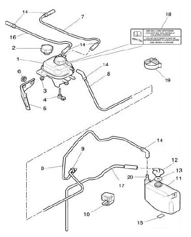

There's the Expansion Tank (item 1) in the engine compartment and the Atmospheric Recovery Bottle (item 11) in the front wing behind the wing liner:
Nearing insanity due to coolant smell.-xk8-expansion-tank-atmospheric-recovery-bottle.jpg
As the engine heats up, the coolant expands and excess flows from the Expansion Tank to the Atmospheric Recovery Bottle.
After the engine is switched off and cools down, coolant contracts in the Expansion Tank and it is drawn back from the Recovery Bottle to keep the Tank to the correct level.
Old Nov 6, 2013 | 08:23 AM
philhef's Avatar
Posts: 2,916
Likes: 547
From: North Carolina
Originally Posted by WhiteXKR
There are actually two tanks. There is an expansion tank hidden in the fender and the fill tank that is visible under the hood. Which did he change out?
the small one up top. We checked front behind the bumper nose and found no leaks.

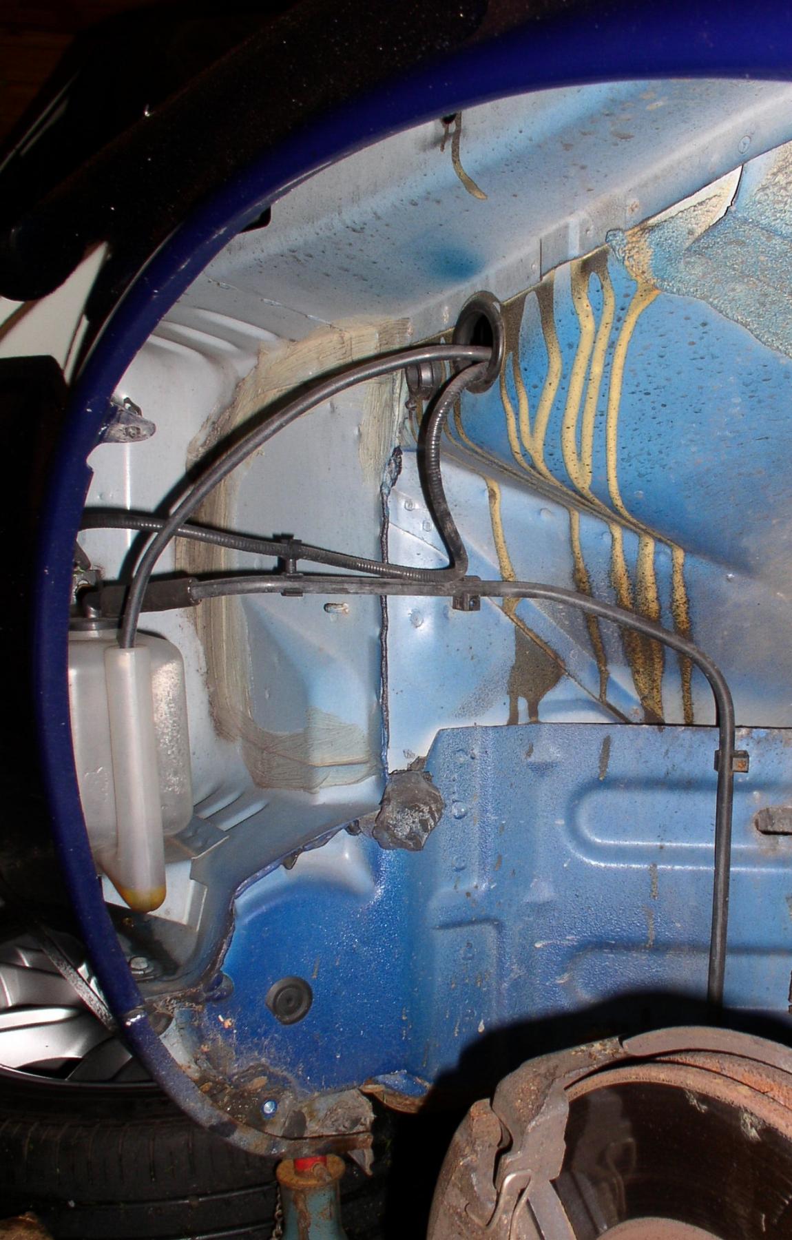

Old Nov 6, 2013 | 09:00 AM
Likes: 17,009
Phil,
The bottle behind the bumper is the Screen Wash Reservoir.
Atmospheric Recovery Bottle is at the rear end of the front wing.
Originally Posted by GGG
Phil,
Attachment 61537
I should have known that! We had the entire front off, fenders and nose.
! He checked that recovery bottle too.
He says its hard to do a pressure test due to the expansion tank. Does that sound right?
