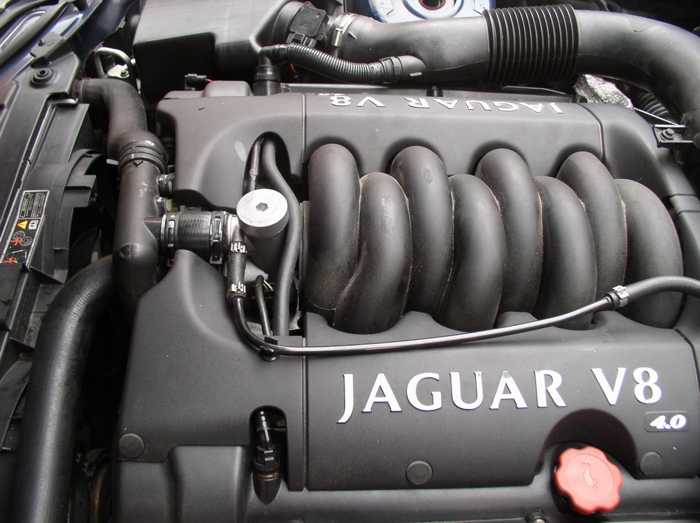

OE Plastic:
Aftermarket Aluminium:
I preferred the aluminium finish and never considered painting it black.
I never considered painting it black on the first car until finished and there it was . . . starting to corrode into the dull aluminum finish of the water pump.
