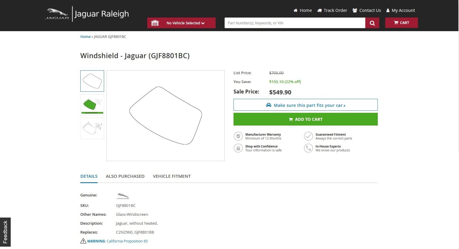

Old Dec 22, 2019 | 06:03 PM
Looks like list in the US is $705 for supply only but several dealers are discounting:

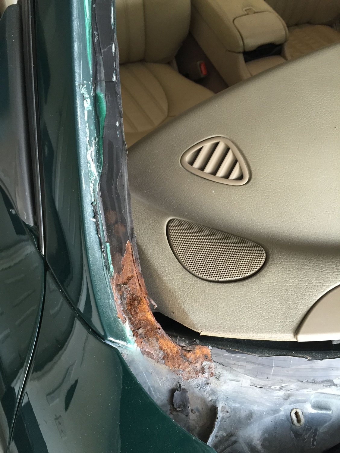

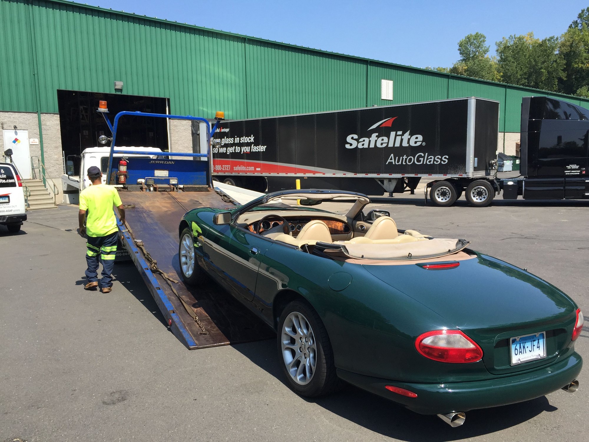

Yes ther is the black pattern on the glass and my recollection is that they glued the original sensor back on. I went to Safelight to have the windshield replaced because it had a crack. When they removed the windshield they found rust in the windshield channel which had caused the windshield to crack. The metal bubbled out from rust and put just enough pressure on the glass to crack it. Now they couldn't replace the windshield because of the rust so I had to have the car towed back to my place to fix the rust issue.
After I did the fix, they sent a tech out to do the install in my garage. He was very good and did a great job.

I had this rust issue with my windshield,
But not as much,
I repaired the rust there and then as the fitter came to my home to change the windshield.
If anyone is having there windshield replaced at home my tip would be to have some basic rust repair/primer etc at hand..
