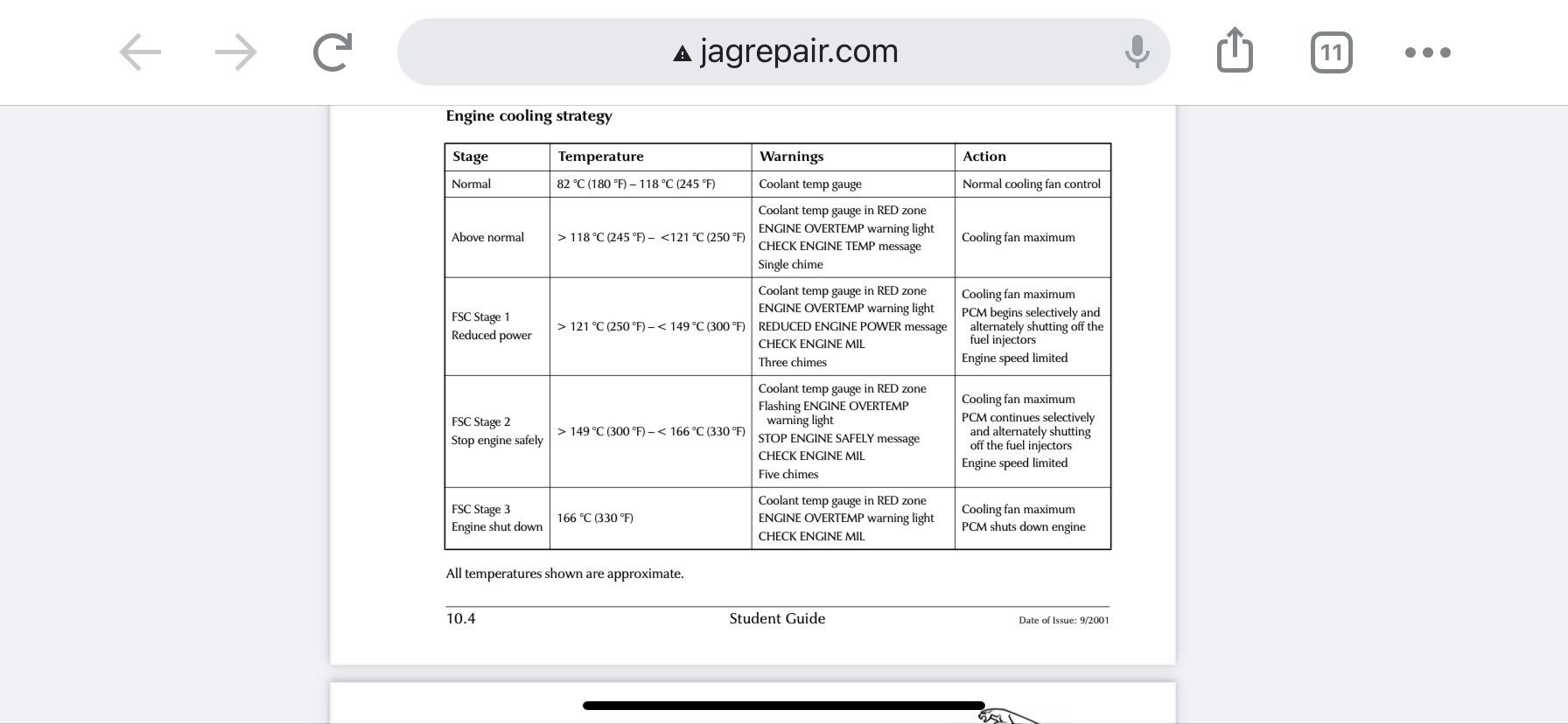

With the KOEO and KOER the fans always kick on not matter if the engine is hot or cold, and stay on until I turn the engine off and remove the key.
This happens when the A/C is on to help evacuate heat from the condenser. Make sure to re-test with and without A/C.
I am less sure, but if the water temp sensor is disconnected/failed, the ECM assumes it is super hot and runs the fan. An OBDII tool will tell you the temp as seen by the ECM.

Replacing the coolant temp sensor may be a good idea. Mine has dies in the past and I think it's on it's way out again. For some reason it triggers the car to go into restricted performance occasionally as the temp gauge shoots up to the top, turning the ignition off and on again fixes it.

Woojo, another thing you'll see. The fans are designed to run for a bit, car off key removed, if engine temp is above a certain level. Not to worry when you see that.

I changed out the coolant temp sensor and it seems to be happier. Still get the rear O2 code and stability control failure. I'm going to flush the cooling system this weekend. Fans still run on high all the time. I bet it's hacked together..
