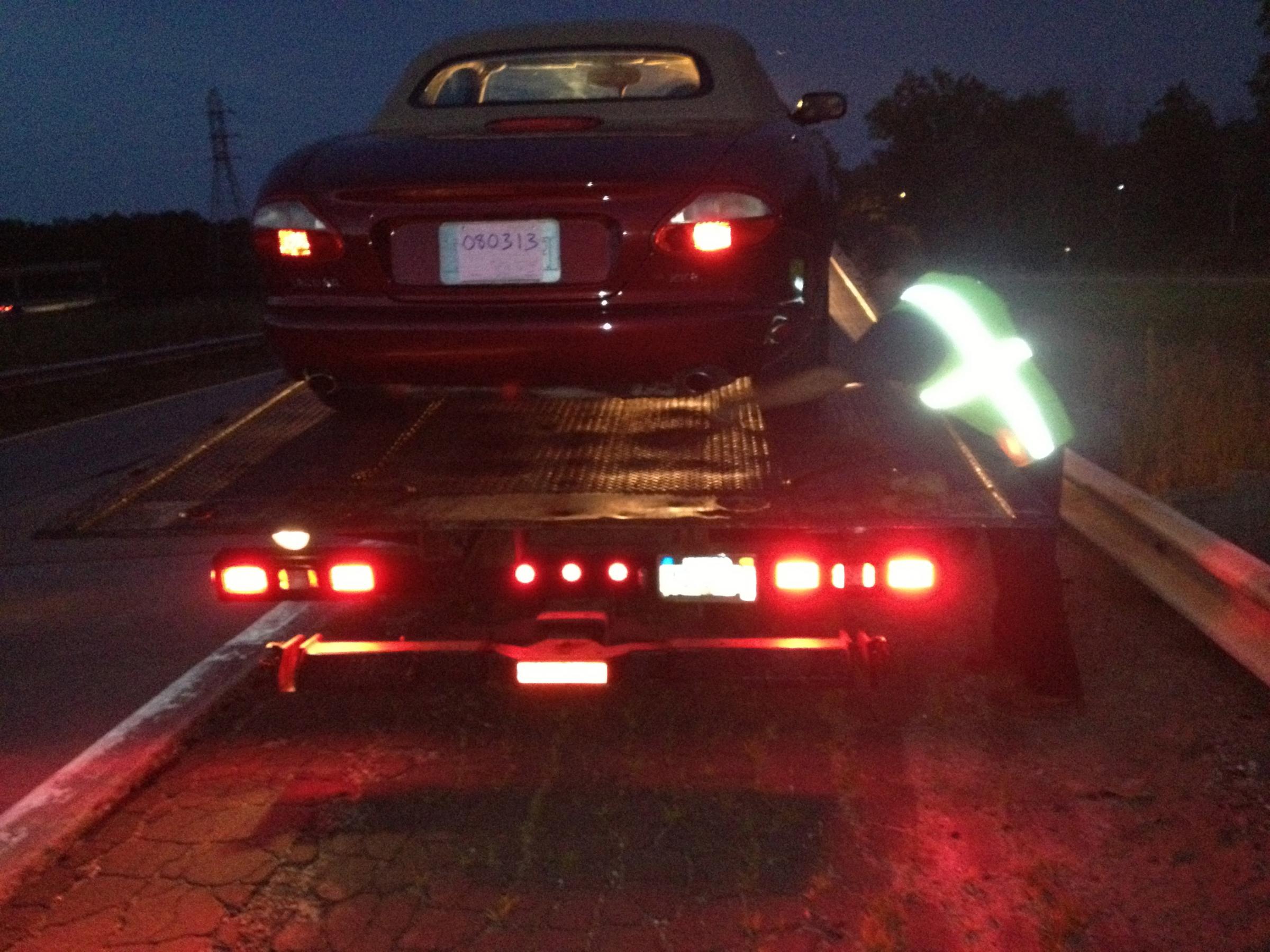

When I bought my 2000 XK8 this summer I was driving it home the day I bought it and the fuel pump failed 3 hours into the trip. I got it towed to an Independent shop and got the fuel pump installed for about 450.00. Not too bad I figured. Now I have a high pitched wine coming from the rear of the car you can only hear with the top up. I think it is the fuel pump. Anyone had a noisy pump before? Any Ideas on how to fix it? Thanks David.
