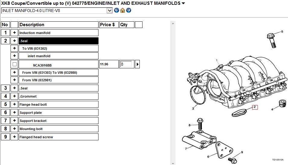

There are two bolts on the throttle body elbow, one each side, that may be what ungn is referring to. There is a support bracket with a triangular piece on each side, secured with three bolts. One needs to be removed and the other two just slackened. This snip from the JEPC should help, although the elbow itself isn't shown:
The triangular plate (6) bolts into the bracket (7) with a pair of bolts (9). The bolt for the top hole in the plate attaches to the throttle body elbow. This needs to be removed on each side.

Thanks @michaelh After a bit of while of trying to find the bracket I did find it. 3 bolts on each side. Am I correct the 2 on the diagnonal need to be removed and the one at the 90 degree angle slackened. I'm going to continue looking for a bit instead of doing it right away. May be tomorrow before I do this part.
Almost Only the uppermost bolt on each side (at the apex of the triangular support plate (6) ) needs to be removed.
I think that you will manage by just slackening the two lower, horizontal ones on one side only:- to relieve any 'pinch' on the elbow. They definitely don't need to be completely removed.
There is a short hose on the LHS that connects between the throttle body coolant reservoir and a tee-piece on the valley hose on that side. If you're changing the valley hoses on this hit, than I'd recommend also replacing that tee, since it's made from the same biodegradeable plastic as the OEM thermostat tower. Part # is NNE3944BA, and it's cheap (~$3.50)
