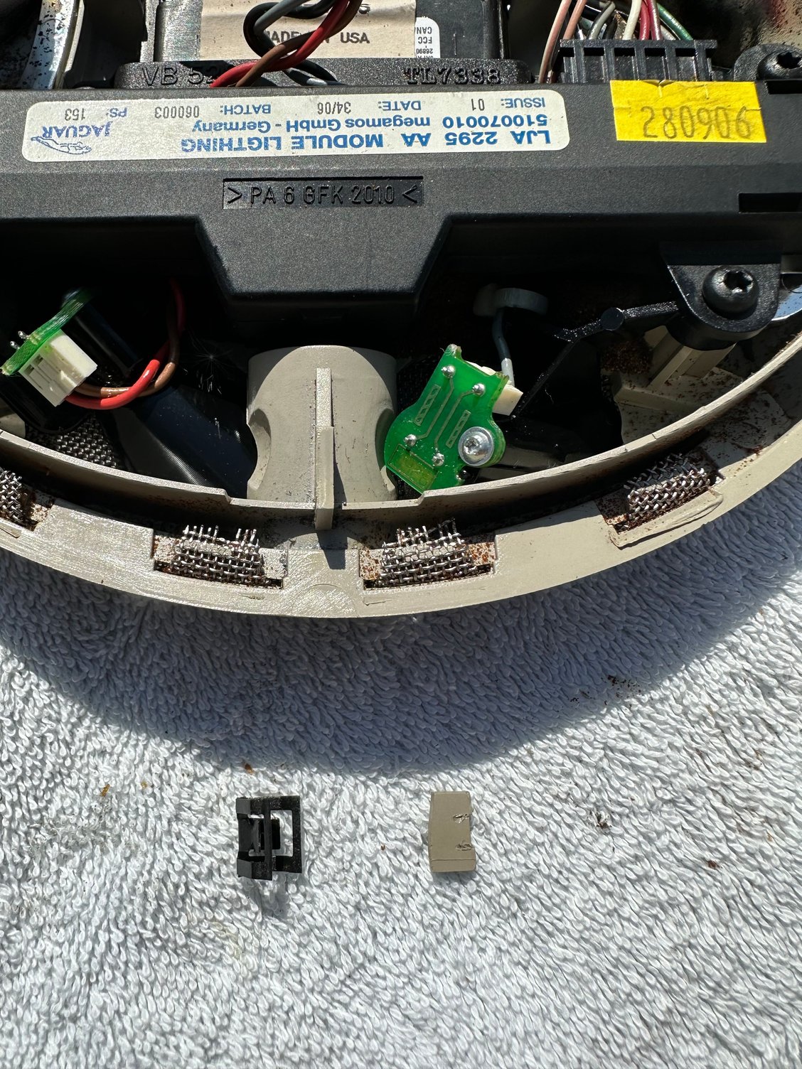

Default Now I have a green shower (well it’s a drip)
My minor query has become a real problem. I was literally watching a video yesterday about leakage around the latch and today I find a drop of fluid by the screen between the two interior lights. Tomorrow I need to dismantle it to see if it’s a hose or the latch cylinder.

Rushi, if you're going to pull the interior light pod down - go slow. That plastic wants to break on you.

Thank, i will take care. I hate pulling everything apart, something always breaks!
John
How right you were. The metal clamp has barbs that dig into the plastic so well I reckon its pretty much impossible to get out in one piece.
