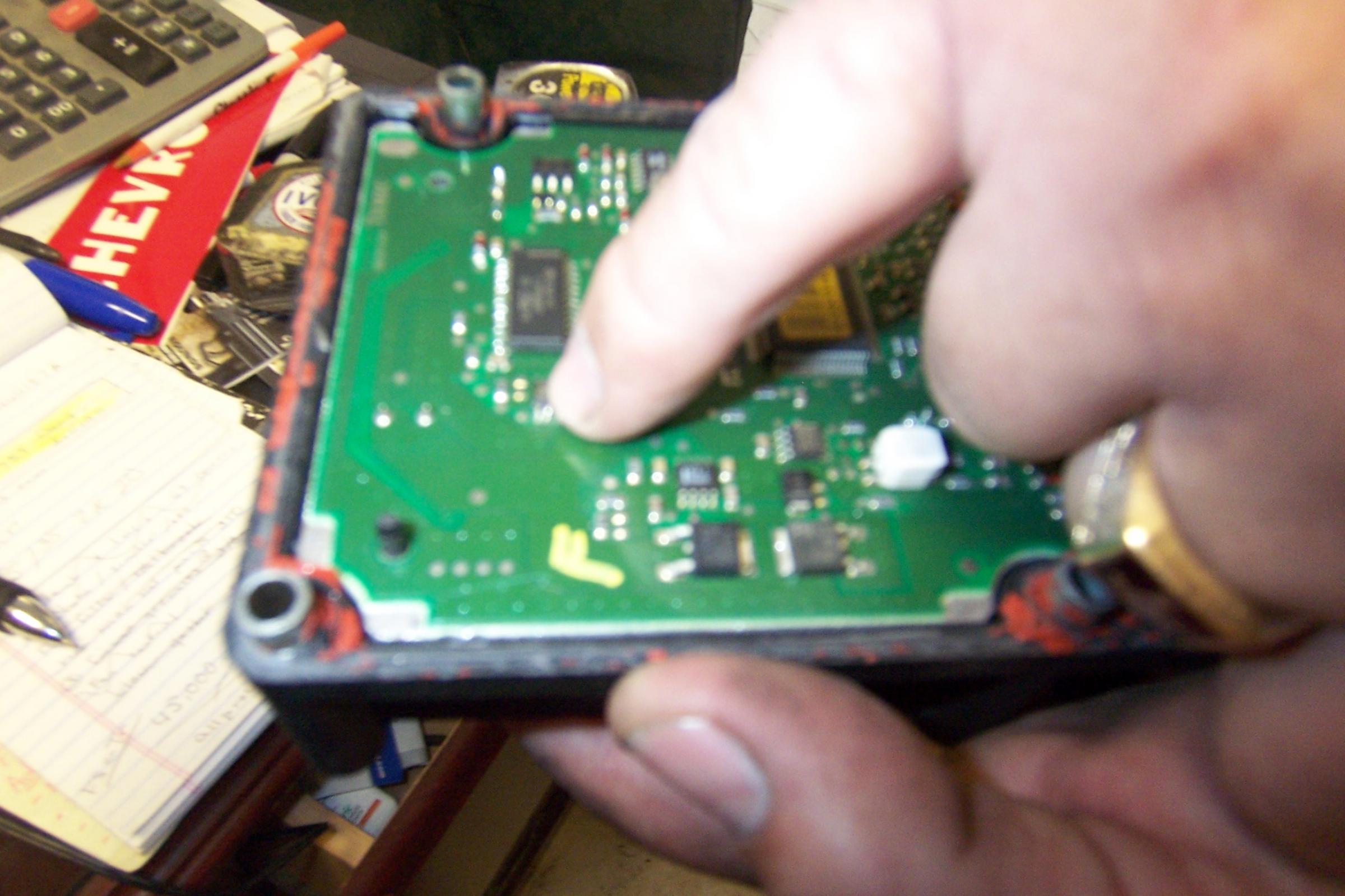

Found it!! The "teeth" ??? on this contact point were spread apart, either they blew apart or I bumped it when I had the module open. Gently pushed them back together and 1637 message has cleared.

The photo is not clear enough for me to tell, but if that is a surface mount component lead that detached it will need to be resoldered. If it is just 'touching' it will become intermittant.

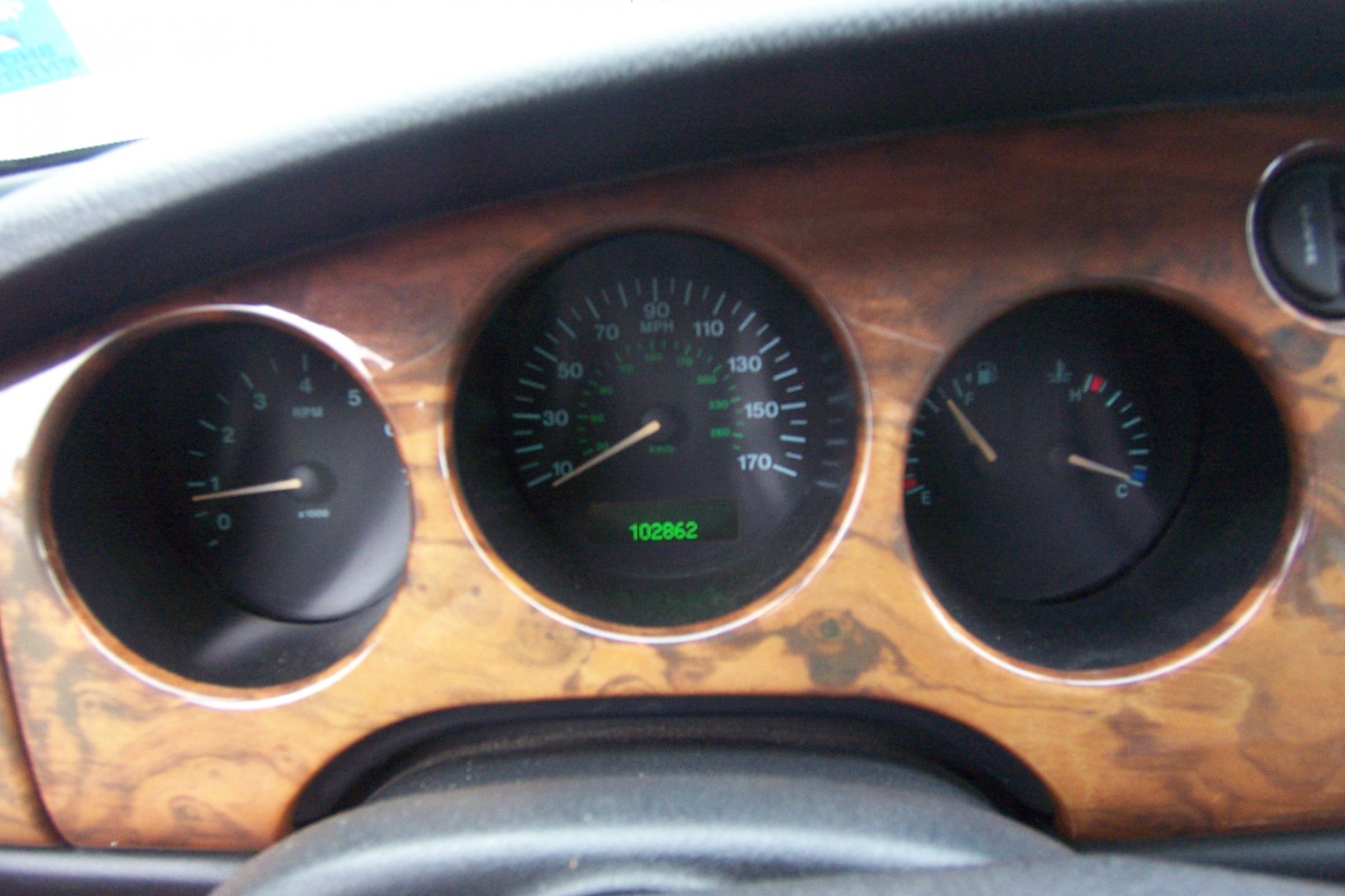

The first time in a very long time I have no error lights on dash!
I did resolder, but if if the problem resurfaces I will know where to look first. Now if I can get my 6-disc worm gear to stay put my car will be issue-less.
