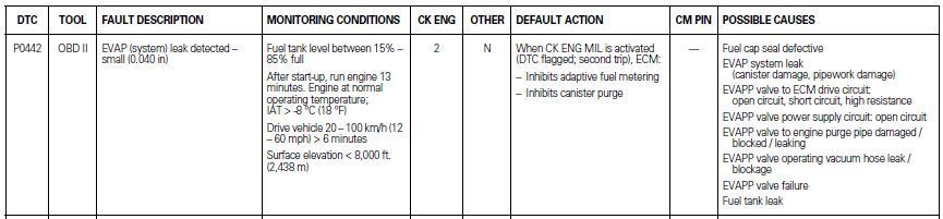

Since that time, the car has has few outings as I don’t trust it. I purchased a Foxwell NT 630plus code reader and pulled a code PO 442 evaporative system leak; P1637 & P1643. CAN link ECM/ABSCM circuit network malfunction; Fuel pump circuit monitor low input is what the cost de reader is suggesting. The antifreeze coolant plastic reservoir was found to be empty upon visual inspection although no light or warning displayed specific to that.
I am at a loss. No local to me Jag mechanic found as of this writing and I haven’t the time now to figure things out.

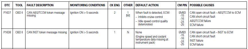

Here are the definitions and published possible causes of P1637 & P1638:
Problems with wiring, connectors and grounds are more common than module failures, so it would be worth checking and cleaning all the relevant connectors and ground points. The CAN wires are Yellow and Green pairs. The ABS Module connects to the Transmission Control Module by way of the Adaptive Speed Control Module, so the connectors at those modules and any connectors in between would be good places to inspect and clean. Cracked, starved and cold solder joints on the circuit board of the ABS Module are very common and can usually be cured by sawing the case apart, reflowing and supplementing all the solder joints, and gluing the cover back on.
See the diagram of the CAN on pdf page 131 of the Electrical Guide, which you can download at this link:

Here the info for P0442. The most common cause is a loose gas cap or a worn gas cap seal, but there are several other possible causes:
