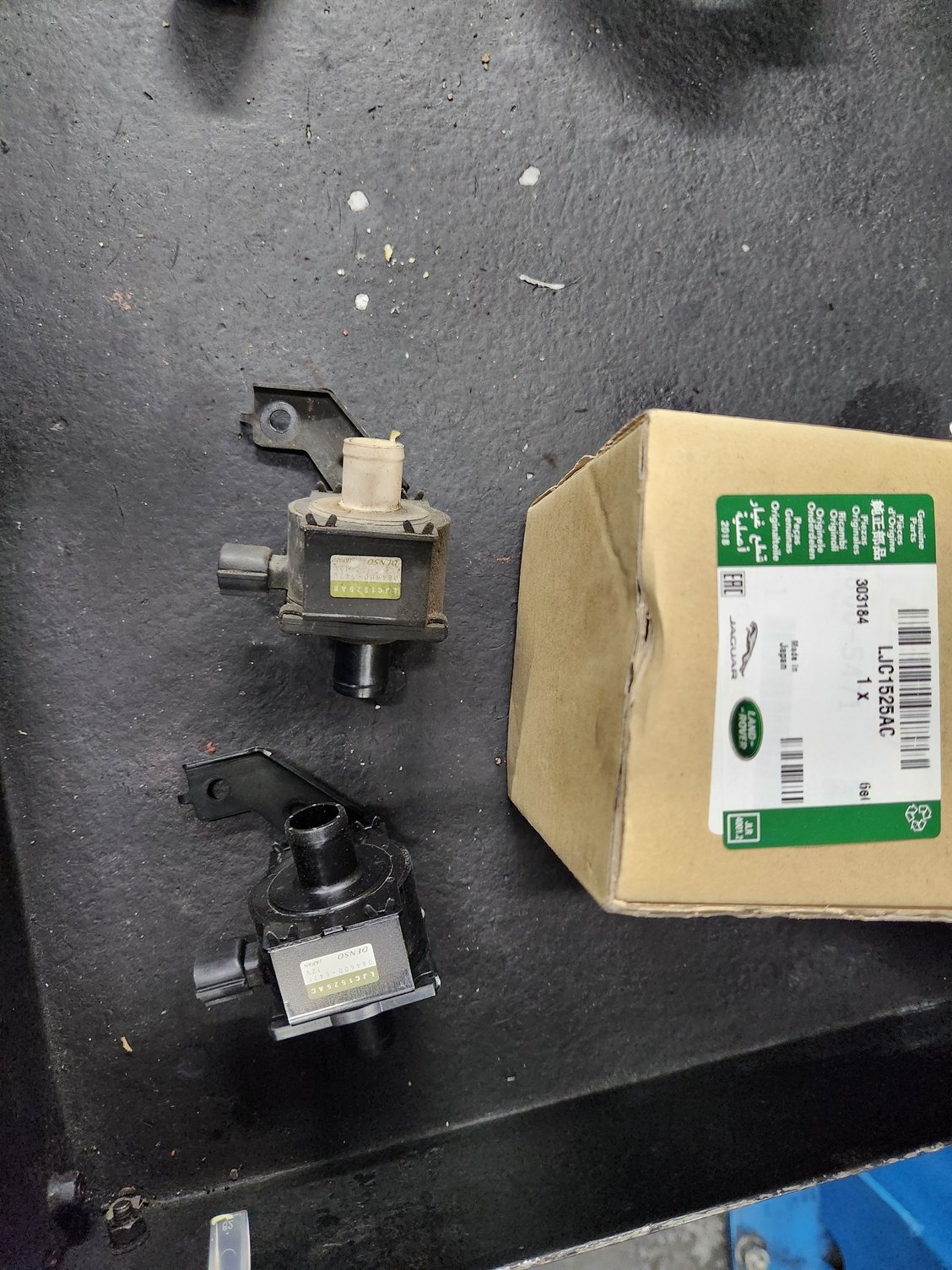

OK. I ordered a LJB1515AB for the low, low, price of $129 Yankee Dollars. If it isn't pouring rain I may get a chance to install it this weekend.
Old Apr 6, 2024 | 01:04 PM
Y2KJag's Avatar
Joined: Jun 2023
Posts: 673
Likes: 333
From: La Habra
Quick question: I have the new valve. The old P/N has been superseded. The new unit has a nipple on the top where the old one does not. According to the Jag TB 303-63, I am to run a hose from that nipple, through the grommet in the fender, behind the brake booster, and attach it to what is essentially an old-school clear fuel filter.
The question is, has anybody done this? Or do you just leave it open and send it?
Thanks!

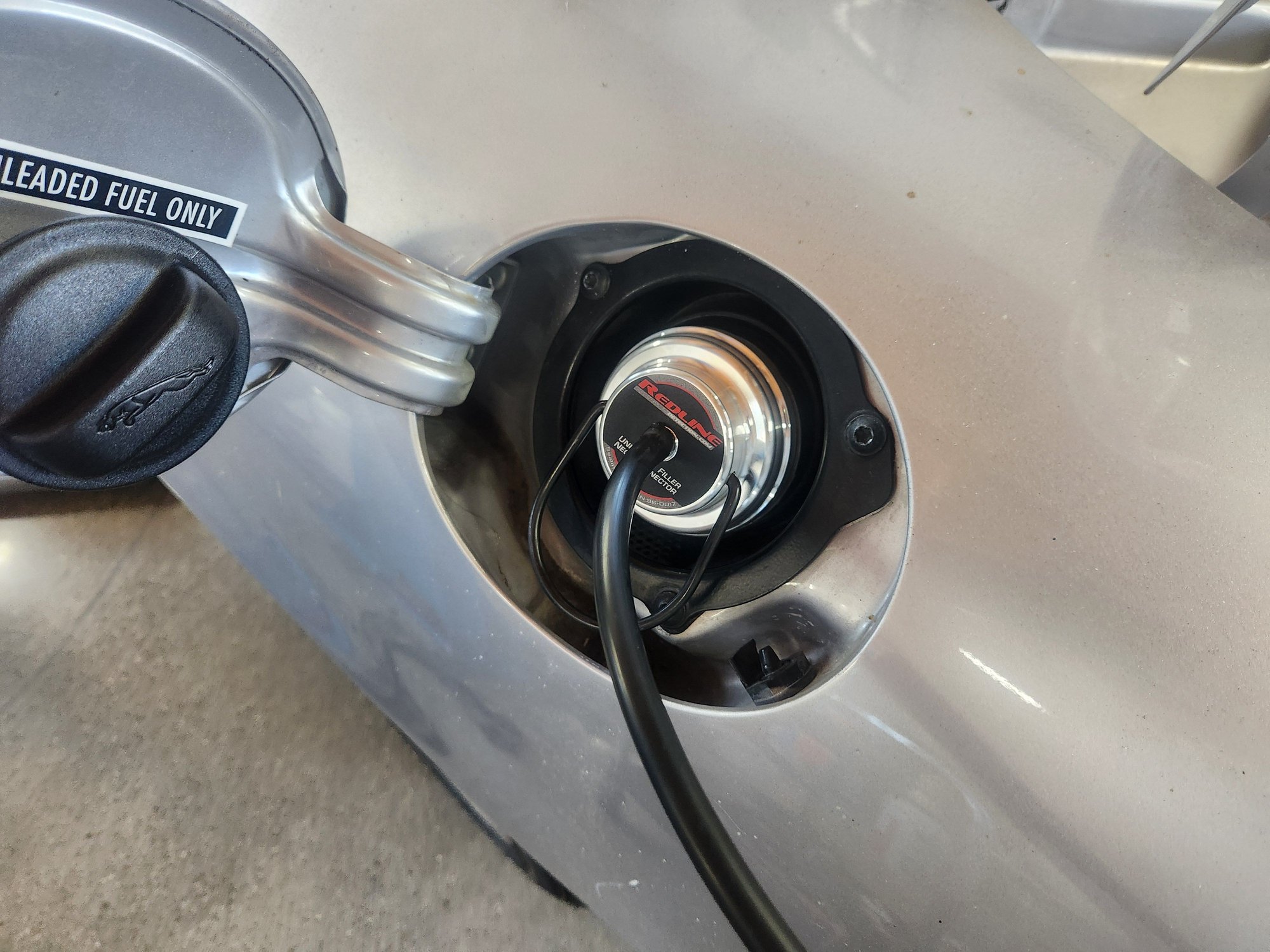

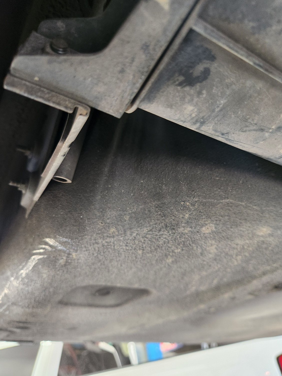

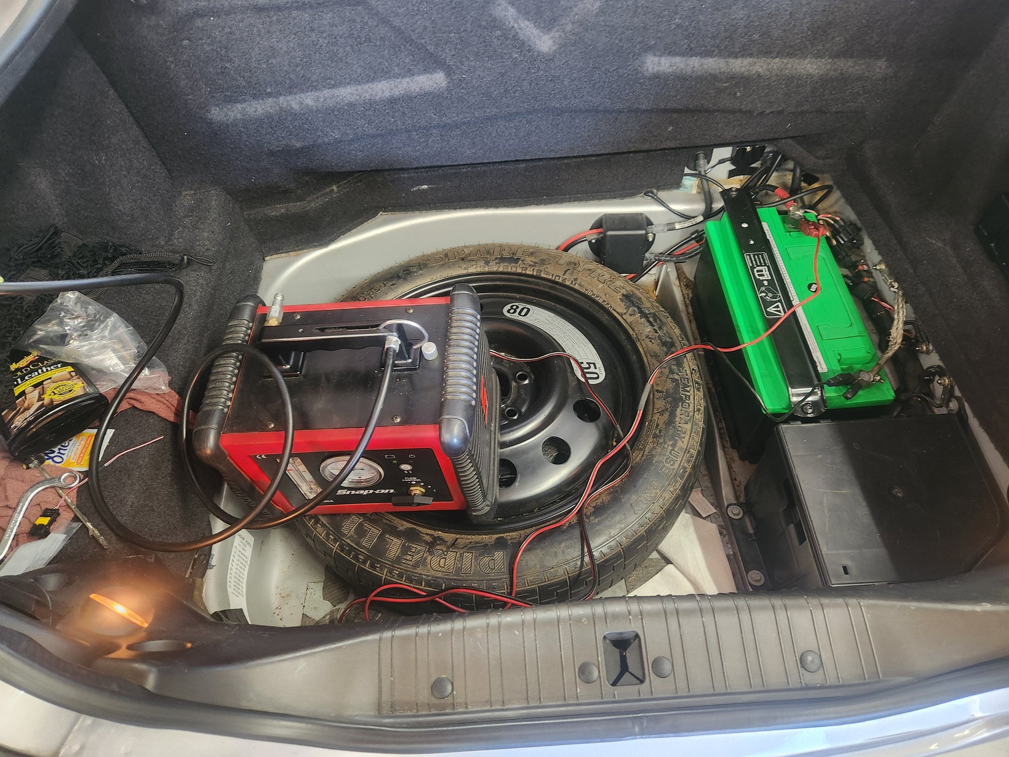

Friday I obtained the use of a variable pressure smoke machine and smoke tested the system. It took a couple of tries, because the machine could be adjusted to where virtually no smoke came out. It was trial and error until I found enough pressure to test the system without breaking anything.
Long story short, there was a large crack in the bottom seam of the RH vapor canister. I must have cracked it when I removed it to change out the adjacent valve that was causing P0477 codes. Also, the combination hose connected to the LH canister was leaking just a tiny bit.
You can barely see a wisp of smoke in the last pic. I took a video, which showed how much was streaming out, but I can't upload those files.
Anyway, I made up a gob of JB Weld and slathered it all over the seam split. I also found an o-ring that seems to have sealed up the tiny leak in the LH unit. I then smoke tested again and this time I was able to build significant pressure in the system and when I removed the hose from the gas cap adapter loads of smoke came streaming out, unlike earlier.
So, I'm driving it around for a few days to see what happens...
