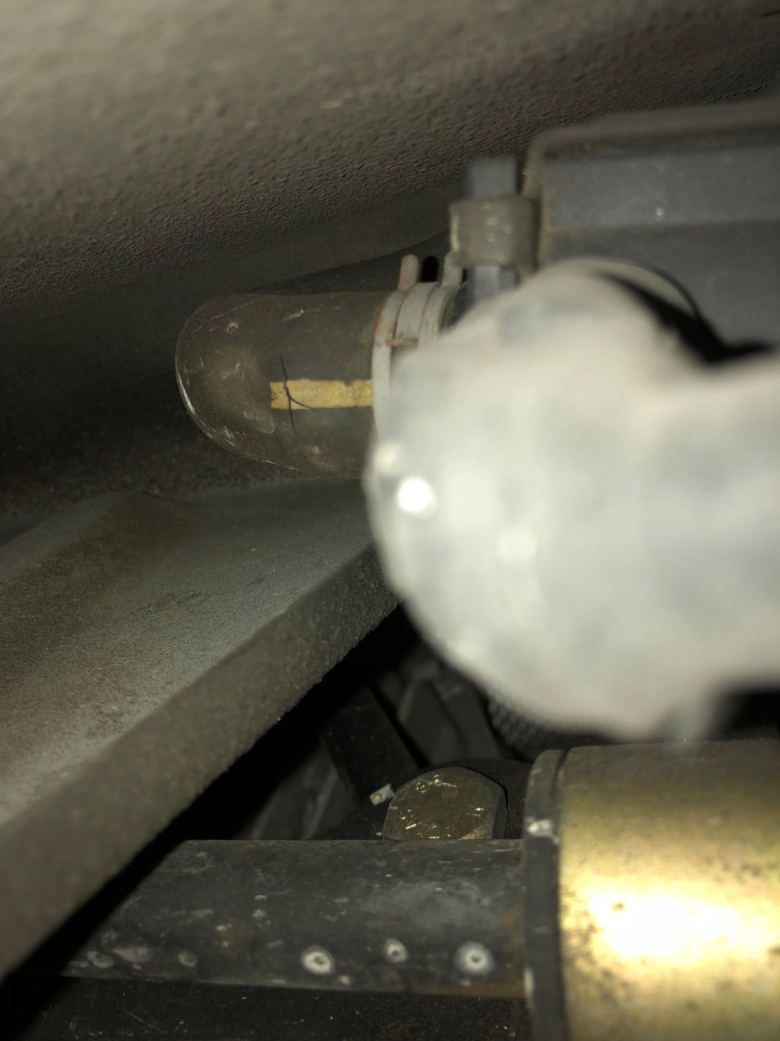

Default It was 2 things on my 2004 xk8
That message haunted me for 6 months. It turned out to be 2 things, a split in the "U" shaped hose that connects to the CCV valve, the split was under the clamp so not visible. I replaced that with a similar hose I found on the racks at my Carquest store. It got better after that, but still showed up occasionally. I then replaced the CCV valve and the problem has not showed up for 2 years. I know the attached picture is hard to figure out, but it is looking straight up above the rear axle on the right side. The hoses that go into the charcoal cannister.

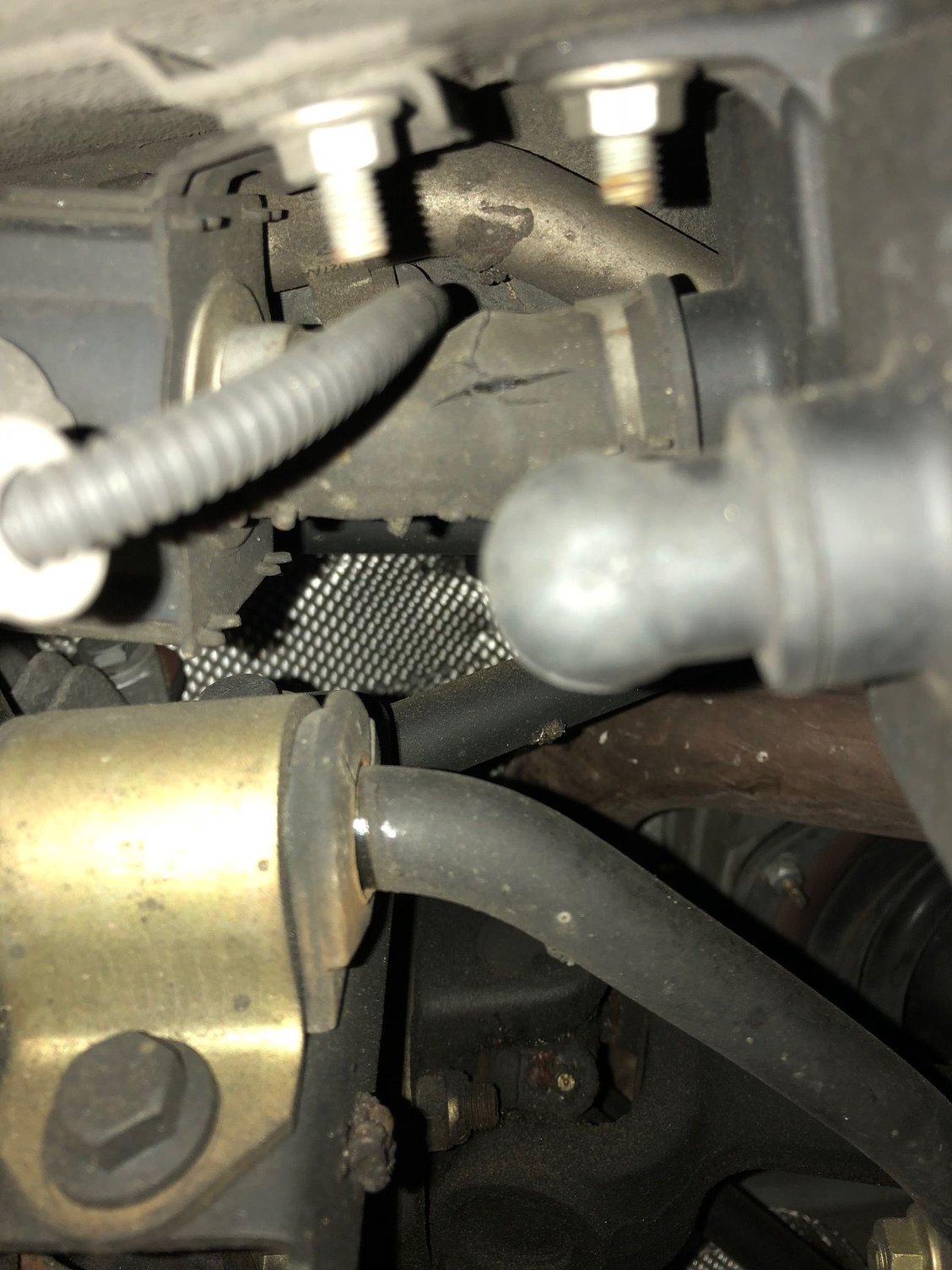

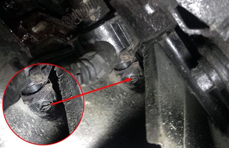

Default Cracks
I can't say this is the problem, but I am sure this is not helping. I need to get under there over the weekend and try and fix.

So, I fixed the hoses on the rear axle, reset, the code came back after two drives.
Next Evap Canister Purge Valve in the front wheel well?
