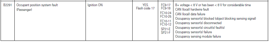

Anyway, im no stranger to hard core troubleshooting and have been working my way through the electrical system, but i seem to fail to understand why i still are experiencing issues with my passenger airbag light.
When ignition on, the airbagsystem does its check and both lights go out, then the passenger airbag light comes on. If i then put myself in the passenger seat it goes out.. witch at first seems to be ok.. sort of.. i mean, no one in the seat ->airbag of.. right? But.. it also feels like with all this fancy sensors and detectors, the passenger airbag light should not come on when no one is present at passenger side..
When i started troubleshooting i had the code 17 on the instrument cluster and the passenger airbag light.

Occupancy position sensor related, possibly. Like all things 4.2L, it's complicated.
The attached may also help
http://www.jagrepair.com/images/TSB/...sh%20Codes.pdf

I do not have any fault codes as for now, but i would be really happy to find a proper test of the seatbelt/airbag system... how it is supposed to function/operate, hopefulle some exact information on when the passenger "airbag disconnected light" are supposed to come one... or not.

Just about everything you need to know is here
Air Bag - Code 17
I've just been through this same problem that turned out to be the same component failure in the SRS module as shown in the linked thread. I got a good used one from AutoReserve Jaguar. Removing the module and replacing it was physically the most awkward job I ever did in my XK8. Not one for the faint hearted!

Exellent! Thanks!
Now i can conclude that my belt/airbag system works perfectly fine.
-No one in passenger seat -> light on, light load in seat ->light on, adult in seat ->light off (activated pass airbag), adult leaning forward ->after 5 sec. light of again.
-Also figured out that the belt tensioners will fire even if you don't have the belt in the buckle, just in case the switch in the beltbuckle is failing)
