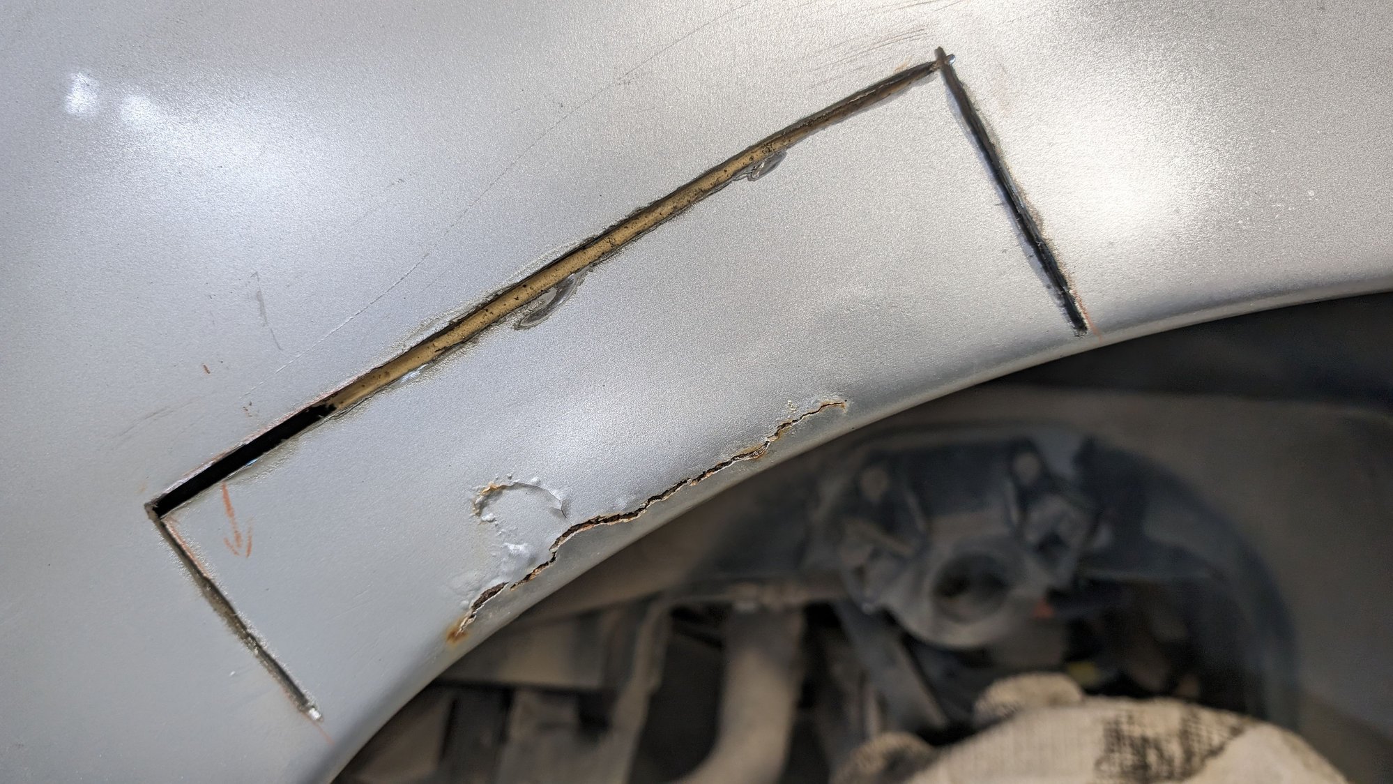

My wife's XK8 passenger side rear fender has a rust spot and it's not getting any smaller. I'm wondering if anyone is parting out a car would be willing to cut a 6-7" piece out of the passenger side rear (right rear) fender and sell it to me so I can weld it into her fender.

Old Feb 22, 2024 | 02:20 AM
A2Hell's Avatar
Joined: Aug 2015
Posts: 23
Likes: 7
From: Ann Arbor, MI
I sandblasted the rust spot a few years ago and patched it with Mar-glass (Bondo with fiberglass), then just used a spray can to paint it to see if the rust would come back before getting the entire fender repainted. It bubbled up and cracked within a year, so I will be cutting they entire area out now. No idea why just in this are (fuel filler on opposite side of the car). When I cut it out I may find out why.

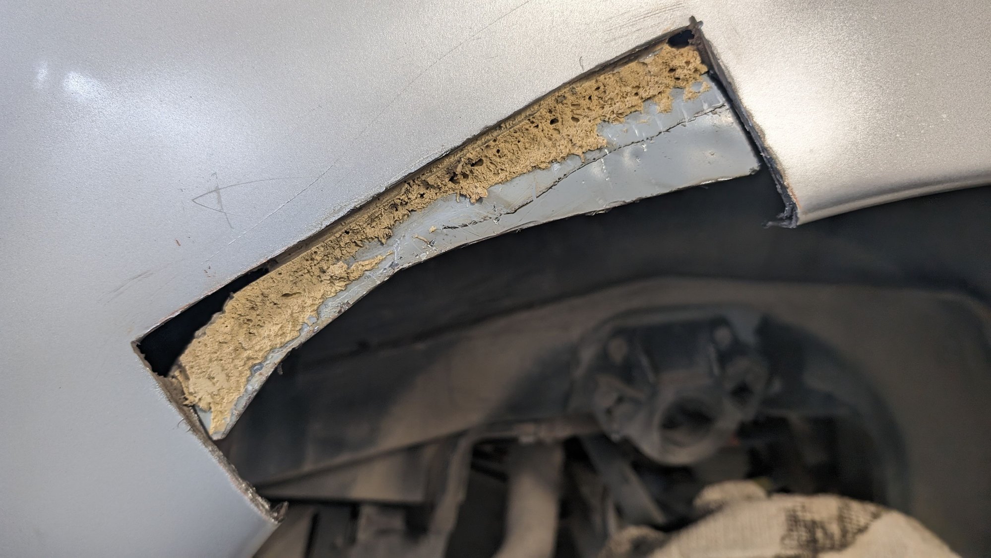

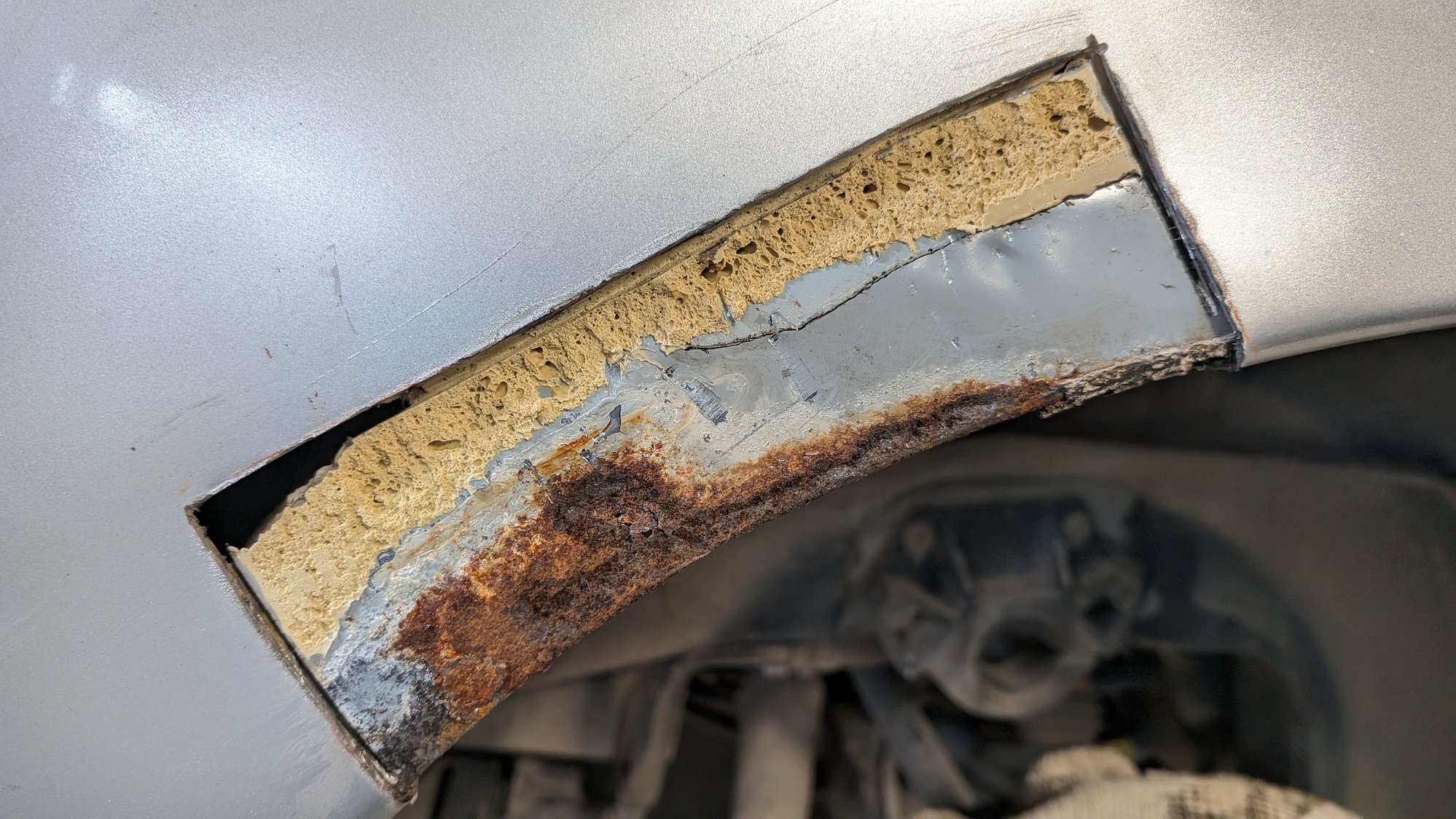

Old Mar 17, 2024 | 06:21 PM
A2Hell's Avatar
Joined: Aug 2015
Posts: 23
Likes: 7
From: Ann Arbor, MI
Right rear fender under reconstruction. It looks like the beige mastic was holding moisture in resulting in the rust. I had something similar occur on a truck a few years back.
