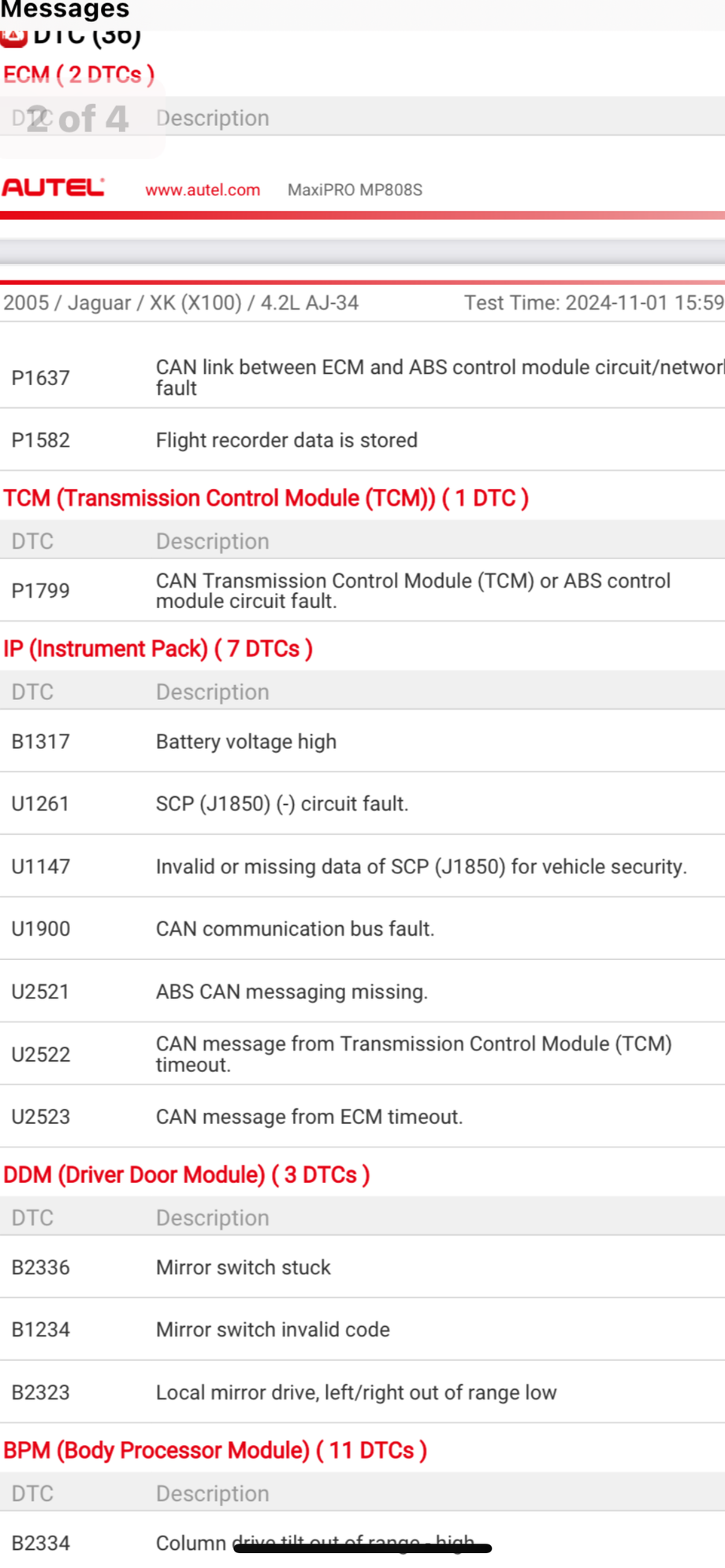

Default Fault codes
Originally Posted by David Wichmann
I have a 2005 jaguar XK8, I replaced the pipe and the water pump, after that it would not start. I am receiving a code saying that it’s the TCM. I’m looking to get mine rebuilt. Anyone knows a reputable place.
these are the error codes that came up for my 2005 XK84.2

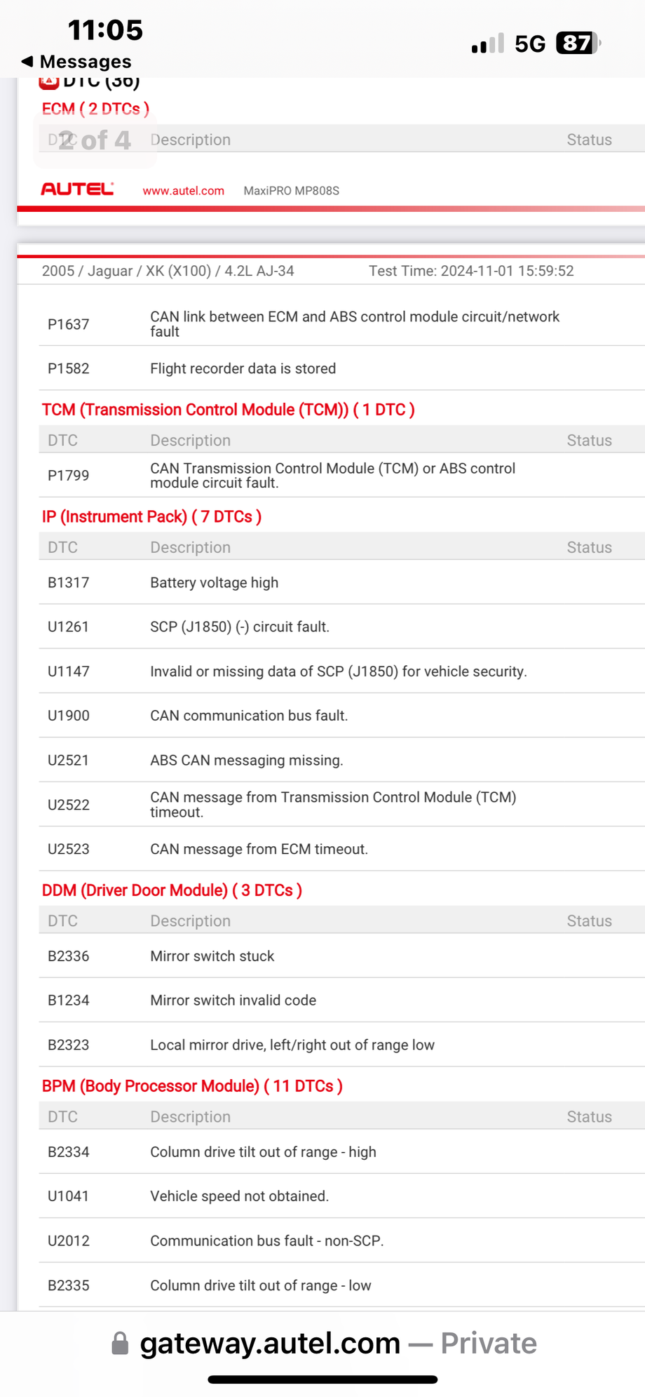

Default Error codes
Originally Posted by JagV8
The TCM is likely fine. Much more investigation needed...
The problem started it overheated. I shut it off pretty quickly noticed that the cross pipe was leaking. I replaced the cross pipe and the water pump. I’d actually started it after it overheated just to move. It started fine after I replaced the water pump and cross pipe crank no startand these are the codes I’m getting

If it was me, I'd delete all the codes, ensure the battery is fully charged and start again! There are too many codes there that look to be ancient history, irrelevant and a distraction. You need an up-to-date list of current codes that truly reflect your problem.

Default Battery
thank you very much I believe that’s 100% correct I’m charging the battery now I had it tested a month or so ago it’s good it’s actually relatively new. I hope that’s the problem. Also somebody told me to turn the key to on position for a few minutes before I start it.
