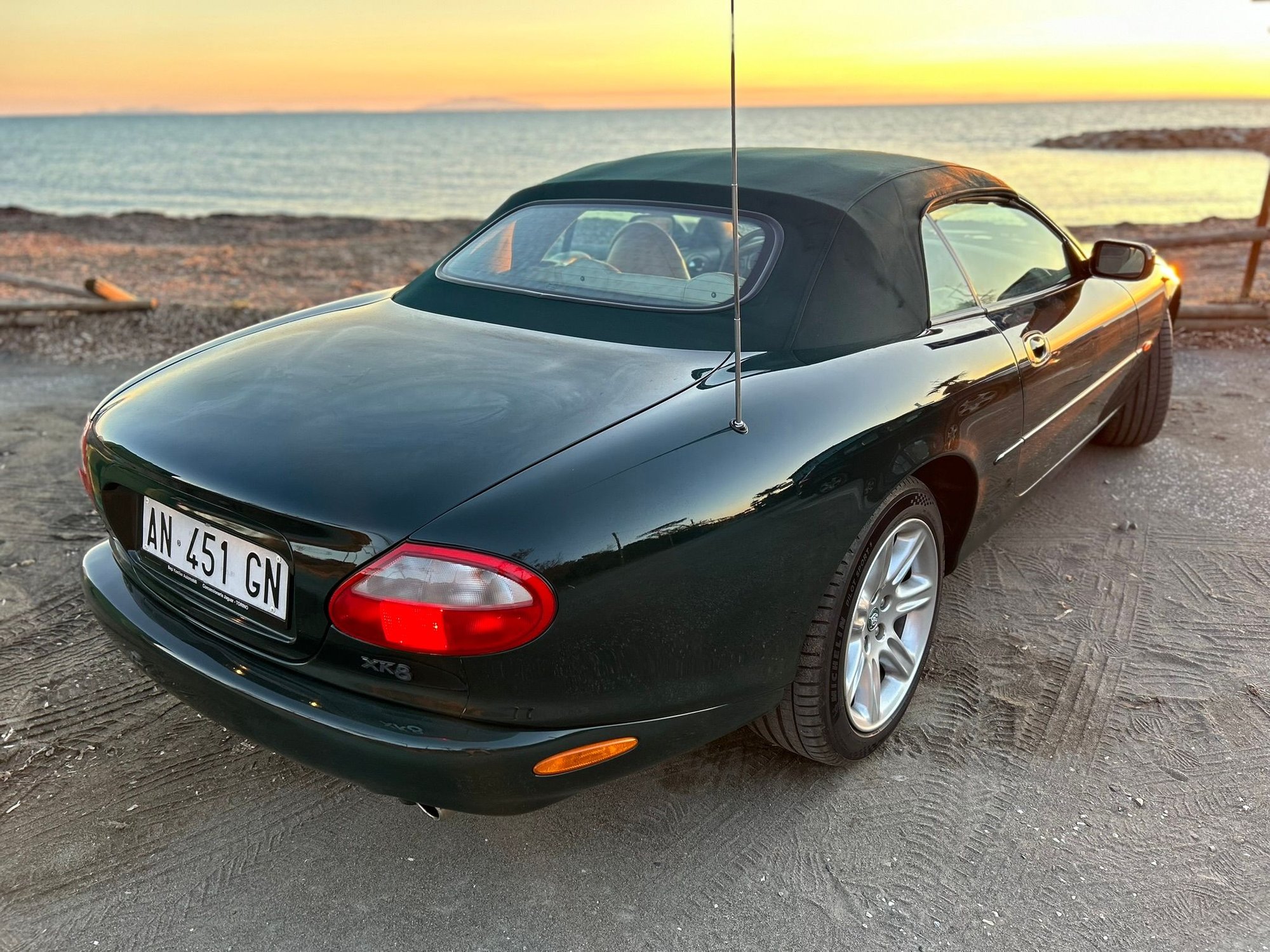

Good evening, I'm Paolo and I'm writing from Italy. I own a 1997 XK8 convertible. My control unit has a PECUS E error. The mechanic tells me that it needs to be reprogrammed. Do you have any suggestions to solve the problem? Greetings to all. I'm attaching a photo of my car. Thanks
