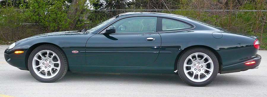

Rear only lowered 1.25", No change in handling.
