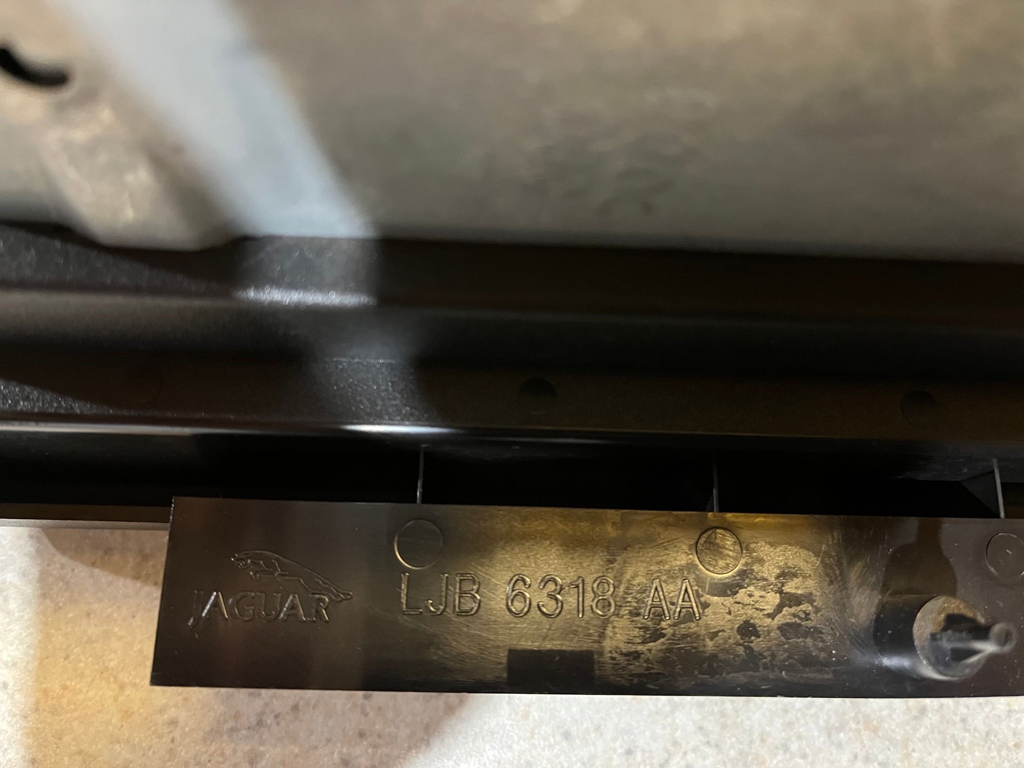

From: Canton, Michigan
My 99 XK8 radio Bezel is LJB 6318 AA
