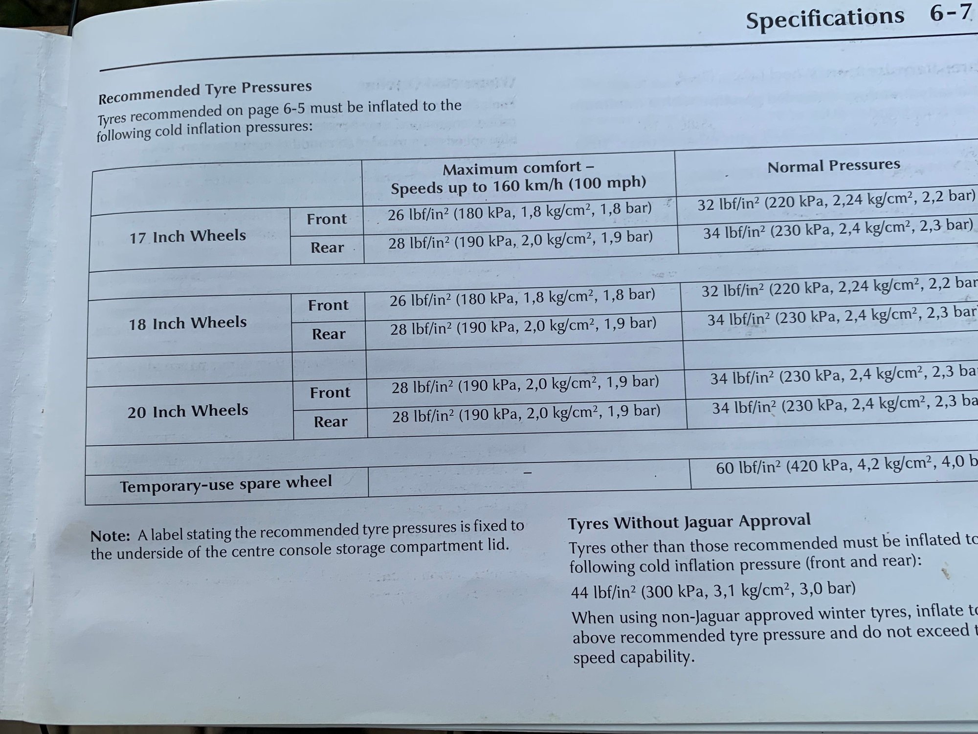

Check the underside of the armrest for the Jaguar recommended pressure for your wheel size and expected max speed. It is much lower than what you are listing.

The Vehicle Care Guide that came with my ‘02 XKR lists “normal” pressure as 32 front and 34 rear for my stock 18” wheels. It also lists an alternative pressure for maximum comfort with speeds limited to 100 mph as 26 front and 28 rear.
I also have found that using the “normal” pressures listed result in accelerated wear in the center of the tread, which is the classic indication for overinflated tires. I’m on my 3rd brand of tires, and all three brands show the same wear characteristics.
To keep the tire wear even I’ve had to lower the pressure closer to the “comfort” recommendation.

as tire compounds are continuously evolving, I wonder what Jaguar’s recommended tire pressure’s would be today ?
Surely there are more than a few owners who have faced these same challenges ?

There was much more forum discussion regarding optimum XK8 / XKR tire pressures 5 or 6 years ago. Yes, tire compounds have evolved during the past decade but I believe the primary issue remains the fact that most new owners continue to overinflate their rear tires regardless of brand or size before realizing they need to back those pressures down in order to extend their treadlife....
