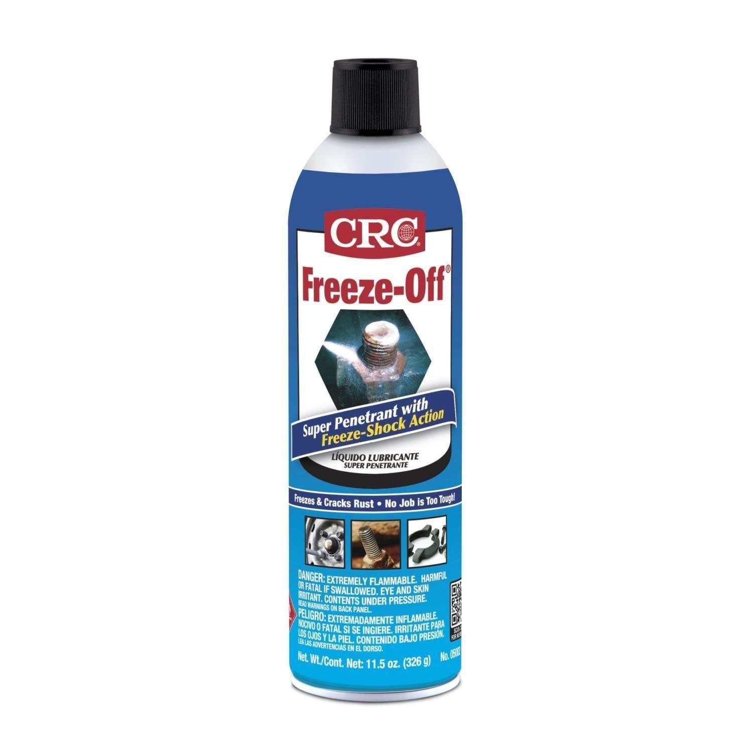

Default Stuck rotors
All 4 rotors were stuck solidly on my ‘02 XKR. I was replacing them anyway so I didn’t mind beating on them with a 4 lb mini-sledge. But they laughed at my sledgehammer, and refused to budge.
The solution turned out to be the aerosol spray CRC Freeze Off. It took about 1/2 can per wheel, directed at the hub and the wheel studs. Then the rotors practically fell off.
The fumes are toxic, so use outdoors or with a fan behind you.
