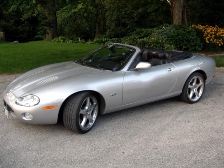

RCSign's Avatar
Posts: 1,342
Likes: 202
From: Quad Cities IL
Steve
A local sign supply will have a adhesive remover and a Lil chizler(plastic razor blade), that will make the adhesive gel and practically fall off, won't hurt paint. iso alcohol also works but you will need a little more elbow grease. I removed mine and I like the look much better
Good luck
Doug
2001 XKR Silverstone

hlgeorge
If I drove the car everyday I would have left them on. We only drive it two or three times a week. And I'm very careful where I park it, It seems like when ever we pull into a restaurant we end up with Rock Star parking. If I have to I'll walk a distance. I don't driven it in the winter but I make a point of starting and warming it up weekly.
