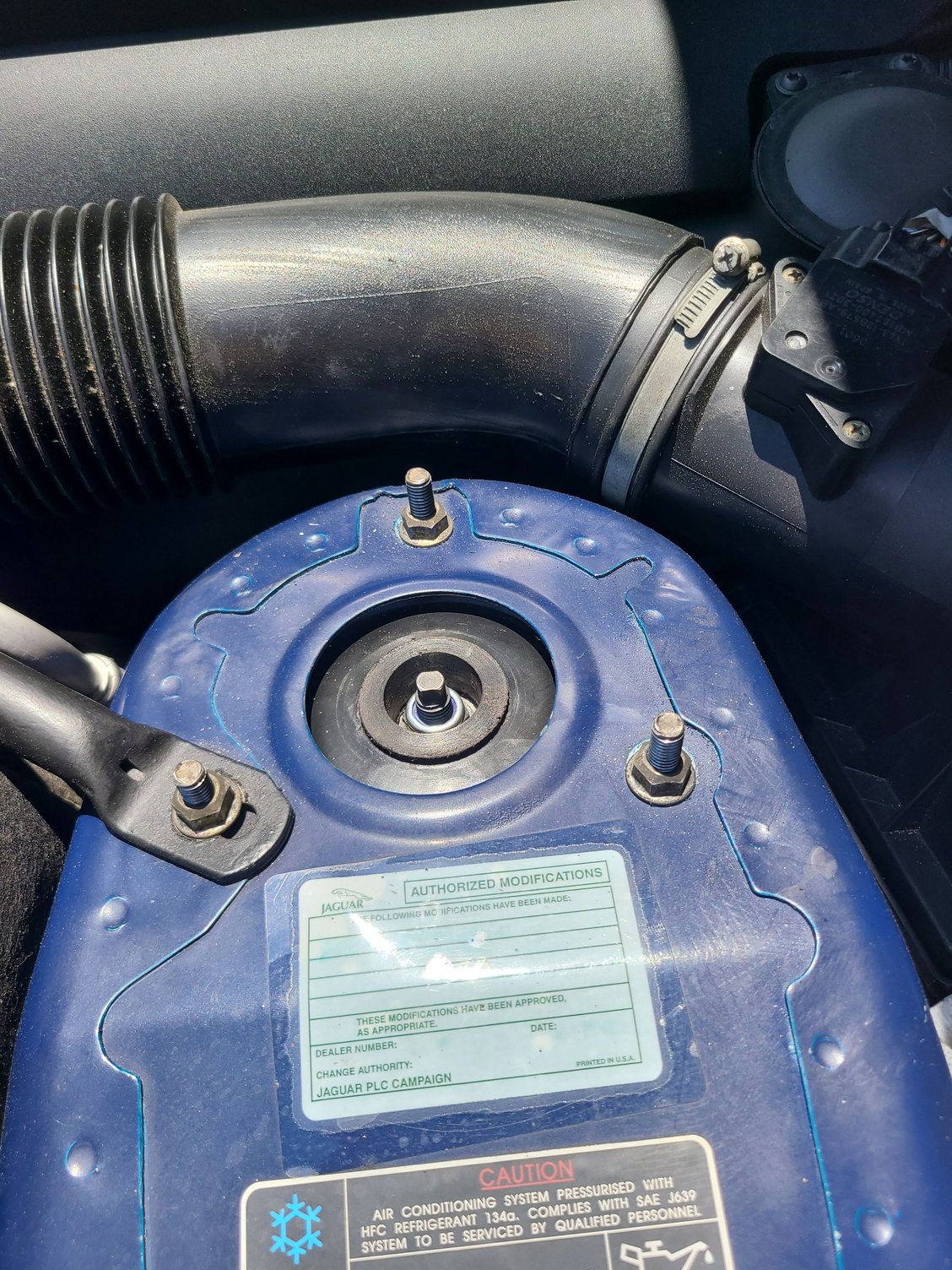

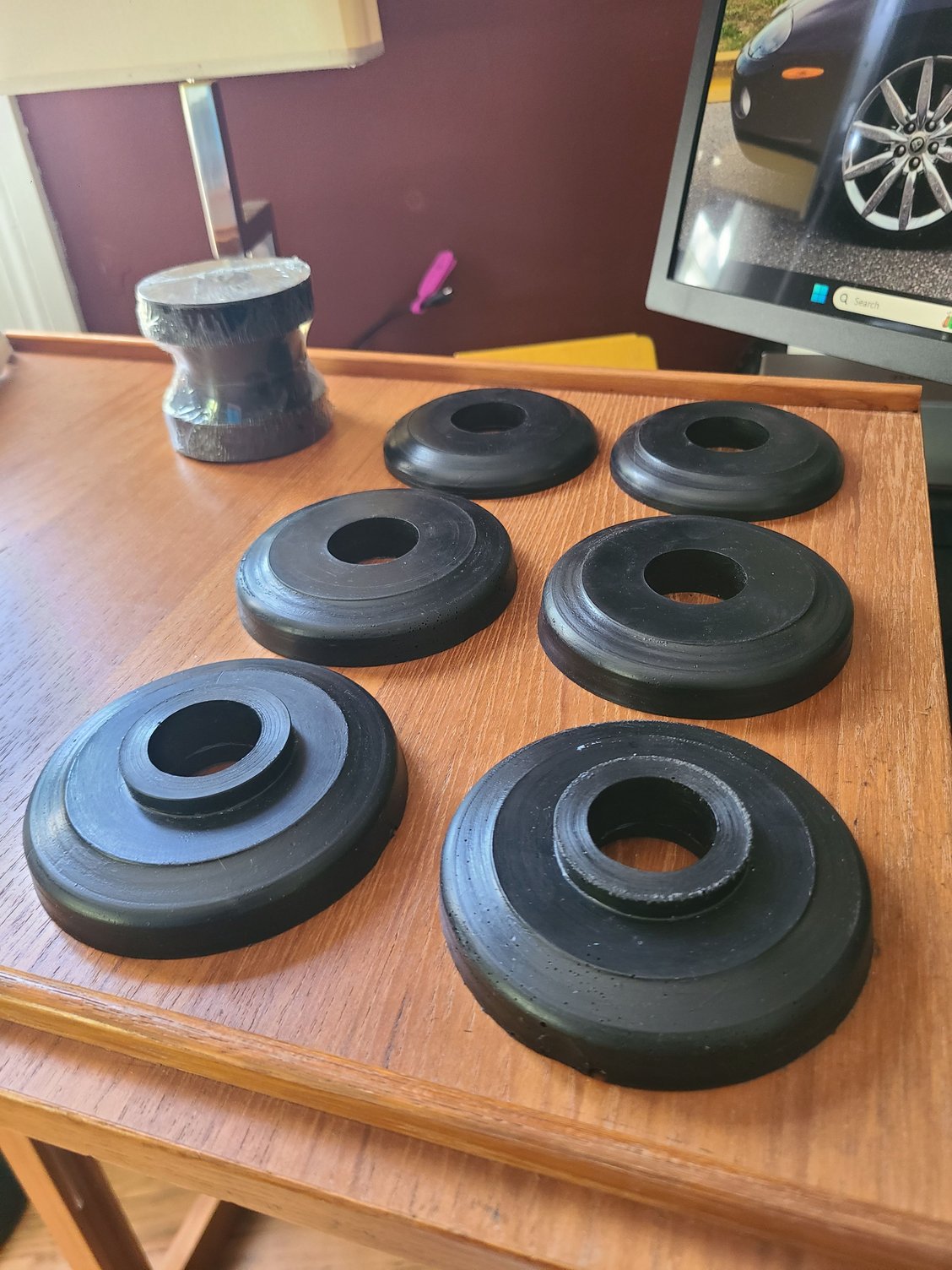

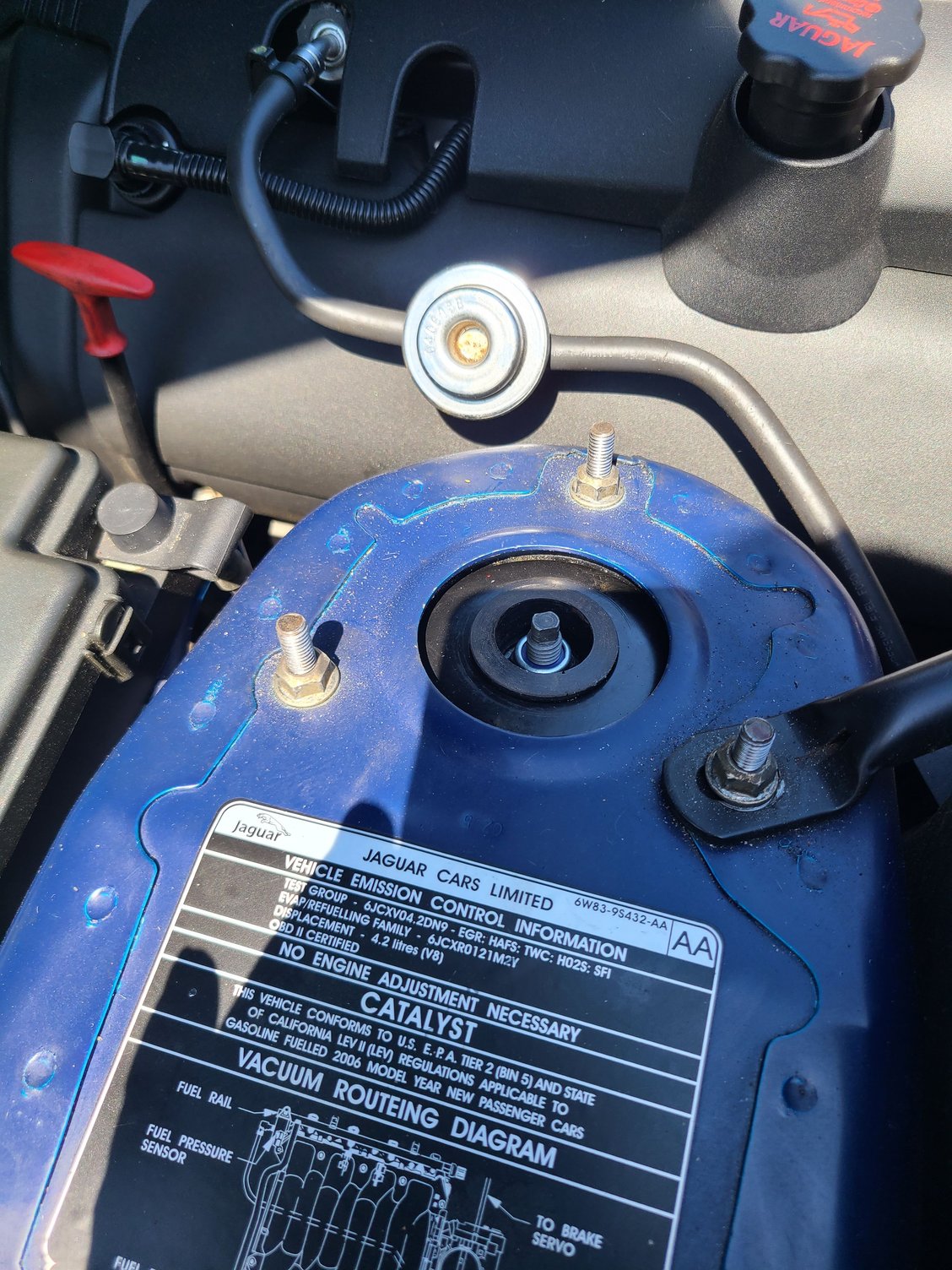

I tried to send this to Steve ("baxtor") as a private message but his space quota is full so it wouldn't let me. I just got my '06 XK8 back today from the shop. I noticed that the cushion material showing through the holes in the front shock towers was still yellow. My mechanic showed me the front and rear spring seats (the big yellow rings) that they pulled out and replaced, but he did not know what to do with the parts shown in this picture. I think they are supposed to go in the shock top mounts--the sandwiches that the bolts go through--but I am not qualified to advise him on this. I also can't remember what the dumbbell-shaped one wrapped in plastic is. I did figure out that the three pairs shown here are all different from each other--the back pair is the same, middle pair the same, front pair the same. But neither of us know what to do with them. Please advise. Would be greatly appreciated. I'm assuming I'll need to take it back and have him use these bits for what they're intended for, but right now I can't tell him what to do. Thanks, Phillip
phil, inbox now cleared.
the components shown are front mount. The dumbbell shaped package is the 4 top damper bushes for the rear, you will also have 2 x rear spring isolators.
I suspect your mechanic has installed front spring isolator but has not dismantled mount to replace the internals, which are the items you have laid out in pic. Respectfully suggest he has not read the instruction sheet included.

Thanks Steve. I will remind him of those; hopefully he still has them. I talked to Wayne on the phone and got myself educated enough to write down the steps and things to be careful of. Took some photos of how they're supposed to go and went back over there to talk to him. I think we're clear. He did not realize I wanted him to take apart the upper front mounts. Everything else is done. New isolators in front and back, new shocks in front and back, new sway bar links front and back. Now we just need to do this part!

Did finally get the job finished with the upper shock mounts rebuilt properly and the center shock bolts centered as they should be. He did not charge me any extra for doing that. Unfortunately, it would seem that at some point while the car was there, something happened to it that left five dents in the upper rear wings and boot lid and cracked the lens of the high-mount rear brake light. The dent repair shop thinks someone dropped something heavy on it. So, that's a pretty big price to pay for suspension improvement, but the dents are very shallow, difficult to see except in the right light, and the brake light housing seems fine; it had a mar on top that buffed out easily. I have an insurance claim in progress with Hagerty and so far that has been pleasant. This dent repair shop is good and they're friendly. They're also busy and booked-out--those two things are directly related! So maybe I'll get her fixed before shows in May and maybe I won't. But I'll go anyway.
