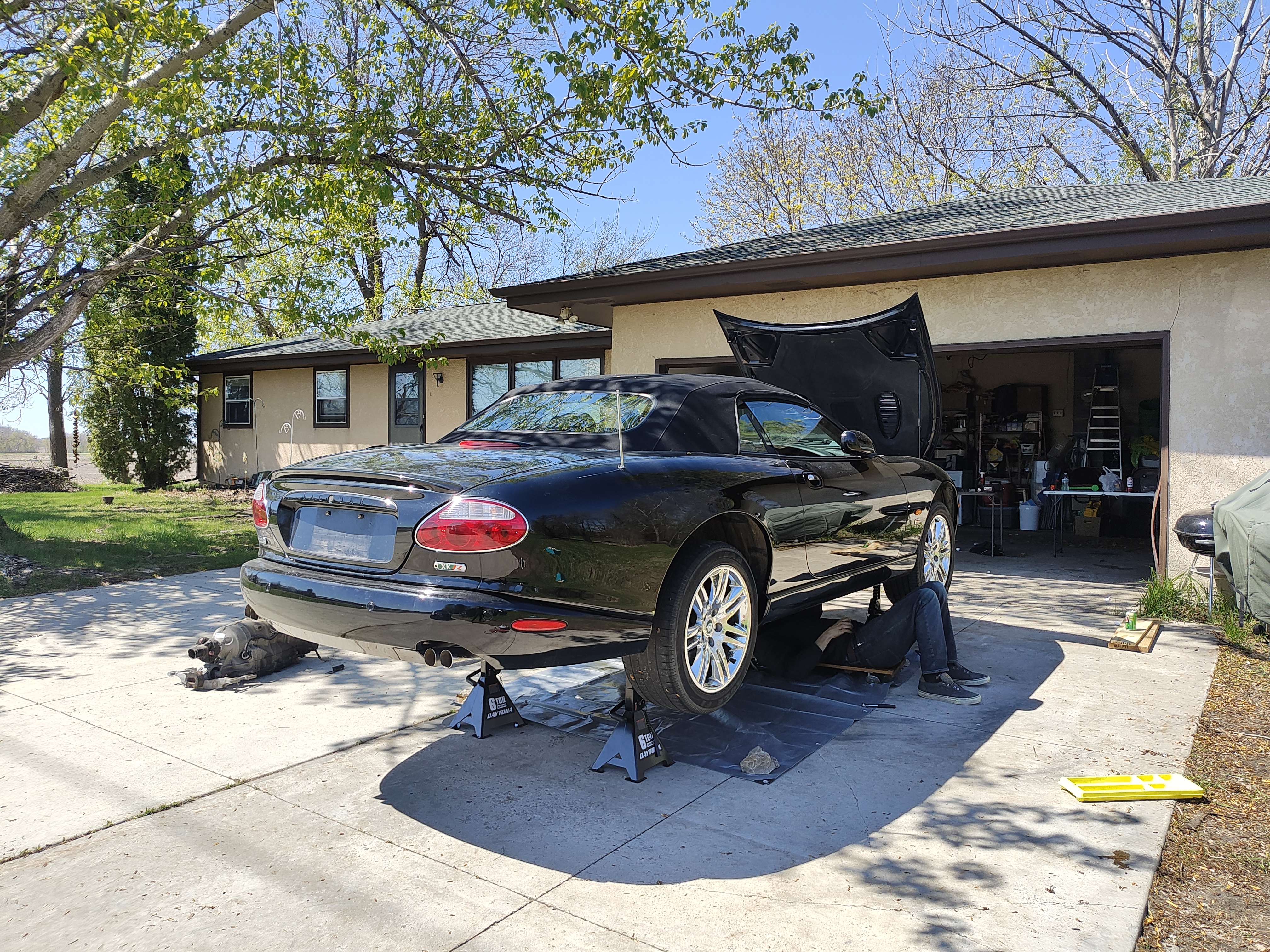

For those that haven't seen my other posts, 3 weeks ago I purchased an '05 XKR that had fallen victim to the flooding that hit Spencer, Iowa, in 2024. The car sat underwater, over the dashboard, for a week before water receded enough to get access to the storage facility it was in. The owner then had it sent to a shop to have the motor professionally gone through, and got it running strong
However, the transmission was worse for wear. The torque converter was making awful noises, and it wouldn't stay in gear.
When I got it home, I immediately sourced a used transmission out of a rear-ended XKR. However, when we went to put it in last weekend, I quickly learned that it was not a direct swap as I'd thought it would be, based on hours of forum posts. The transmission was from a newer X150 gen, and was setup for paddle-shifting. So back to the drawing board.
I decided to give the old transmission a refresh and see if I could get really lucky. When we drained the pan, about 2 gallons of water came out. I was not optimistic. But I replaced the torque converter, the bridge seals, upgraded to the metal pan and filter assembly. Cleaned all oh the connections thoroughly and went through the electrical system, as related to transmission functions. We put the trans back in, crossed our fingers, and...
It drives! It's incredible what the correct Mercon SP fluid and functioning torque converter will do lol
But alas, I wasn't out of hot water just yet (that's a pun, btw, you'll see)
Pretty quickly, my excitement was dashed by the dreaded flashing J-gate lights and gearbox fault once more. From my reading, I'm thinking I need to do a pretty hefty overhaul of the J-gate mechanisms. They're very crusty from the water intrusion. And, to top it all off, the car decided to overheat, which was a first. I've had the car idle for long periods of time and never had an issue. But I believe my fans are no longer functioning, and I'd be shocked if the small-town Iowa auto shop used the correct coolant. It looked awfully watery...
So the project continues chugging along! (get it?)
All-in-all, I still fully believe I'm on the right path and I don't regret taking on the challenge. There's gremlins that will tear my patience for sure, like the car being stuck in valet mode, and the hydraulic pump for the top mechanisms not shutting off unless you pull the relay. But if the car is running and driving well, it will keep me motivated to continue tackling these woes one-by-one!
That's where we sit. I hope everyone had a great weekend!
