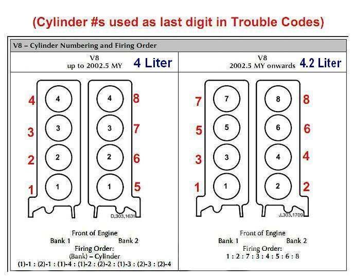

Workshop manual said P0353 related to cylinder 5
I think that your workshop manual is in error. P0353 relates to cylinder #3 rather than #5.
Old Apr 3, 2026 | 04:49 PM
michaelh's Avatar
Posts: 4,822
Likes: 3,045
From: Jersey, Channel Islands
For some obscure reason, Jaguar renumbered all the cylinders for the 4.2, so, if you get the wrong layout diagram, cylinder 5 is in the same place as cylinder 3
Thankfully, the P-codes are correct wherever the cylinder may be...
to the OP - It appears you have a faulty coil pack, note that a dud one can affect other cylinders in the same group

Well that explains why I thought it was #5. I'll switch #3 with one on the left bank tomorrow and see what I get. Thanks
Probably to match international standards including OBD II numbering.
Old Apr 4, 2026 | 08:14 PM
Dlb77's Avatar
Joined: Apr 2026
Posts: 10
Likes: 5
From: Colorado
Cleaned connections as recommended by 2500dollar xkr, thanks to michaelh I switched my #3 coil with #5 and the dtc went from p0353 to p0355. So I will replace that coil and hopefully that clears up the misfires. Now on to the gearbox fault and replace O-rongs on the transmission connector as recommended by zray. Thanks to everyone for your help
