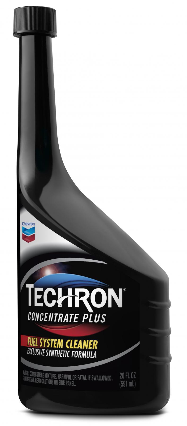

Hey Bleeth, could you please show me the bottle for this tech tron bottle, i facing the light of restricted performance each trip it comes and goes, and once its there, it reacts crazy each time RPM reaches 3,
regards
Moayad
Old Aug 24, 2014 | 01:18 PM
bleeth's Avatar
Posts: 53
Likes: 12
From: Delray Beach, FL
Misnamed it slightly! It is Chevron Techron and available at pretty much all auto parts stores.
Restricted Performance message is actually a built in warning that due to some condition the on-board computer has decided to protect your engine by not allowing it to rev too high. That's why when it is lit your engine runs "crazy" around 3000 RPM's
In my case the check engine light would also come on sometimes and when checked on the reader indicated engine running rich on one side. Mechanic put his full diagnostic on it and determined that it wasn't, so he thought it just might be a little dirt buildup somewhere in the fuel system. The Techron basically acted as a cleaner.
Attached Thumbnails Restricted performance and more!-techron_concentrate_plus_20oz.%5B1%5D.jpg

+1 on that stuff. I put some in before my 320 mile trip last week. Was having random rough idle and now it idles so smooth you can hardly tell its running.
