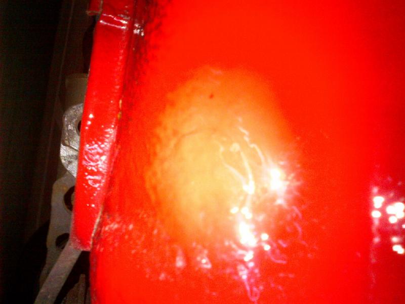

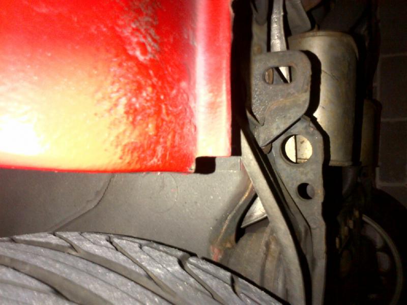

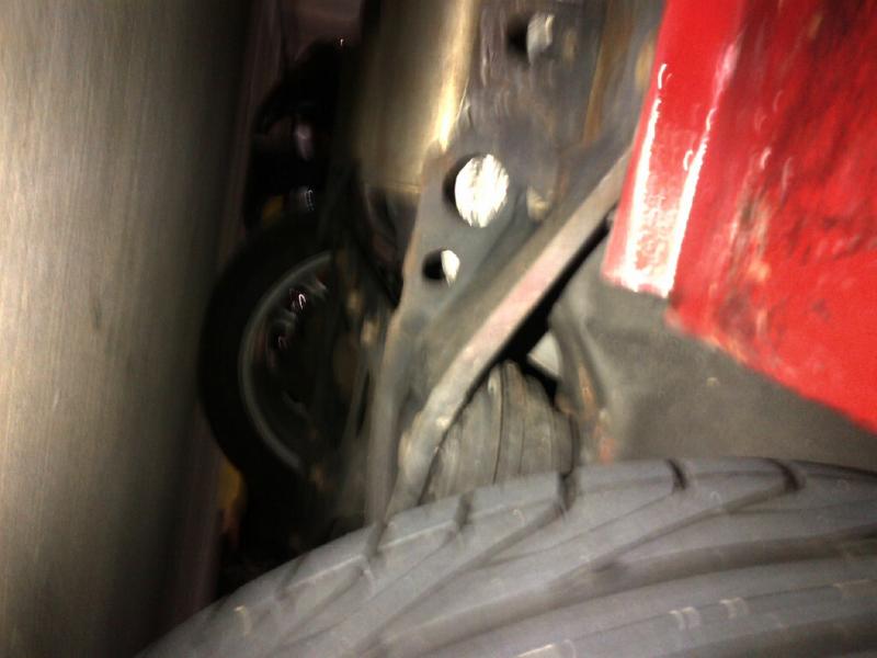

Here are some pics:

That looks more like just the stone guard has blistered, very common..... There will be water behind there, strange how it gets there I know and I can only guess how, what you get is a swirl pattern under it caused by the water but the galvanising does its job it is only when you see the fender edge rusting badly then you might have cause for concern, however yours don't look that bad
