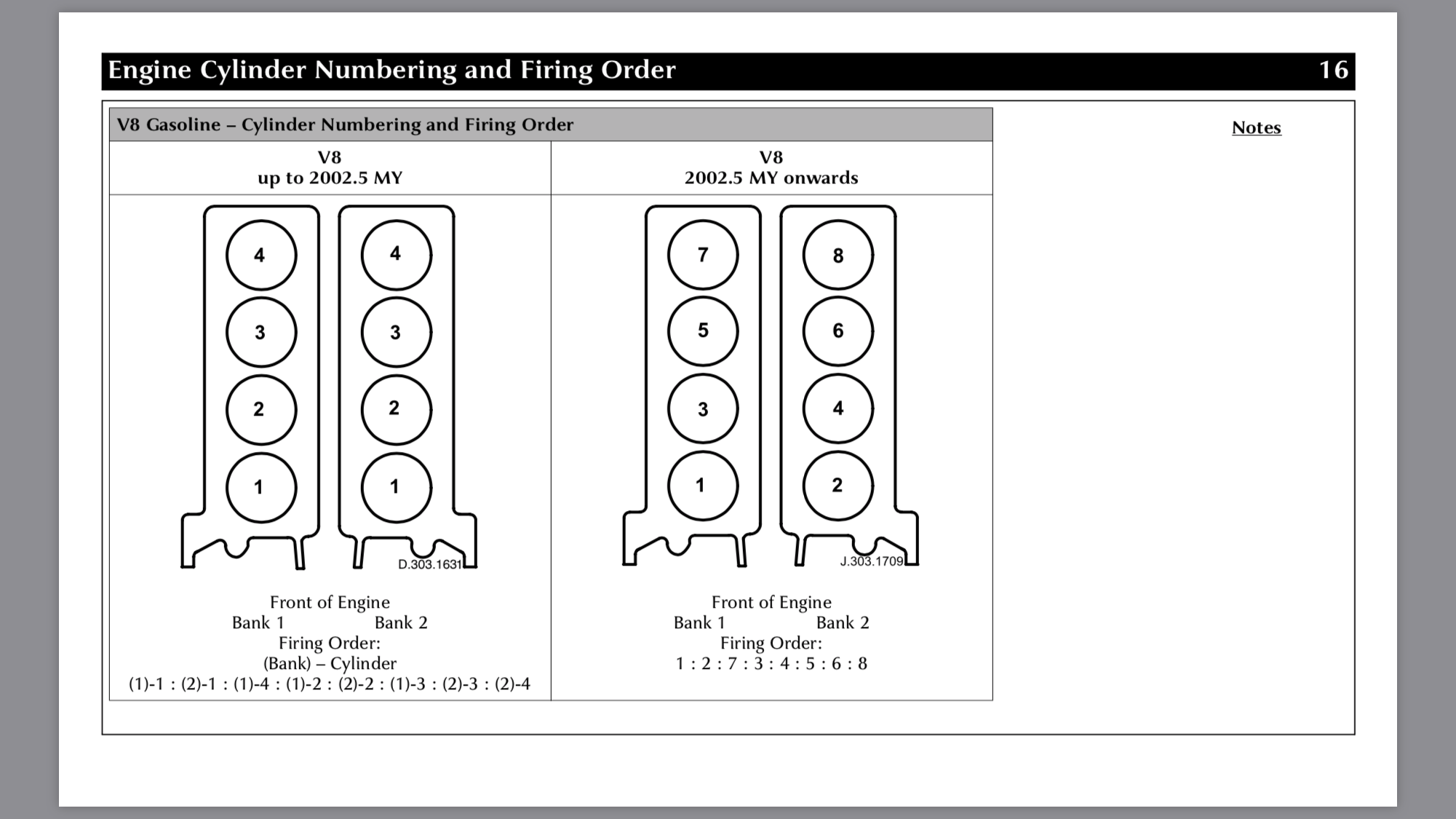

Also, for anyone else curious as to the cylinder numbering on the 4.0 versus the 4.2, here is a chart:

The later X100 changed the cylinder number system. The right bank is one thru four. The left is five back thru eight. A lot more sense. And are referred as A for right and B for left. It is interesting that the number one cylinder for all engines is the most forward cylinder.

EZ that looks to be for the early cars.
Jaguar moved to standard numbering.

If you look at this link that Motorcarman sent me in response #2 above on bottom of page 1 and top of page 2 you will see PO354 designated cylinder as A4 (aft cyl right bank) and PO355 designated cylinder as B5 (front cyl on left bank). That corresponds to exactly how I moved the coils to check if the problem followed the coil or not. And it did.
Someone else recently published a correction to that diagram shown above.

Might be of interest...
Mark B.
File Type: pdf

This matches a 2000 (pre 2003) XK8.
