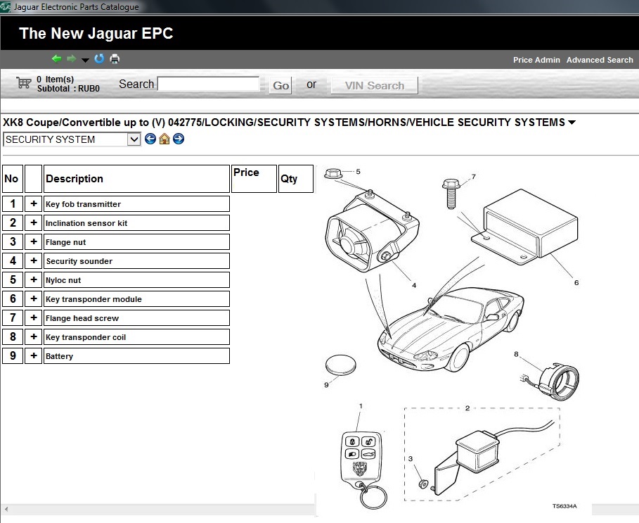

The sounder sits just behind and beneath your right headlamp. You might have to remove the right front wheel and wheel well liner to see it.

Originally Posted by The Coupe
The sounder sits just behind and beneath your right headlamp. ..........
When poking around in the darker and less accessible recesses of the XK8, it often helps to know what you are looking for!
Security Sounder is item 4 in the Parts Catalogue diagram:
