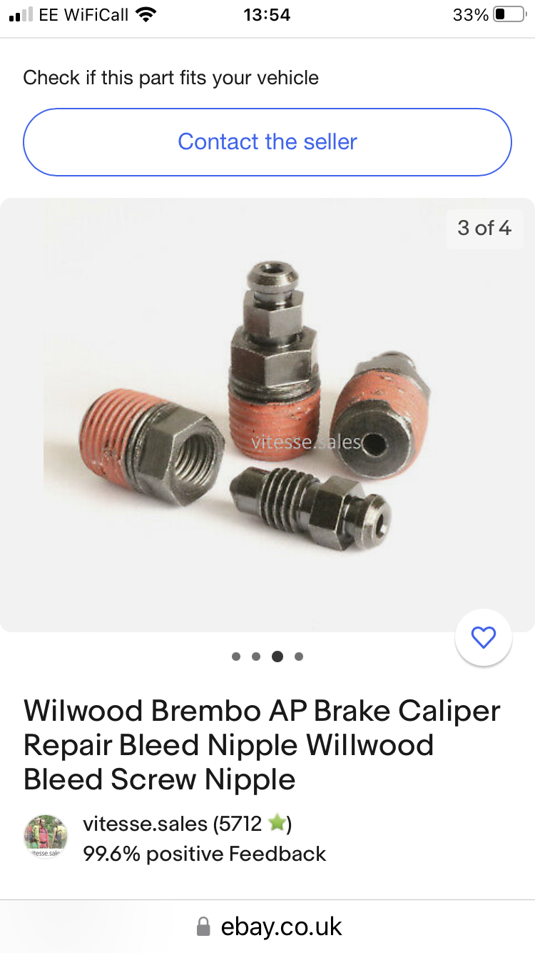

If you can’t remove the old bleed nipple, drill out and fit this. See pic.
