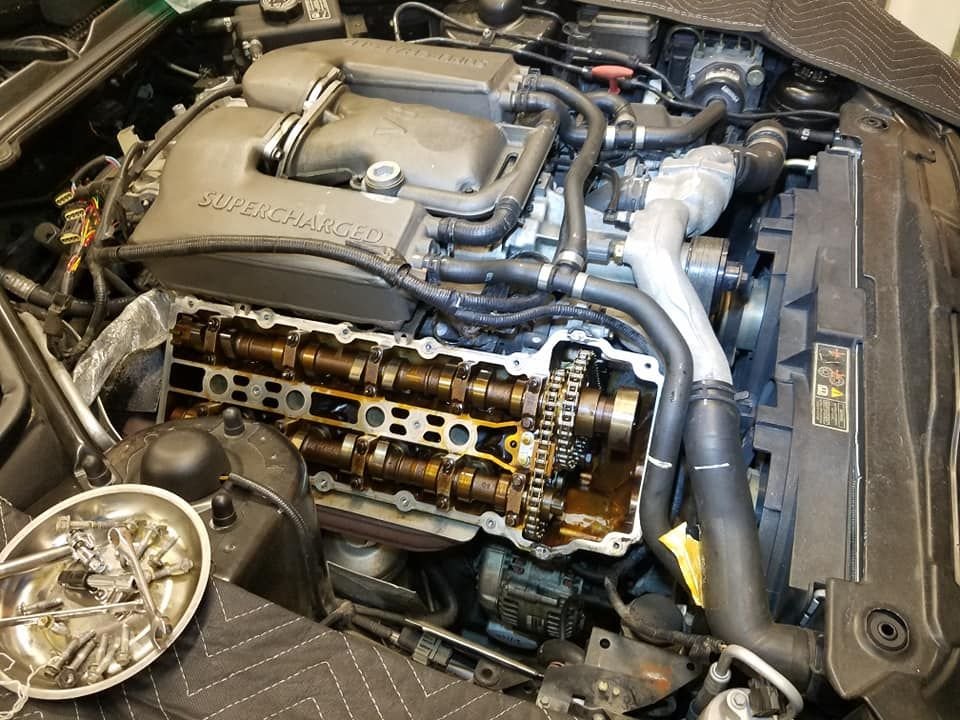

104k miles on my 2002 XKR and finally got the dreaded "chain slap". For those wondering, looks like the right bank secondary tensioner lost a shoe and the guide rail is definitely cracked:
I ordered all the parts and some new tools to do the job correctly, hoping to dig into it this weekend.
-David

Looks like you already have metal-bodied secondaries. Shoe looks OK?:
Where did the idea of making the slipper guides out of something akin to biscuits come from?
More ammunition, if any were needed, for the 'do the lot while you're in there' advisors and you will sleep better.
Good luck.

Although it's a 2002, it looks like someone replaced the secondaries but the primary tensioners and guides are the old plastic bodied ones. Replacing everything.

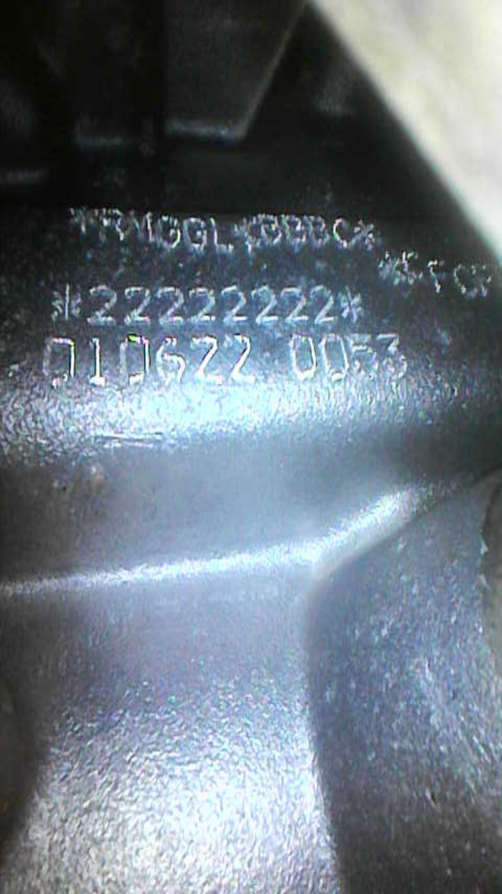

One thing I HIGHLY recommend before jumping off the deep end like I did (i.e, beginning the disassembly prior to making sure I had the correct parts), is check your engine ID number. Don't assume anything. My car's VIN is low enough to be the first week of production as a 2002 MY, and my engine was manufactured in June of 2001. I had assumed it was a later engine, but Terry's Jaguar Parts fixed me up with the correct timing kit with the right chains.
Also, I had to pick up a new WiFi Endoscope for my phone in order to see the engine ID number. There is no way (that I could find) to directly view the stamped number on the block, just above the steering rack, without one:
What a PITA location to put the Serial Number!!
