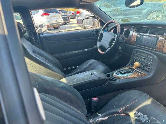

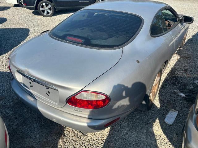

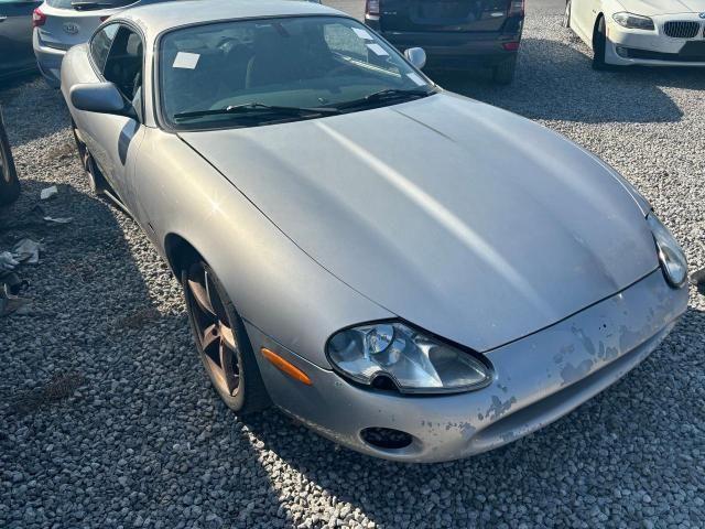

Go check it out. Check the fluids and their conditions. Look for signs of gelling, or milky froth in the coolant and oil caps. Check the dipstick. If the fluids are good. Hook-up a battery or something to jump start it with. And see if she cranks and starts. Since you have the keys, you can do what probably no one else can in that regards. The exterior repairs seem minor on the surface: headlights are misaligned, perhaps loose, one fog light is missing, growler is missing, the front bumper needs a re-paint, and the rear boot lid has a dent. The paint seems a little dull but perhaps a good detailing service can bring it back to life. Wonder what's hidden in the driver's side of the car? I notice that there's no picture showing that side. If all that's good, and no rust in any of the usual areas (rear wheel wells, the lower sill, and the floor boards), then you've got a pretty solid car.
From what we can see in this images what concerns me the most is that the windows are open and it's outdoors. That interior is exposed to the elements and who knows what may be lurking there (mold, pests...)? Potential health hazard. Also, the leather is torn and tattered. The interior may just be the most expensive part of the car to repair. Although, not the leather of the seats. Those can be easily re-upholstered, but instead, what concerns me is if any pests got into the car and chewed on any wiring, or if something died inside it. No amount of cleaning can remove the smell of death from a car.
I'd say go in, check the car, watch out for all of that, and if the issues seem surmountable, make an offer.

I don't have a big issue with mechanical or paint but that interior has got me scared....how long have the windows been down.....cat den, rats nest? Plus any interior wiring would be suspect....I had a 65 230SL I had stored in a warehouse. The landlord rented an adjacent bay to a dog food wholesaler. The rats got so bad he put poison traps out. Of course they squirmed under the seats, into the ducting under dash and engine bay to die. Not a welcome site or smell come that spring.but hey, good excuse to rip out that nav screen and replace with some gauges, put in some Recaros....go nuts.

Some of the exterior damage has me concerned but I think I have reasons for all of it. The bumper had had a cheap and cheerful respray and I suspect that when it got reinstalled, the headlights were not properly tightened down, given how fiddly it is. They had a slight jiggle after that and I only drove the car a few more weeks before it left. The trunk got damaged at the trade dealer by a mishap with one of the lot guys.
