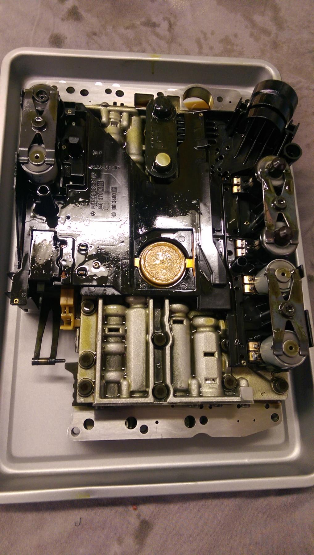

Your problem is the electrical connector coupler. Common 722.6 trans issue I just replaced mine (as well as filter and install of bluetops)
These can be sourced a number of places I sourced mine here $80
CONNECTOR-, N-LINE - Terrys Jaguar Parts - JLM21109
Here's a good link if you diy
Mercedes-Benz 722.6 Transmission FAQ - Mercedes-Benz Forum
Here's a link for a video on how to do the work
https://www.youtube.com/watch?v=OQPN...ature=youtu.be
Attached Thumbnails Spark Plug Confusion XKR-2015-02-23-12.50.45.jpg   Spark Plug Confusion XKR-2015-02-23-12.31.01.jpg

This is looking like a pretty big job for me Im thinking. Everything shifts just fine and nothing a miss there. Just that I have fluid leaking from the pan area. Replacing an electrical item is needed as well?
The book claims its a GKN 14HU Transmission.
There is a European AutoWerkes shop in Toledo OHIO Im considering @85 bucks an hour and for just changing fluid, filter and gasket cant cost too much I'm hoping? Should be a couple hour job Im thinking?
Sometimes its best to admit if the project is over my head.

The more I am reading it sure does sound like that 13 pin connector.
Either way, its get a new pan gasket and change.
ONLINE INFO
What Are The Common Fluid Leaks Of The 722.6 Transmission?
The two most common fluid leaks from this transmission are the 13-pin electric connector/spacer (pilot Bushing) and the shifter mechanism bellow. Between the two, 99% of the leaks are from the 13-pin connector.
I hope this repair wont cost me a ton of dollars !!??
