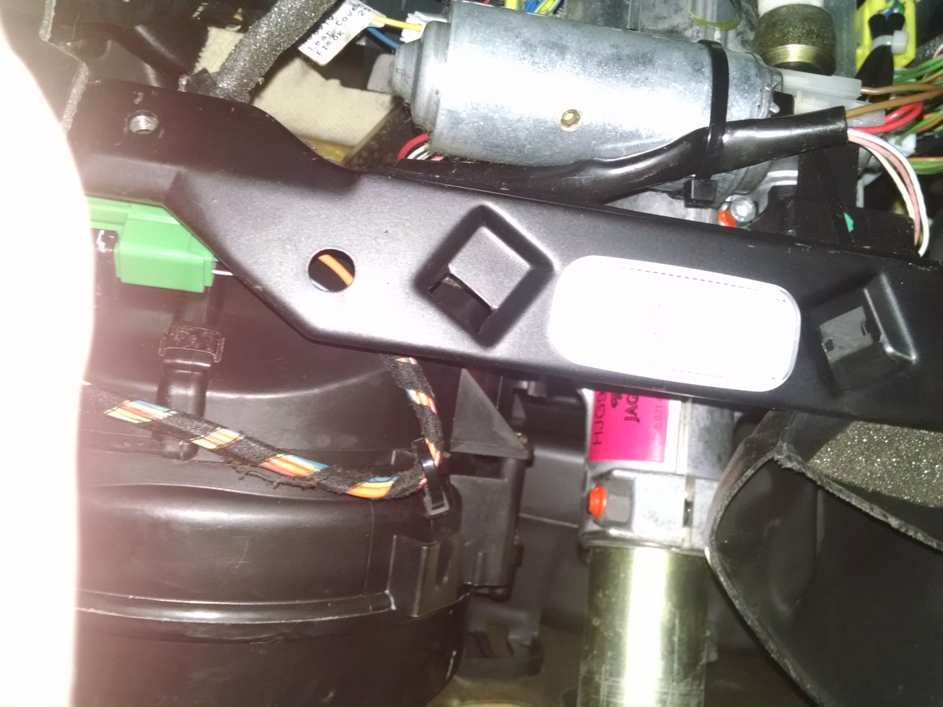

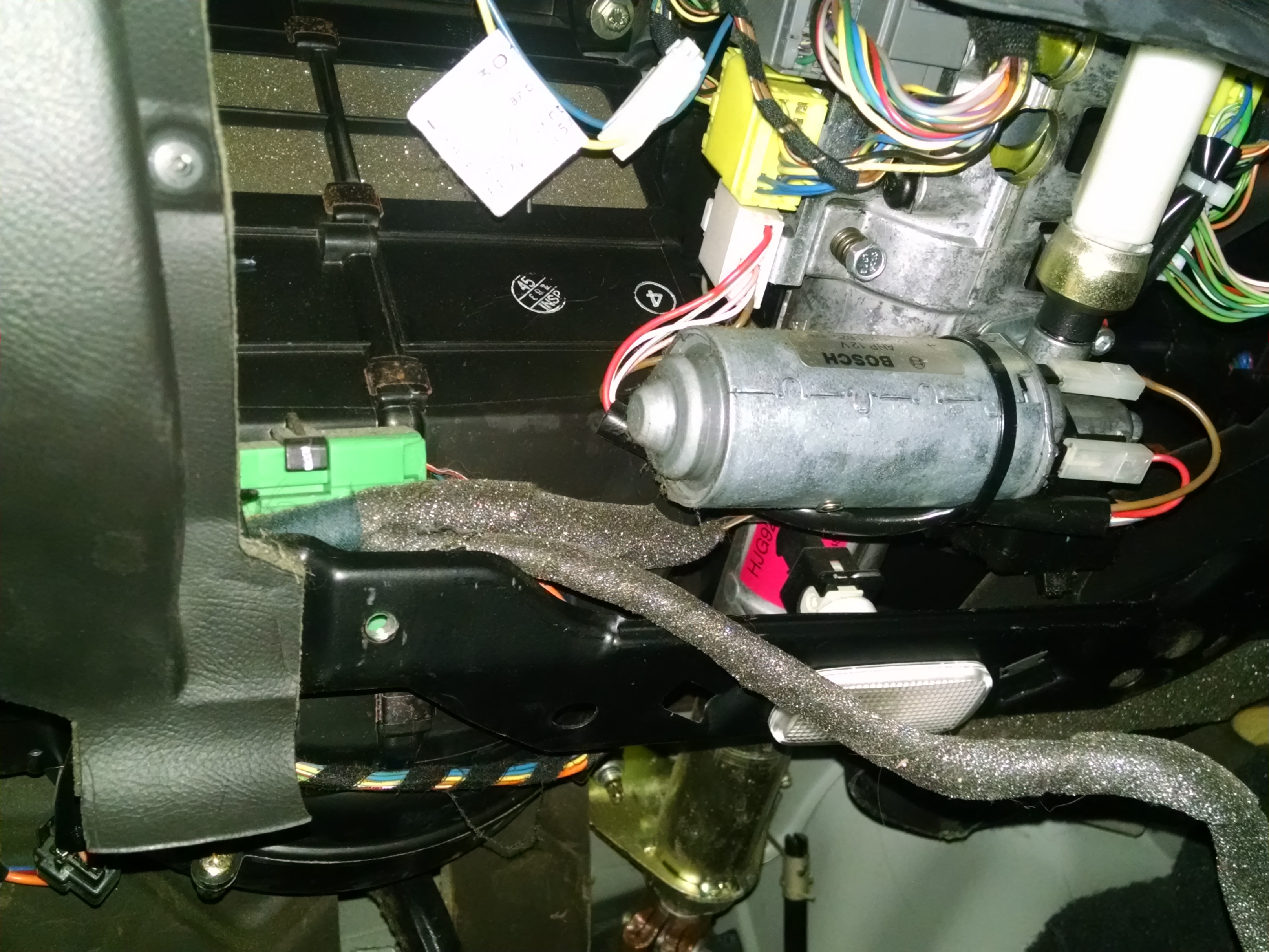

4. Now here comes the surprise. Nowhere in any of the instructions is there mention of a metal cross bar going across the footwell with a courtesy light in it (see photos). The bar isn’t going anywhere and you can’t lower the steering column with the light fixture installed. The fixture has those common curved spring clips that allow you just wriggle a fixture out, but they’re only on one side; the other side has a fixed lip. You must identify the side with the clips and pry that side down first. The connector is one of those with the metal wire spring running around it. It’s easier to release with the fixture out, but it still takes a little fiddling. You know the drill: pull the clip off, unplug, replace the clip.
5. The cross bar could also get fouled with the tilt motor, so take that off too. You’ll use a 4mm Allen wrench with some kind of leverage extension to break them loose – the bolts are in with Loctite.

15. You should now be able to lower the column enough to access the reach motor, but again the manual is wrong. The cross bar will not allow the column to drop down low enough.

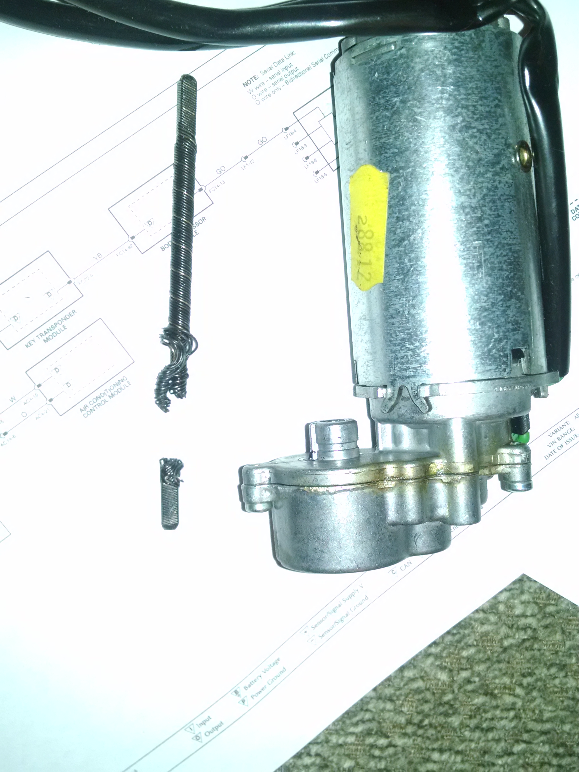

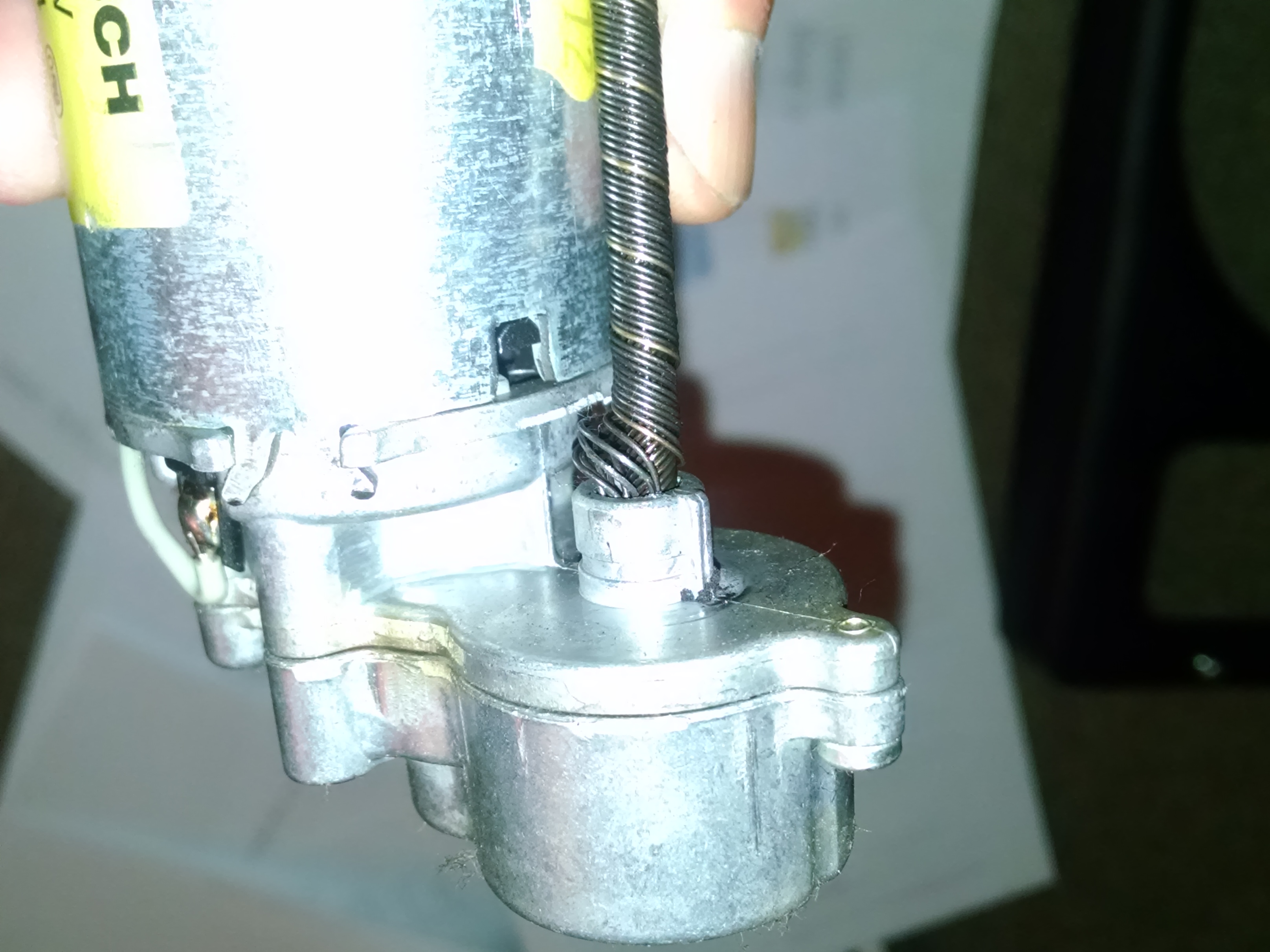

17. The reach motor is only held in place by a tie-wrap. Make note of how the tie wrap is routed and cut it.
18. You’ll need to rotate and wiggle it a bit to get it out of its holder. The photos show why the function stopped on mine. The motor itself works fine, so if anyone needs one, PM me.

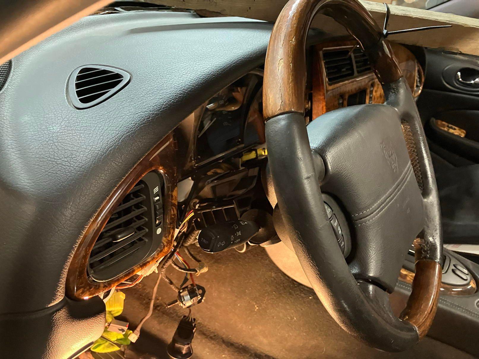

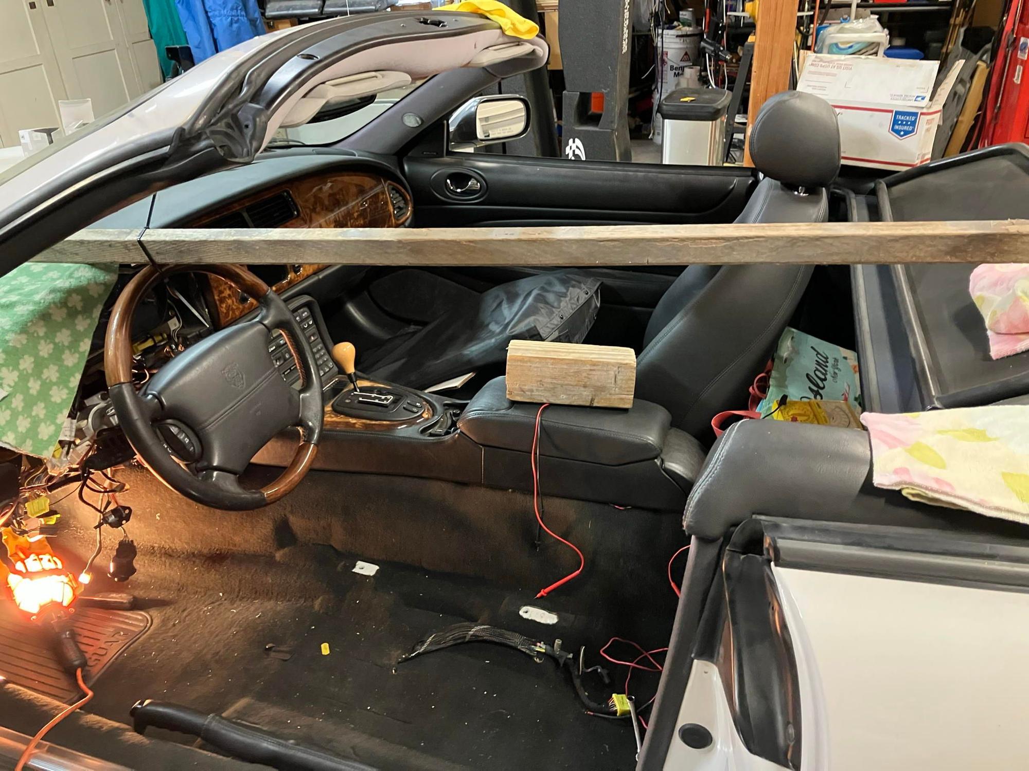

I removed the steering wheel without going under the car, dropping the lower arm and lifting the front and out. 2001 xk8. Getting it back in is hellish.
And I think the only one row of splines was engaged.

After spending several hours yesterday with my wife helping to support the steering wheel, I finally figured out, you need to support the steering wheel at just the right position while you push the splined end into the swivel joint, then get the upper retaining bolts into their holes, then you will find that you are very close to getting the lower retaining bracket in place. then I used a pursuader to move it the 1/8 inch more to seat the bracket onto its studs
