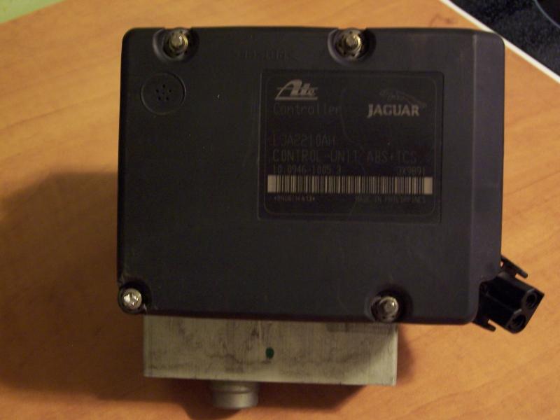

I am removing the ABS control module to check the solder joints. One star bolt has the head striped. of course it is the lower one closest to the front of the car. It is a 4 mm star bolt. If I can get it cracked, I think I can remove it by hand.
Any suggestions on getting it out?
Thanks

I'm thinking it should be a torx 20 or so... If you have a hex socket that you don't mind tossing, you could tap the next size up into the torx bolt... Get it seated and solid... turn slowly without moving it around while pushing down on the bolt... It should break free...

Originally Posted by bluexk8ragtop
Good day,
Good luck and let us know...
Cheers!!
I'll give it a try tomorrow. I've pulled the entire hydraulic control unit out so I can work on a bench. Pic is attached.
This won't work. It is a Star bolt, not a torx.

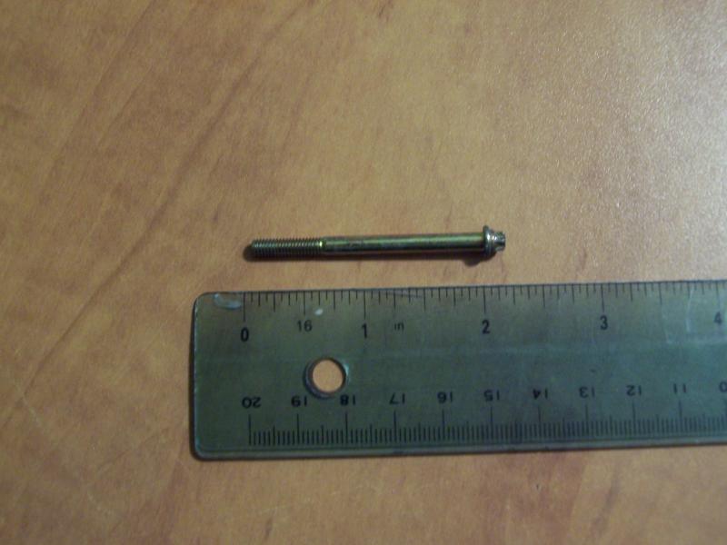

I probably have 20 or 30 extra bolts if you need one.
bob gauff
Thanks Bob. I will need one .PM me with particulars.

Originally Posted by Terro
If all else fails, carefully grind the head off with a dremel tool and with module removed then use vise grips to remove remaining stud. It's a little more work but you are not in a hopeless situation by any means.
Looks like this is the only way to go now.
